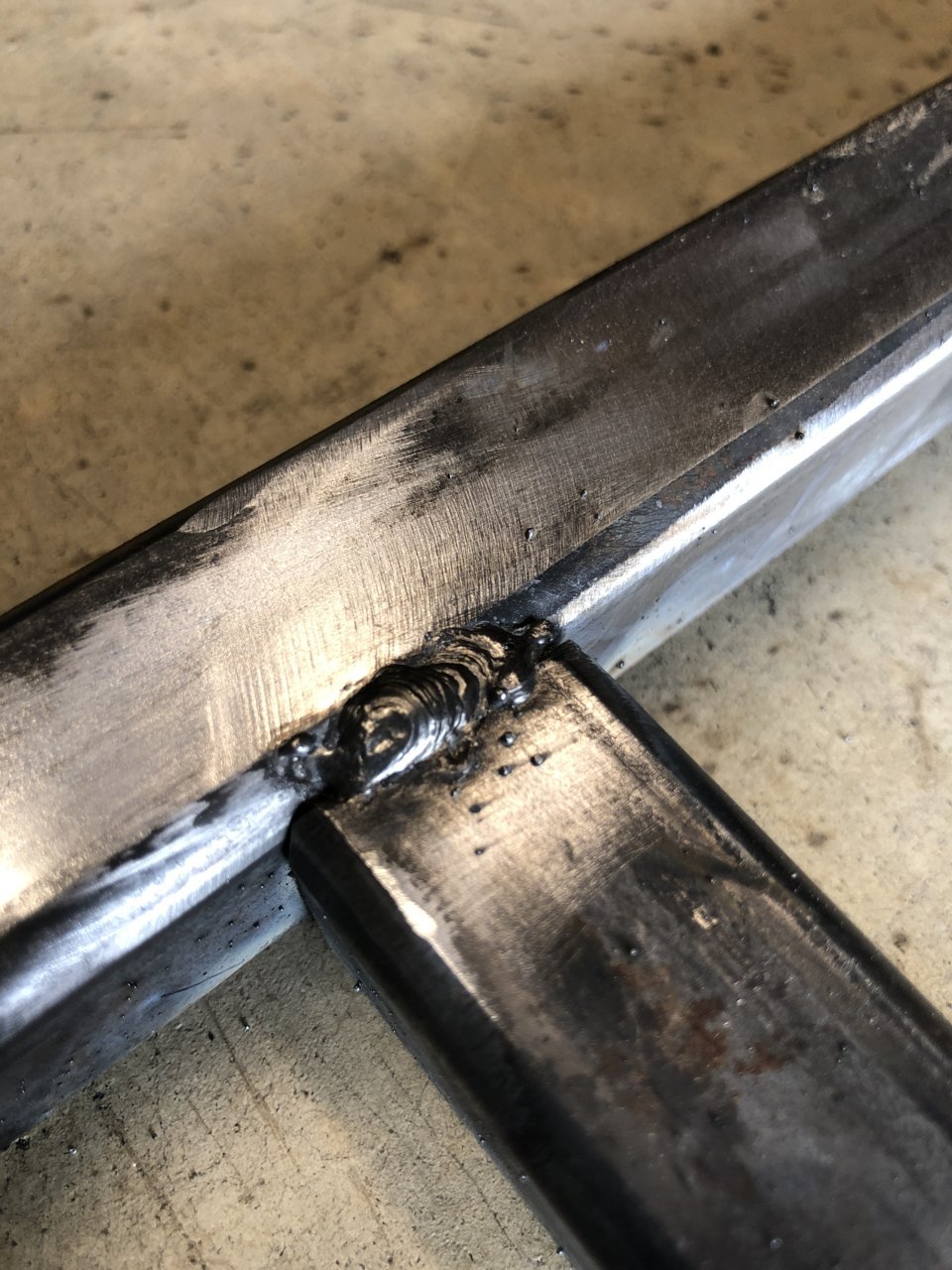

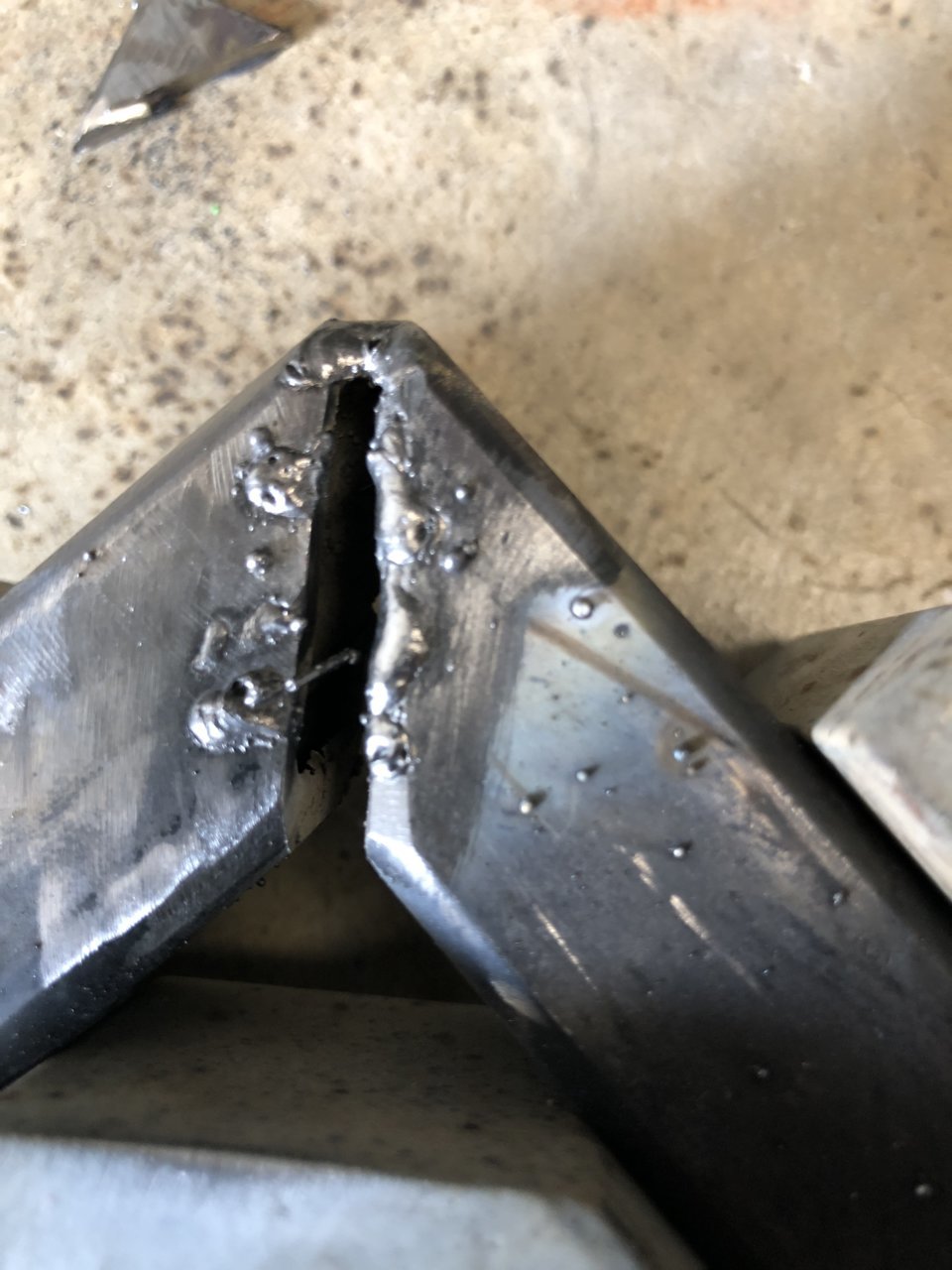

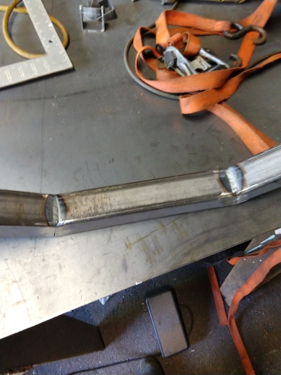

    This is too big of a gap to fill :(

    I've done it plenty with the help of 16 penny nail.

    I used a piece that i cut off to fill in, and i will cut it off after im done

    Turn the heat down a little, and work the puddle back and forth around the end in a U shape. You can absolutely close that up with just weld.

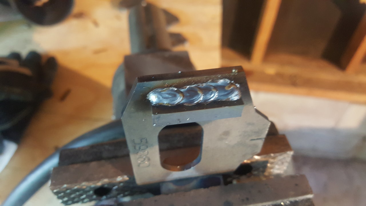

    Just what process are we using Here ??
    Stick welding run stringer beads on both sides to you can close the gap keeping close watch it does not get to hot
    Then it depends just what that piece is going to do .
    Mig welding I would pretty much use the same style

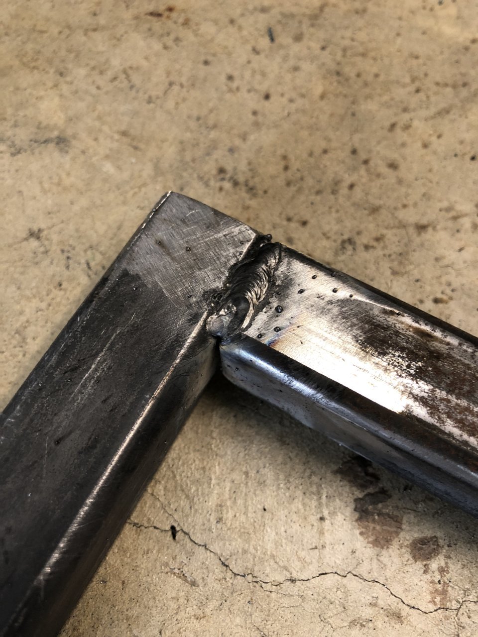

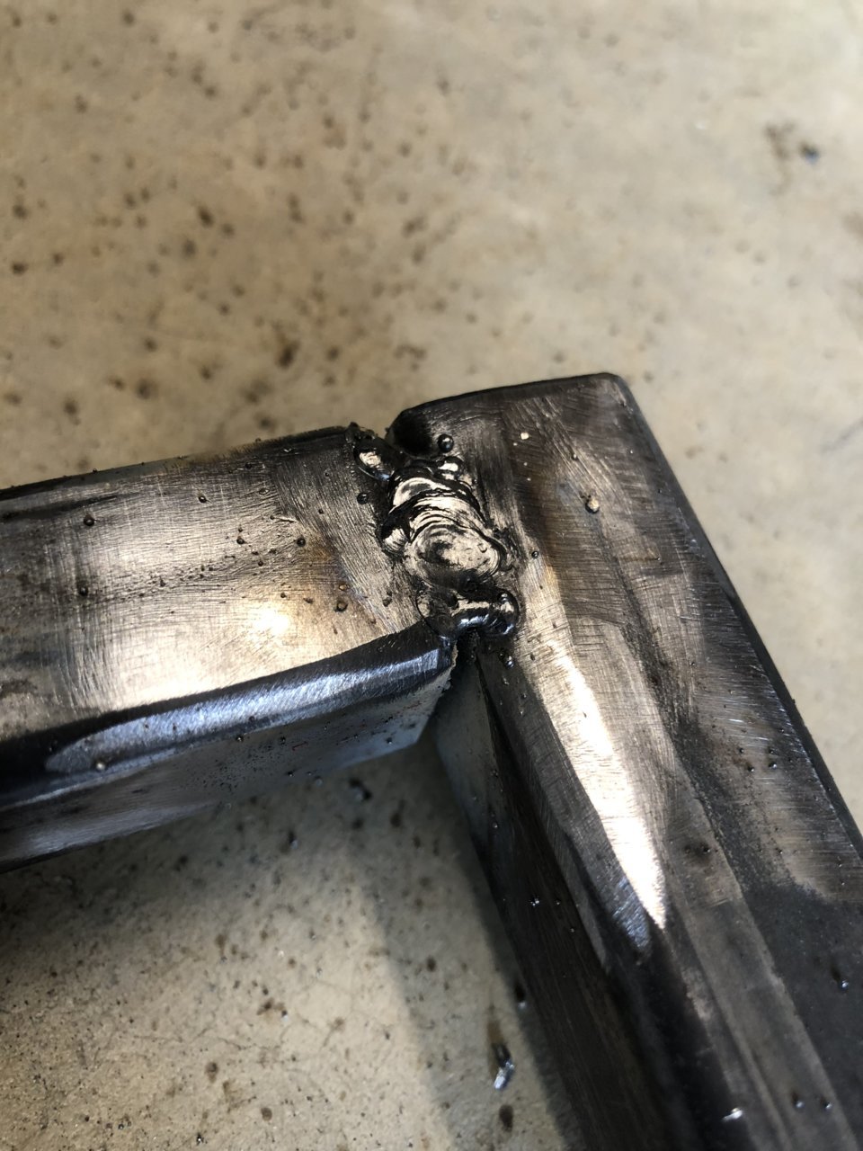

    Will try turning the heat down @Arcticelf. But for now Ive moved to the next corner. Decided not to mitre. This is just a tack for now. Need to do the other sides.

    Turned down heat, slowed movements. Better results

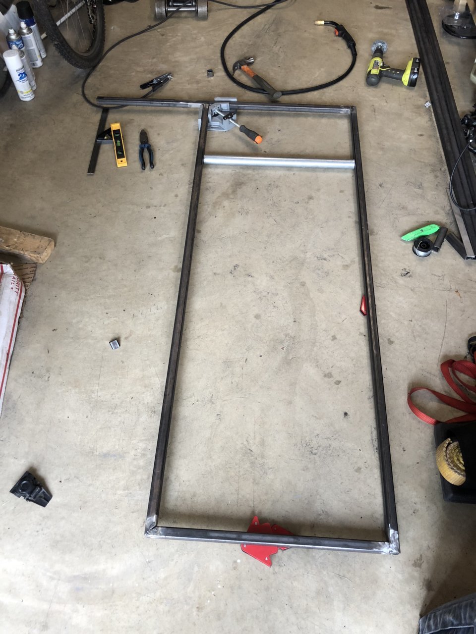

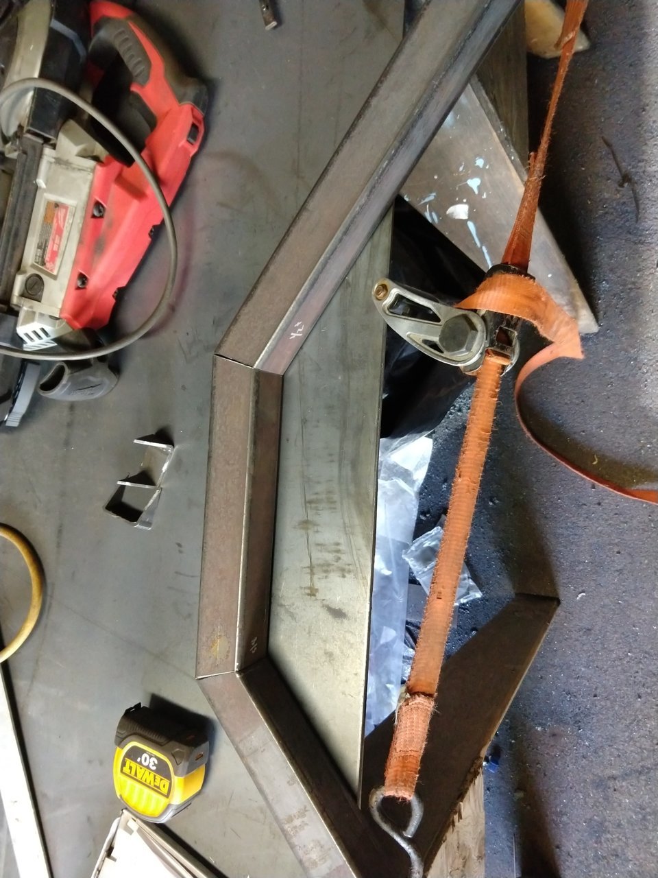

    Building the framework for a bed drawer

    Haha. Thats the plan next. I just wanted to show you guys, so you can help me improve. I will be grinding though.

    Mitered corners
    A fixture.

    @fatfurious2 notice the heat markings on mine, you want to see that to indicate you're getting good penatration.

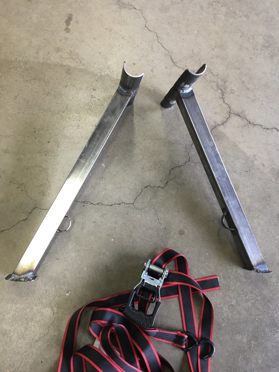

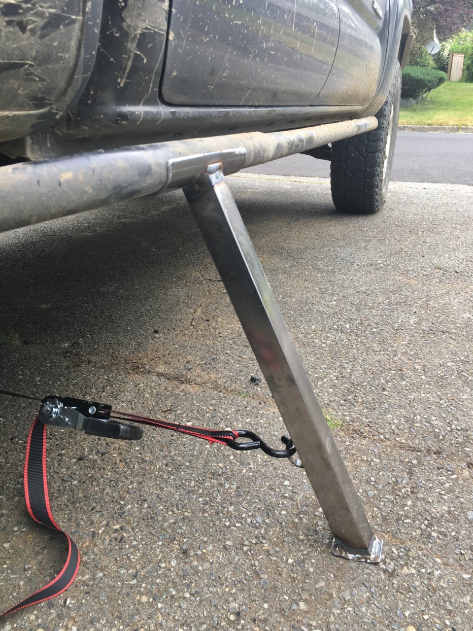

    Quick and dirty attempt at some stabilizer legs for camping ... probably need to enlarge the foot to work in the dirt but I’m thinking this might work.
    In other news, hot metal is really hot. Kinda surprised I made it this long before burning myself...

    Nice idea.
