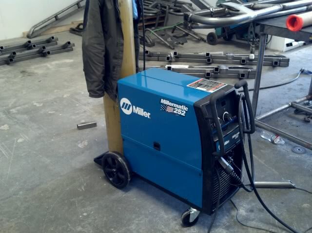

    Sweet. I have 2 years experience running the 252 machine. The only downfall I found was welding vertical down with .045 wire on 1/4" plate. Just too much wire not enough heat/penetration. But if all you run is .035, its an awesome machine. Experienced 0 failures that weren't caused by the user. Good luck with the new toy!

    Good to know I usually run .035 anyway :D
