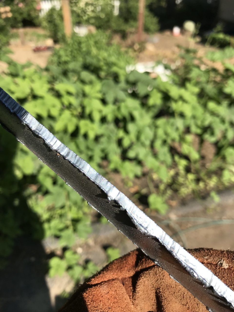

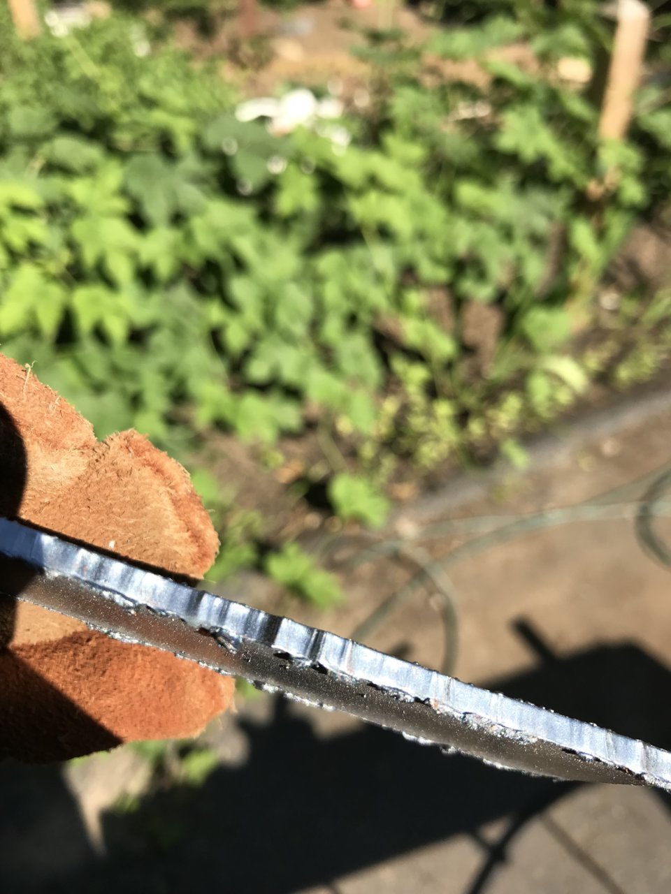

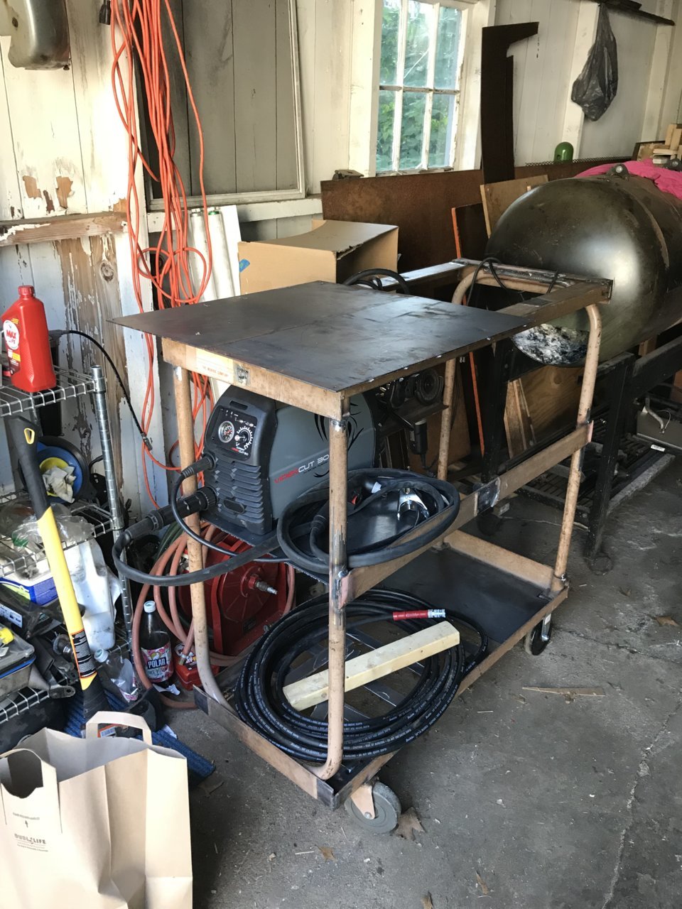

    Well I squeezed out a bit more on the metalwork cart. Got the wheels burned on, a shelf cut, and some free hand cut ‘flat stock’ to use as crossmembers for othe shelves.
    You probably can’t see too much of a difference from the last photo, but it rolls!
    I’m already loving my cheap *** self for buying non-locking castors....
    The tank will go in the ‘back’
    Any ideas on what to use for hooks / to hang leads and cords? I was going to just cut some more strips and bend them, but I wouldn’t mind spending a few bucks on some hooks for convenience.
    Also, I have been getting a lot of dross on the cuts. I read that means I’m cutting too slow, or the amperage is too high. Any other thoughts?

    That dross is pretty normal. I seat it off by hitting it with the hammer on the back side. Pops right off clean. No grinding needed.

    I would not call that excessive dross. Just like with welding, cutting amperage and cutting speed go hand in hand. With practice you will learn to adjust your cutting speed to how the material is cutting. You will be able to "hear" how the cut is going.

    Get some time with that machine to get used to it.
    One other thing you never want to do go cheap on Casters that leads to no end of frustration

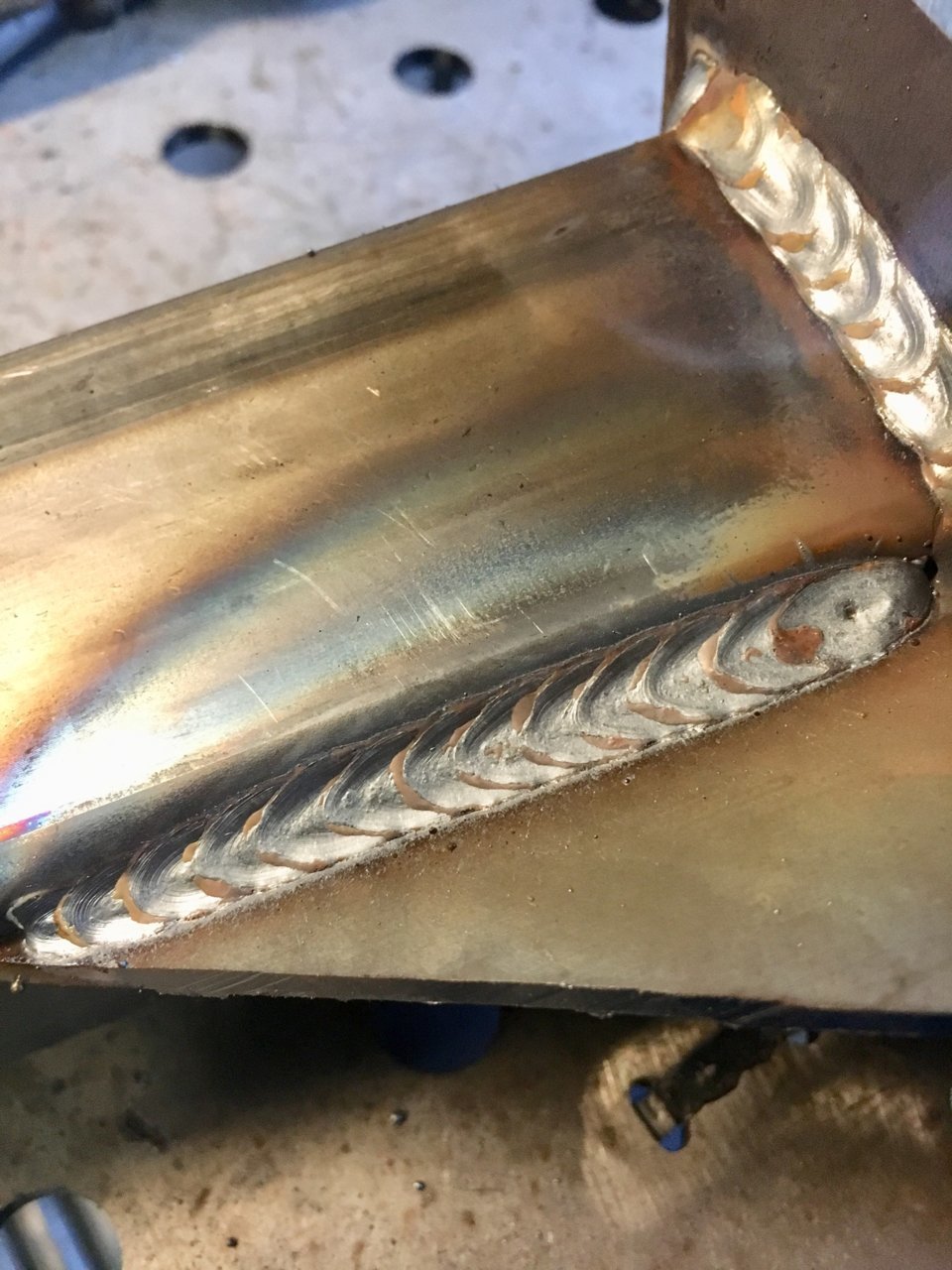

    I like dees one I deed tonight :D

    Haha thanks buddy. I get excited when my welds come out like this one

    Your saying you only make good welds by accident ??

    What pattern were you using for that one?

    Hahaha I’m just saying that I thought that one was extra pretty
    That was a smaller part that I was welding up so I like to turn the part so the joint is vertical cuz I fee like my welds come out nicer when I weld vertically. So it was just a down, up, down, up, down kind of a pattern

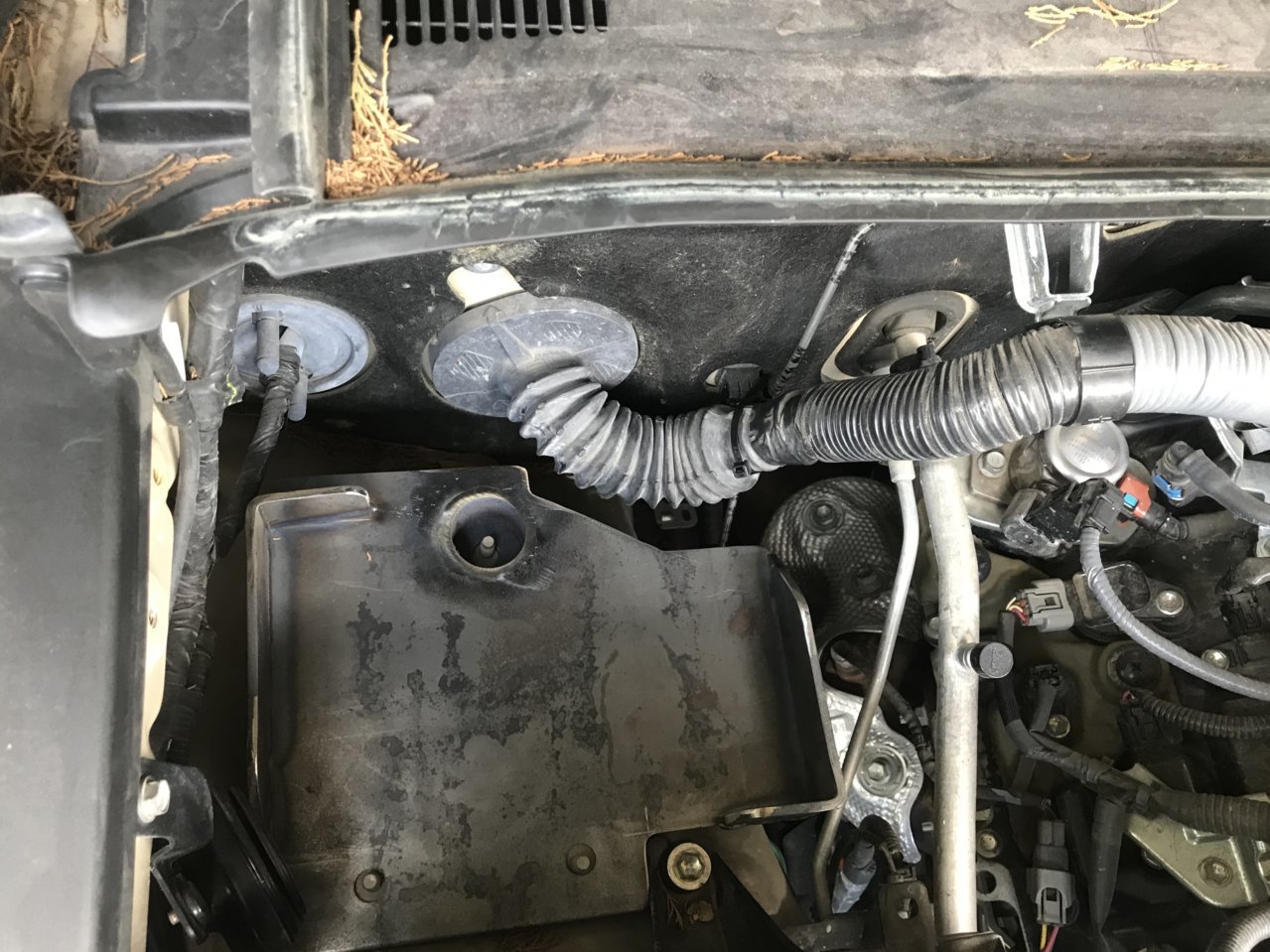

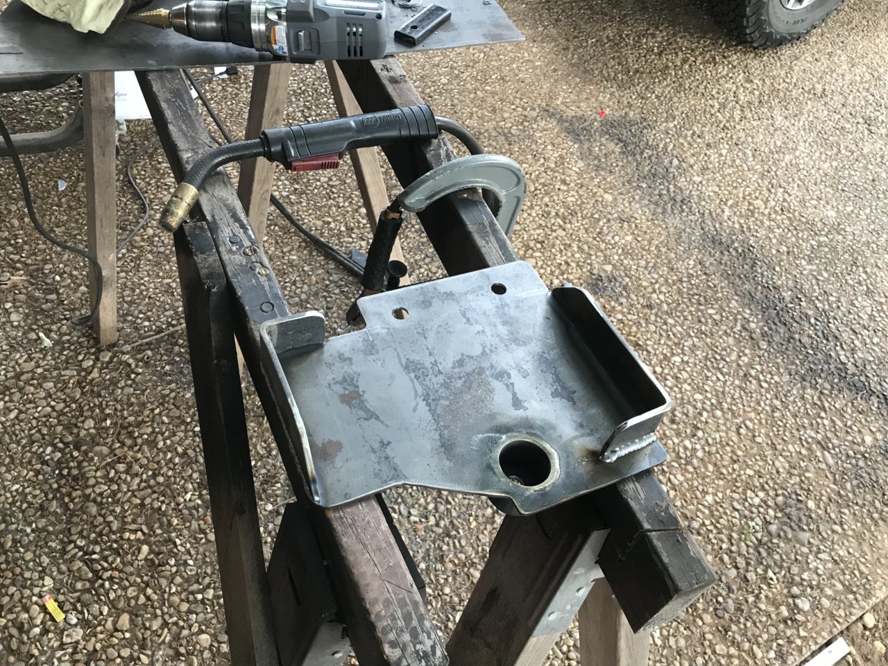

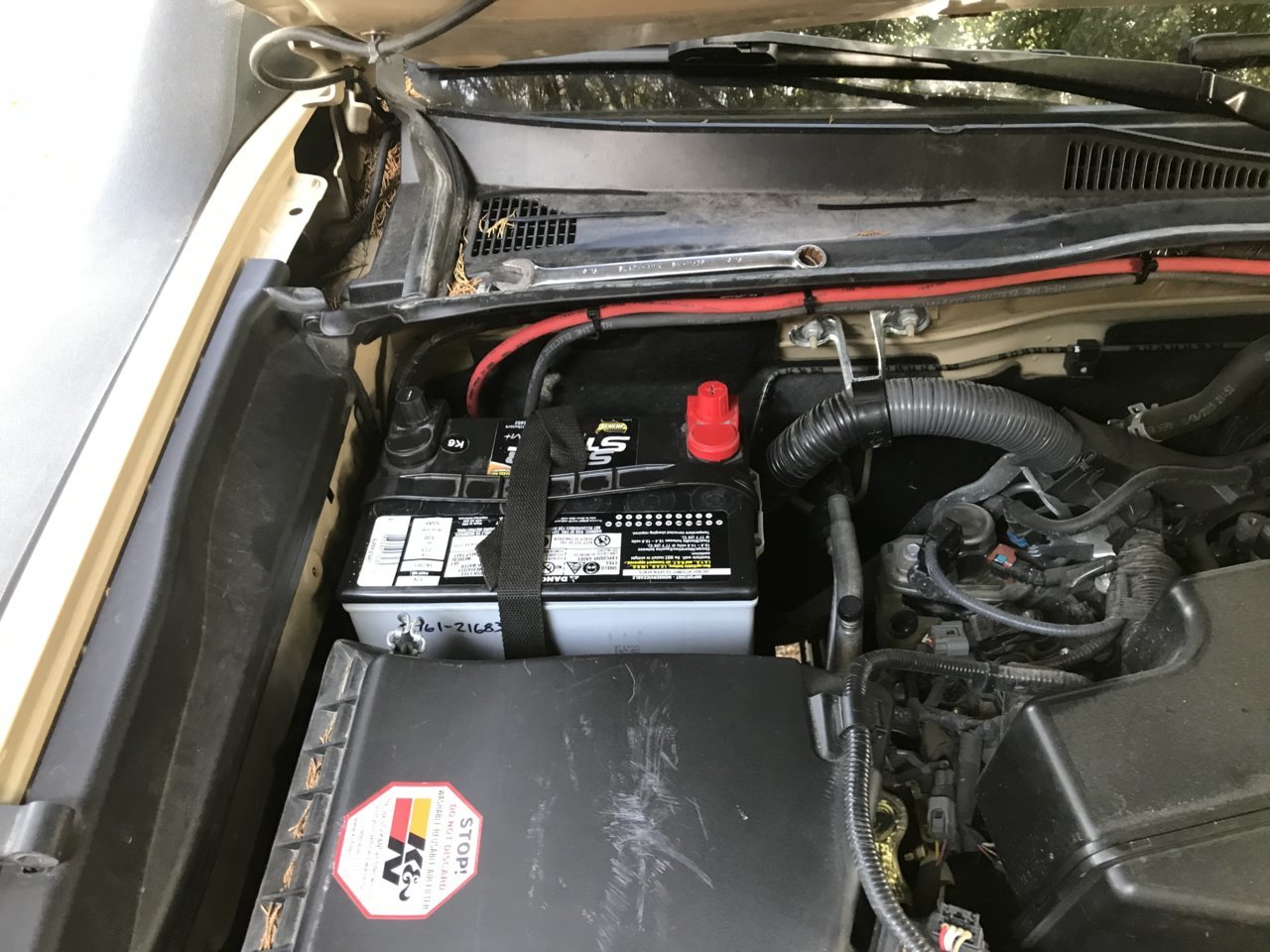

    Put together my auxiliary battery tray today. It isn’t all high speed, low drag but it holds a group 34 battery just fine.7F9F1942-0ABD-4831-863A-BDF16878AB15.jpg
