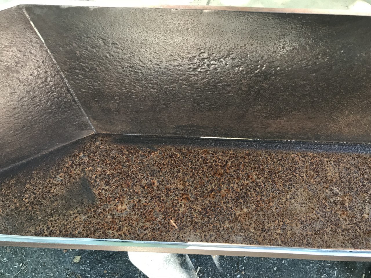

    Is that Hot Rolled 1018? If so It is what it is but looks good man. Hot Rolled comes all dimpled Cold Rold will have a nice finish.

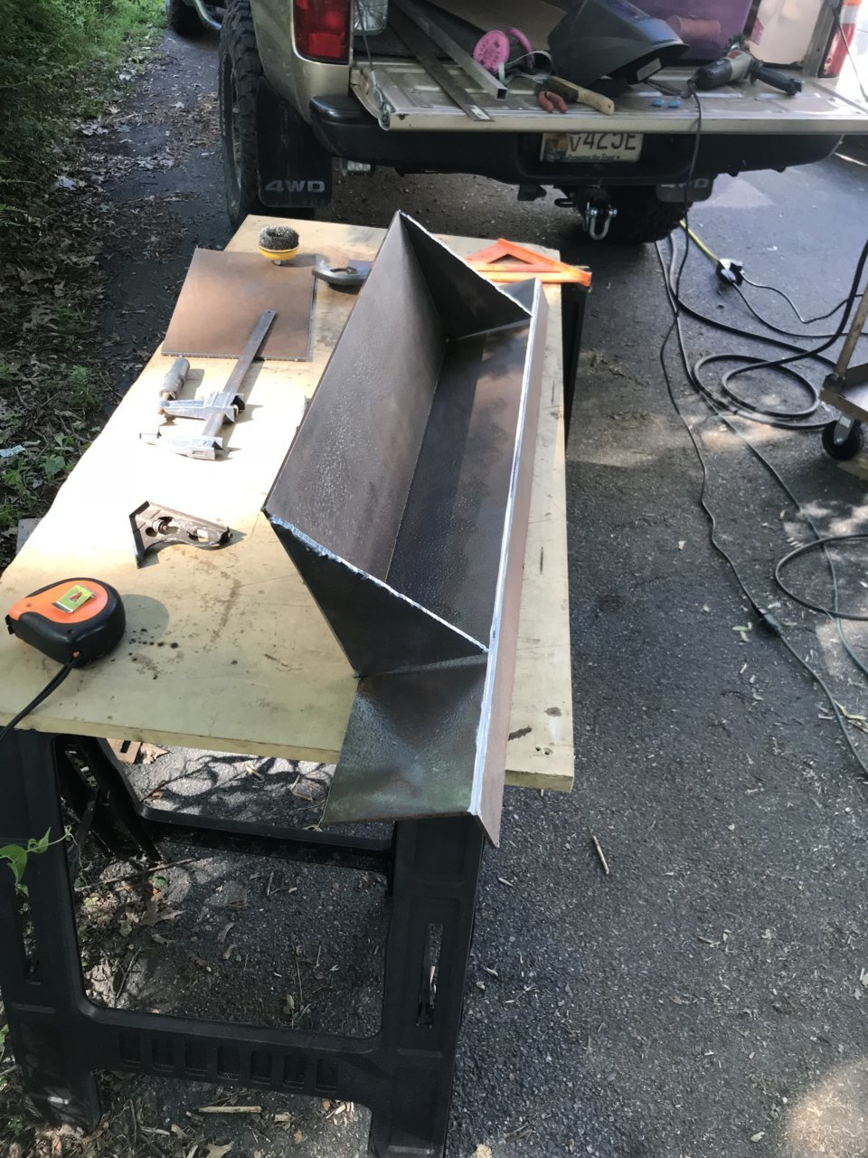

    Placed an order for a Hobart Handler 140, hoping it'll do what I'm looking for - I'm limited to a 110v outlet for the foreseeable future, unfortunately. Looking at 3/16s frame plates as my thickest project, everything else will be furniture and the like.

    Congrats on ordering the welder! 3/16 for plates for cmc’s it may be ok but I,personally, wouldn’t trust it to be hot enough for welding sliders on. I’m sure some have and I’ll not dispute their results but it just doesn’t offer enough pens ration for me. If you have the availability to run a 220 line a 190 isn’t much more and works great with no problem turned ng it down for thinner stuff

    Congrats! The HH140 is a very capable welder, you didn't speak of your skill level or any welding training. I'll make the assumption that your a beginner, everyone starts at that place. First check to see if there are any welding classes available; evening at the high school, community college, or maybe someone you know. Be careful of those as they might just teach you their bad habits. I have the HH140 also, it runs 0.030 flux core really well (it might run 0.023 flux core better but that size just doesn't exist). Flux core because it runs hotter with better penetration. The best welds come by using the best methods which methods including: an understanding of what it takes a solid weld, cleaning all containments from the weld area, including rust, millscale, paint, grease & oil. Not doing the cleaning means that that some of the arc energy is lost to burning that stuff, also the solids and gases will combine with the weld melt and tend to make it weaker. Thicker metal (3/16) can successfully welded with the 140 by doing the proper prep and preheating the weld area to 300-400 degrees.
    Your first welding project should many hours of practice with inspecting and testing of your practice coupons. See Welding Tips & Tricks web site, Jody has lots of good videos for you to watch, quite a few are for the 140 class of welder. Also some of cutting, polishing and etching welds.

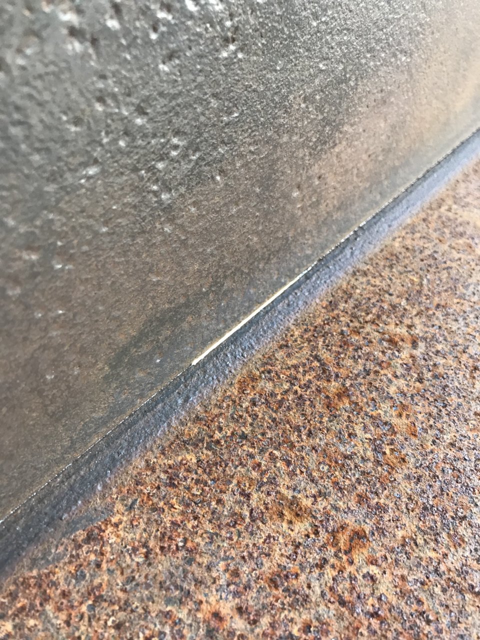

    Start out with the flux core, adjusting the settings to minimizing the spatter is a great tool to have on your belt. The welds look nice but I believe it's a little cold. Photo is to dark to see what is going on a the edges of the weld, some of the edges look OK but not the whole length. Grinding the mill scale would help with the seeing.

    The class I took was just a 4 hour deal and the instructor was pretty busy with a couple people who just couldn't get it, so I didn't get much feedback - thanks! What should I look for to tell if it's cold? By edges I assume you mean the edge of the bead?

    It is some old rusty plate I bought off Craigslist :(

    So, what. As long as you got it at a decent price, you are ahead of the game.
