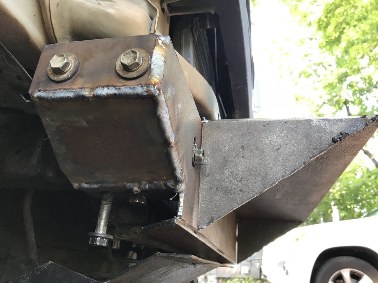

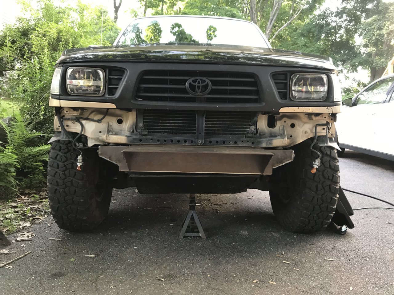

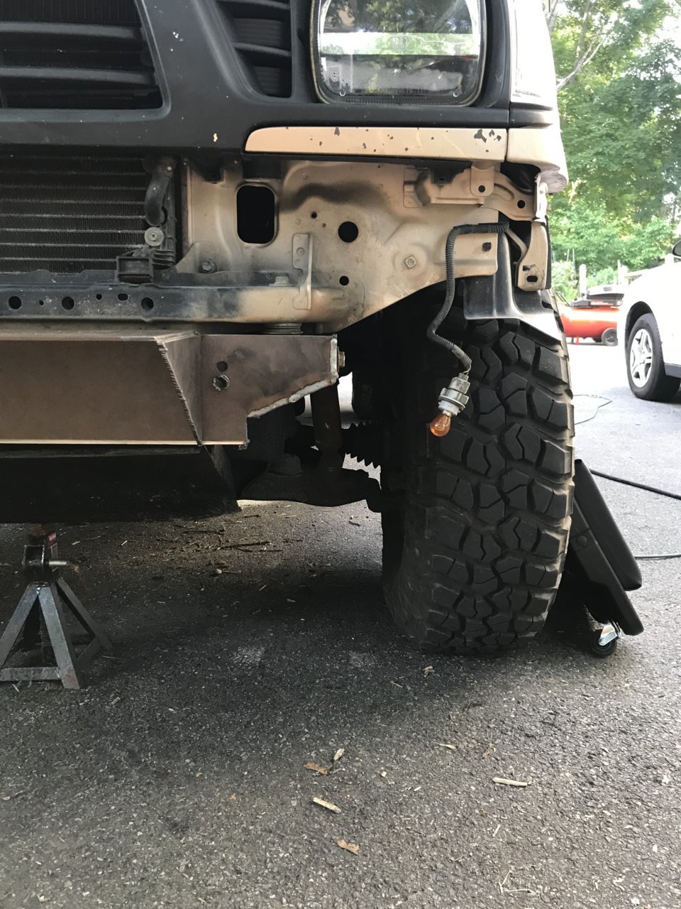

    It’ll be bolted with 2 in the front, 4 from the sides, and 4 from the bottom.
    I remember people talking about leaving enough of a gap for body flex when I was welding my sliders...

    I built both my front bumpers out of plate. I notice some odd sounds now and again. I'm sure it's from frame flex, but the bumpers prevent it.
    *Thunks.

    1/8-1/4” is plenty of gap, at 1/8” you’ll probably have occasional thumps.

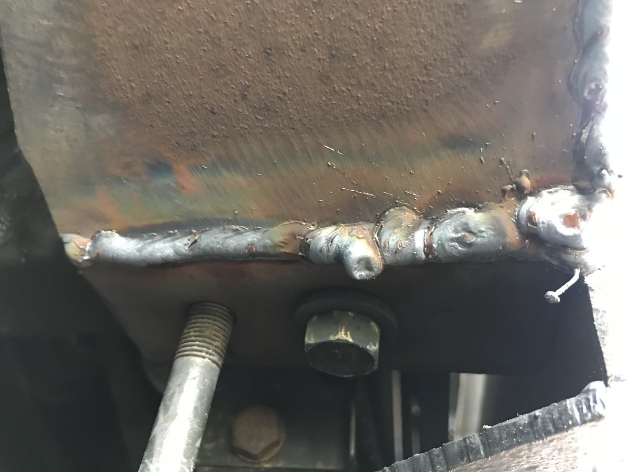

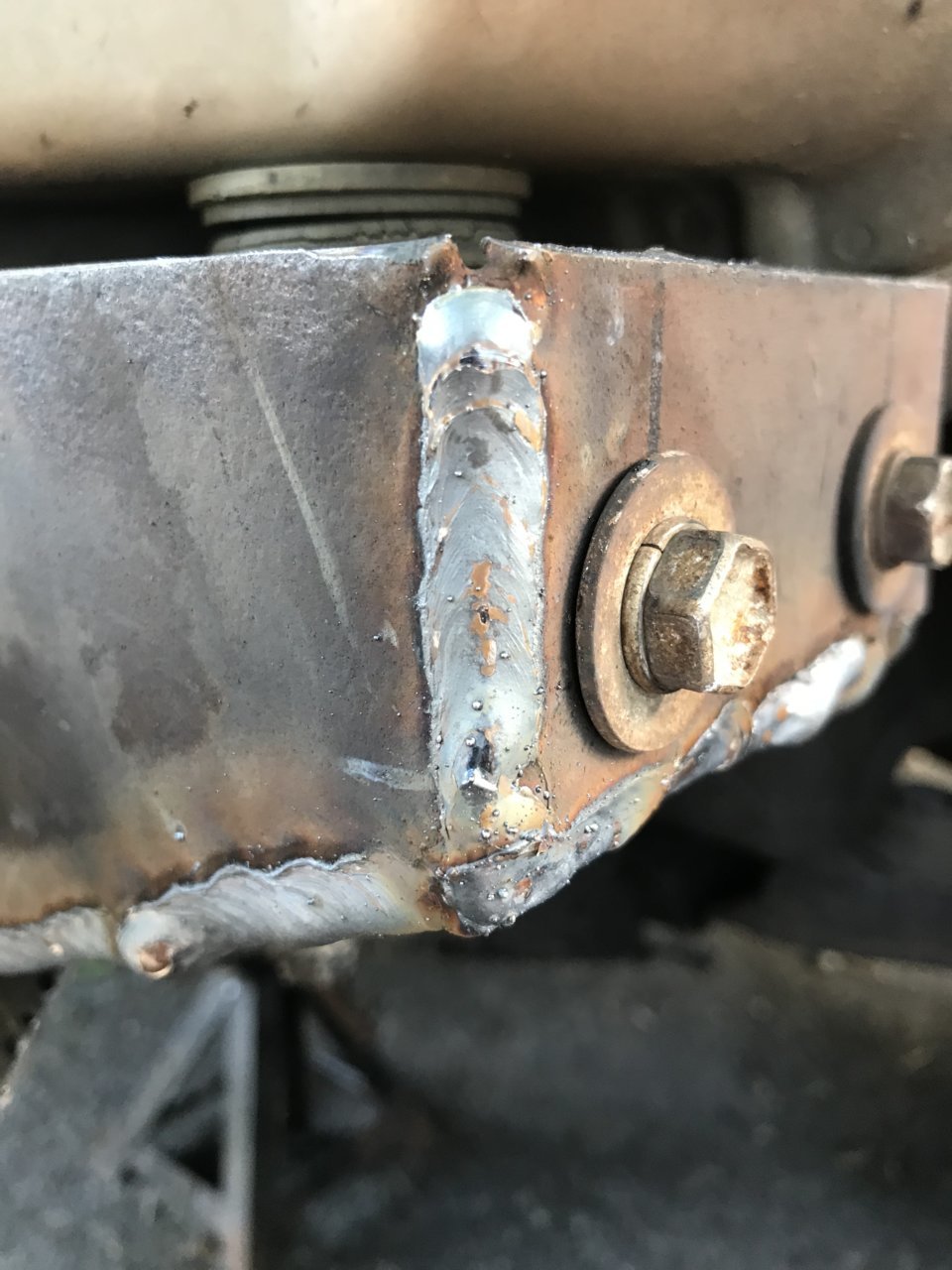

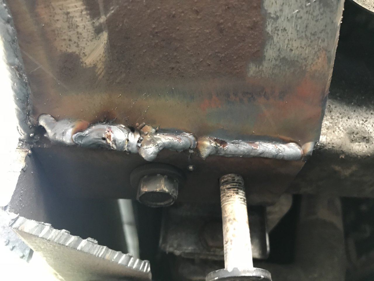

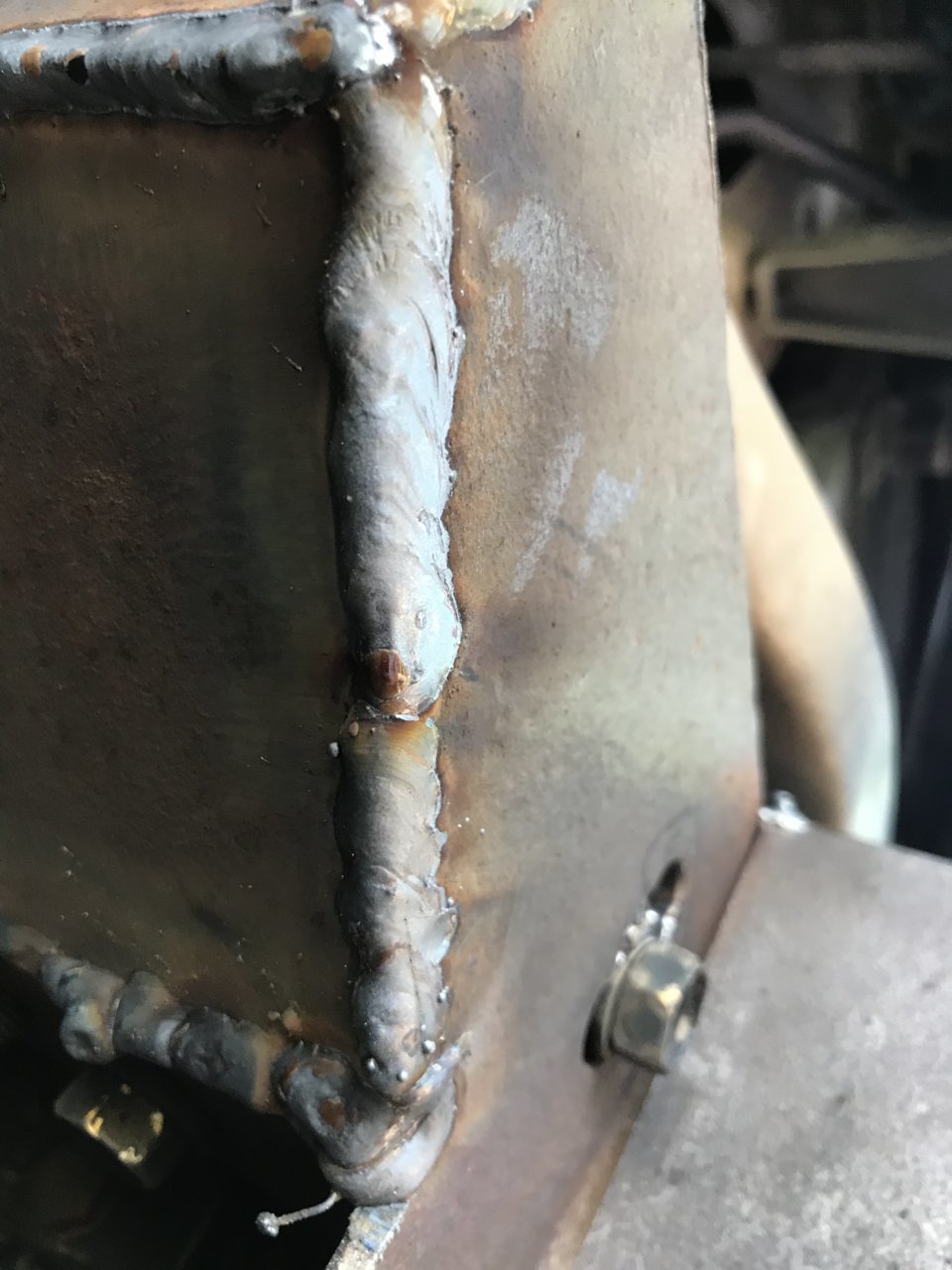

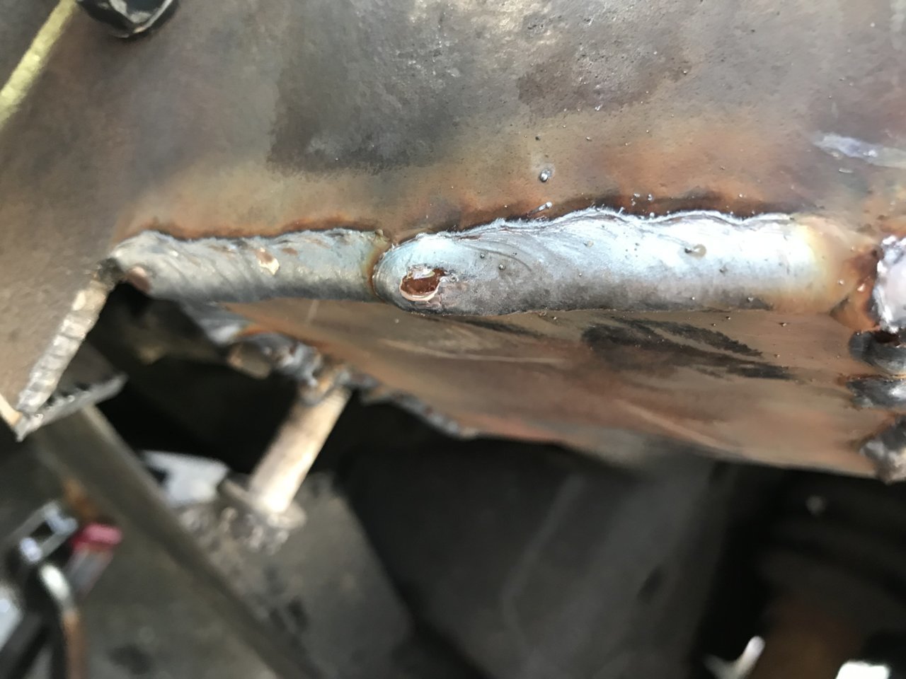

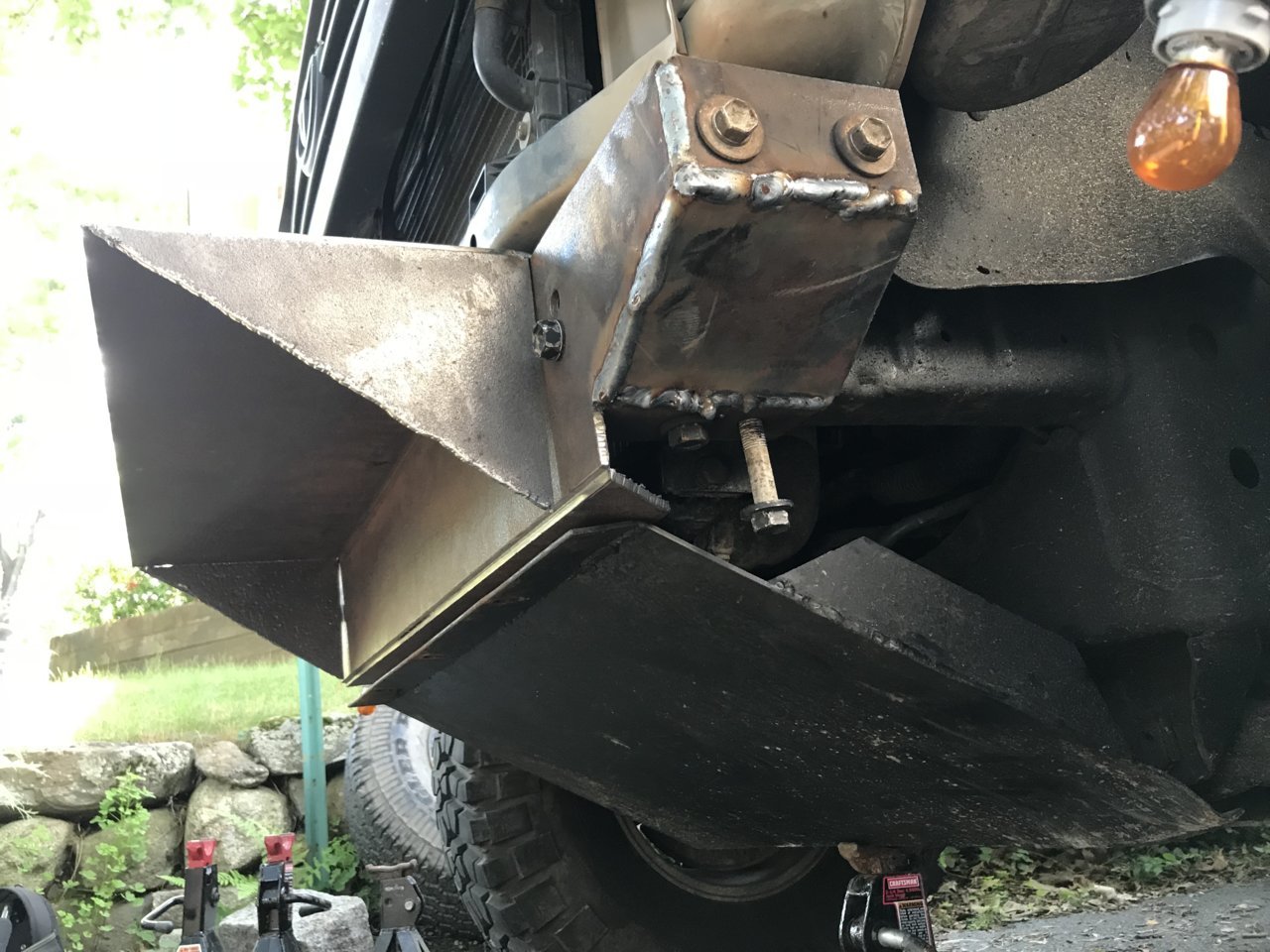

    Made some progress today. Got all the bolt holes drilled into their ‘brackets’ and burned them onto the main plate.
    I wanted to weld everything while it was on the truck so my already haphazard bolt holes would still align after I warp the sh*t out of everything by welding like the amateur I am. Success!! I left it bolted on to cool and hopefully hold shape.
    Vertical downhill... looks good
    Somewhat downhill, half overhead....okay
    Overhead.... chicken scat!!
    Might take it off and grind down the bad welds. I should do that.
    Do I remember correctly... overhead you crank up heat and speed? I had to turn it down a notch, it kept blowing through on the overhead. The gap was a little big...

    Those welds look fine for having poor ergonamic conditions.
    You got the basics down.
    When I weld upside down I do more "stitch" type welding. You only need to drop 1 drop of molten steel down your arm before you say " fuck it", I'll clean it up with the grinder.
    Pull the trigger for 1 sec, let it cool for 1 sec. Repeat.

    When I weld overhead I just TIG. I love MIG when I need to get something done fast but I just love the control I have with TIG.
    My coworker keeps telling me I'll learn to stick overhead in a hurry by just laying under my weld.

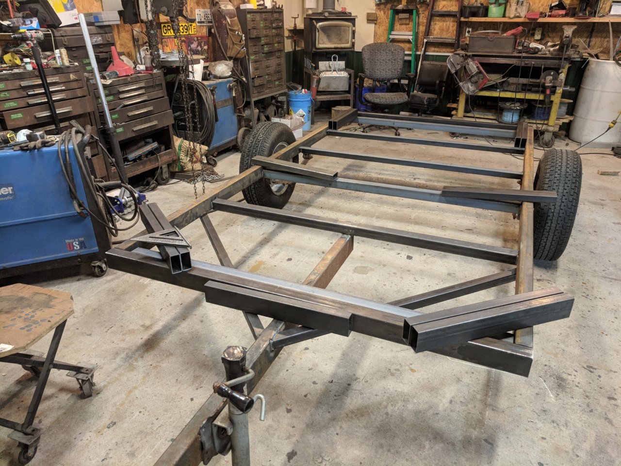

    Got the trailer flipped with the tires nutted on correctly.IMG_20180630_192731.jpg

    I've always liked your trailer design, straight forward and simple. But curious. if you don't mind sharing. What is the size of the frame? Thanks . John M
