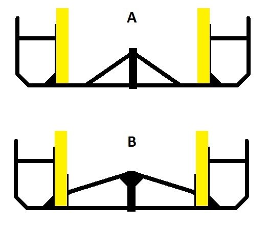

    I wanted to build a new rear bumper. I want to feel comfortable enough to tow a light trailer or pop-up camper if I wanted to. Would the design in "A" suffice? Or should I box the frame, add an inside mounting plate, gussets, etc. like in "B"? Or something else?

    What's the material you're making the bumper out of?
    By way of comparison, the stock class III hitch uses 2" square tube between the frame rail mounting plates. I think that's bolted on the bottom and sides (I forget). The receiver is welded center and has a plate that serves as support and to connect the safety chains to. The load rating is around 5,000 lbs.
    If I were going to use either design, I would invert the "v" shape and probably use "B" as the basis of my design.

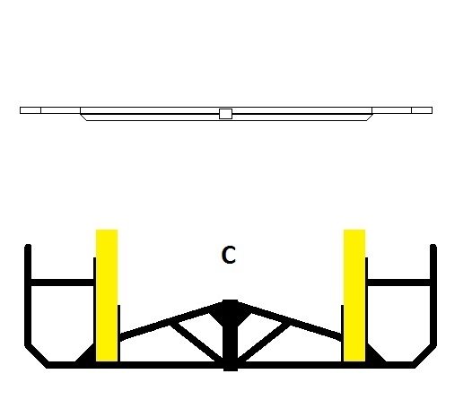

    I think he meant take out the "A" and do just a "V" that connects all the way to the frame. The way you have it all of the attachment is at the rear of the frame. If you extend the "V" to the frame it will have a much higher spread on mount points for leverage
    Edit: Looking at it again I think your "C" would be better. If you remove the "A" portion you dont have anything supporting the front (towards front of truck) of the receiver

    This. You don't really need the "A" part as much as the "V" part.
    Of course, the stock hitch uses square tube and two plates. No other support.

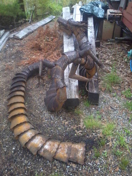

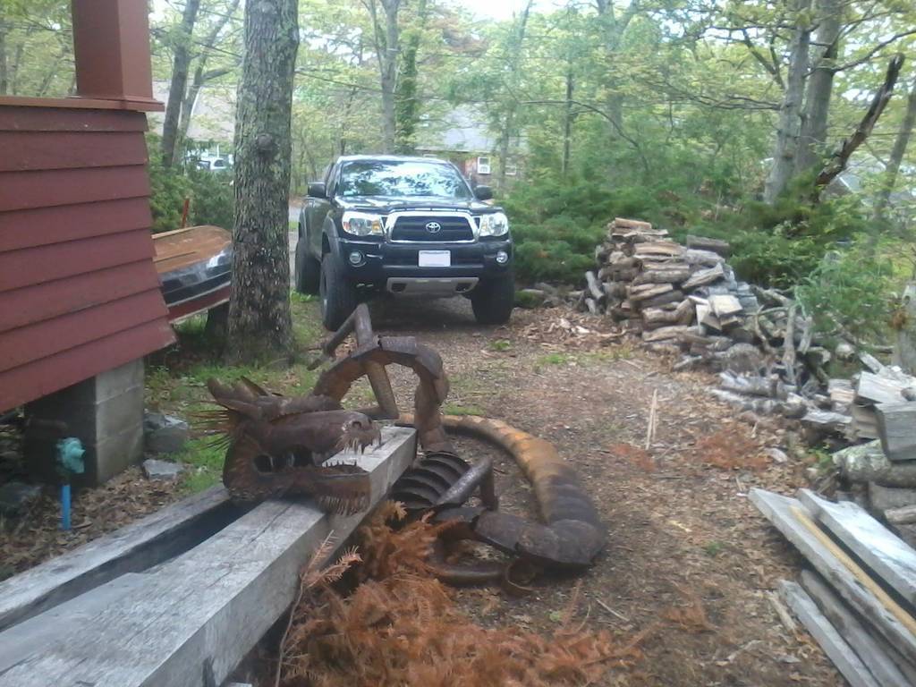

    Made this dragon over the course of the year. 18 gauge sheet steel, formed on leather sand bag, welded together using mig and tig. Tig used mostly on head so I could hit and form the welds with a hammer. Stretched out it's 28' long, still needs a detail for the tail which should make it 30'. All the links are attached to a chain so it's 100% articulate.
