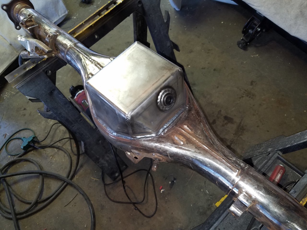

    Welded a 1/4" thick lunch box to my rear end today.

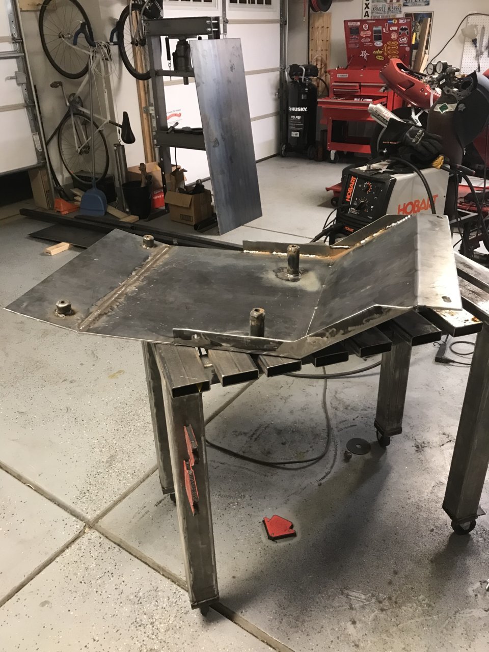

    Here’s my first go at building skid plates. Learned quite a few lessons today. Lol. But I got a good usable product nonetheless. Still going to add a few gussets and cut off some of those sharp edges tomorrow. But it’s late and I’m tired. C8D2E9FE-41A3-46BC-8E4C-68D6468A41FC.jpg

    Awesome job man! That looks legit. That skid looks like it’ll take some abuse

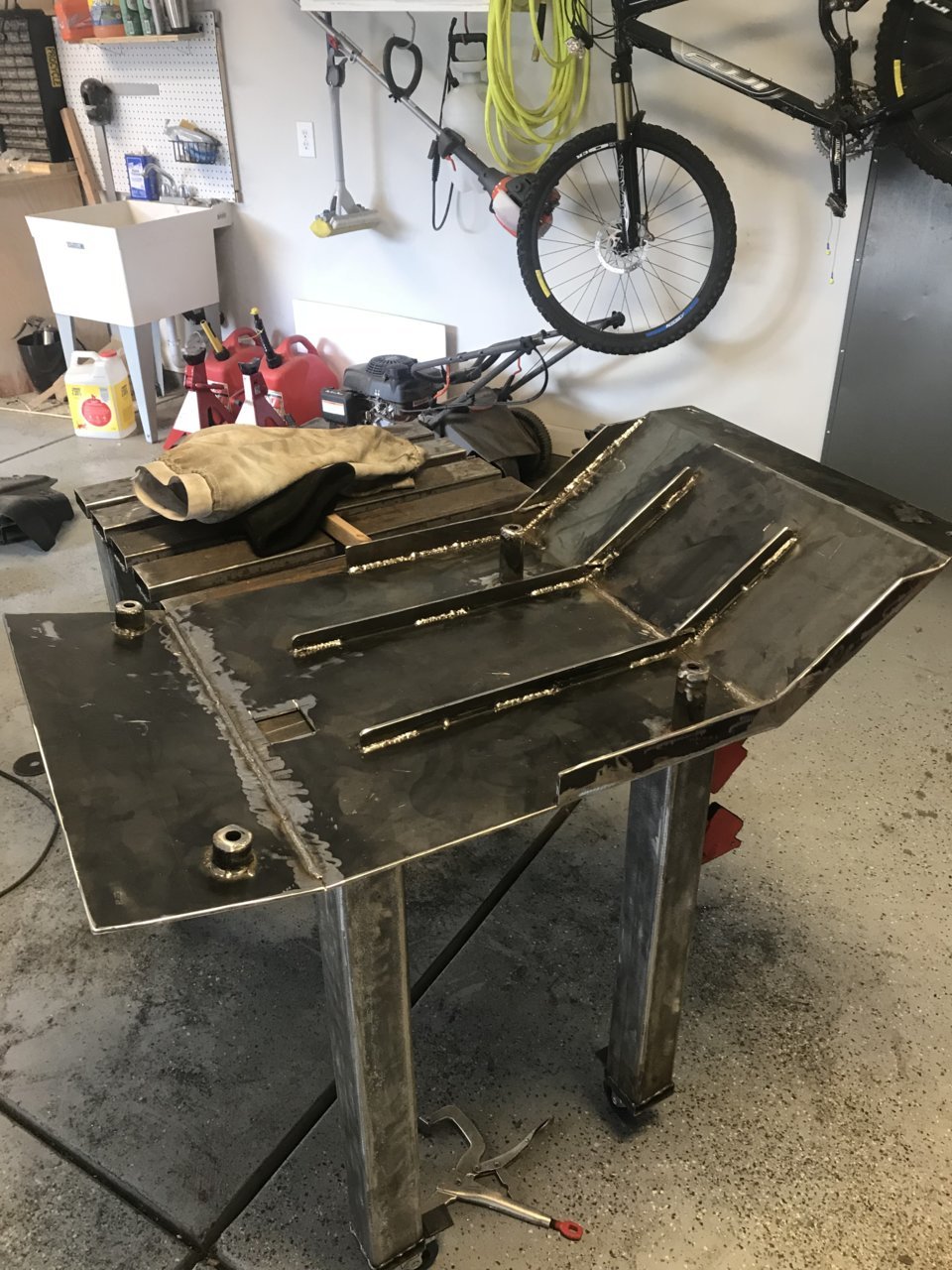

    That sure is the hope. After lifting it about a hundred times to test fit I’m sure glad I opted for the 3/16 and not the 1/4 inch. Here it is with the added gussets.

    Awesome job dude! Looks great. Pics of it on the truck next!

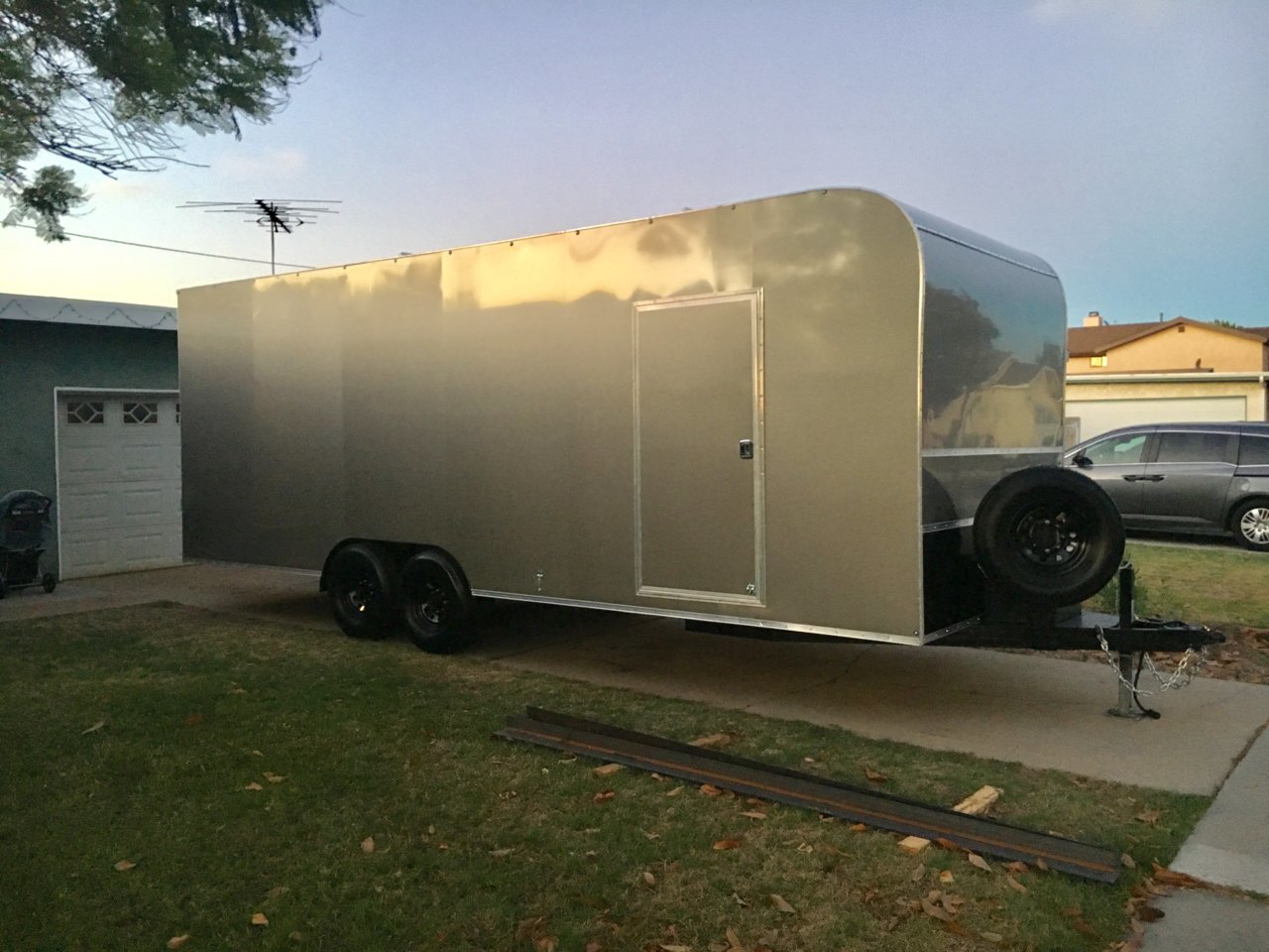

    Here is the new work trailer. I will post pics in the next few days of the racks that I’ve been working on

    Just a helpful hint from an old millwright. When you are making access holes make them round. Round holes don’t crack as easy as the corners on a square hole like you have cut for your drain plug. The square corners create stress points.a good set of hole saws is a worthwhile investment for your future fabrication. Skid looks great and should take a beating great job! I love to see when people take ownership of their stuff and build stuff the way they want it.

    Thanks for the advice. I had originally designed it with a 2 inch round hole however my hole saw wasn't cooperating and my impatience got the better of me. I think I may square up the edges a little better, fill in the over cuts from the grinder, sand it flush then reinforce around the hole with some flat stock. That should help mitigate any cracking from future stresses, hopefully.
