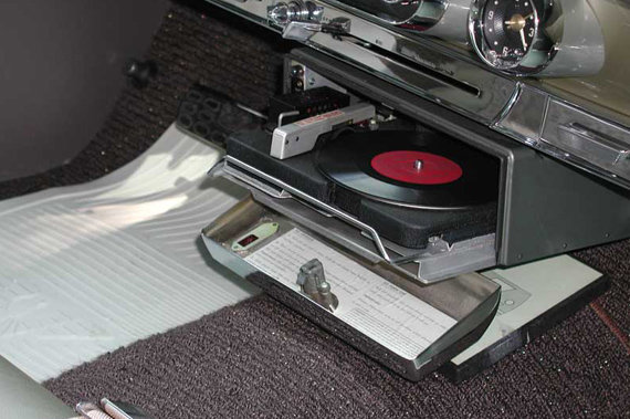

    Just in case you're unfamiliar with the terminology @la0d0g, 45s aren't "compact" just because they're 7" and only have one song per side.
    These really were a thing, BTW. I had a 1956 Plymouth Belvedere and there was an option that year for Hiway Hi-Fi that was actually an in-dash record player. Mine didn't have it, unfortunately.
