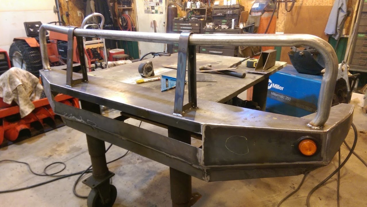

    I seem t have good luck welding tube. For me, if the one metal is thicker than the other, it helps the most.K3dx9MJf74VYw3NRBz1MNNdhlGwqSxx7aNIjTXQp_e06c414473e4f73192359a496218790f08b06958.jpg

    @koditten How do you decide your settings with multiple thicknesses?

    Trial and error mostly.
    A test, surface weld on the thicker iron 1st. If I like what I see, then I'll "wash" the weld puddle over the thinner tubing. This tube was actually exhaust pipe. I had a the local muffler shop bend the hoops. I had no idea if I was going to be able to weld it at the time. It actually came out quite nice.

    By ear.

    My first thought was adjust welding technique to how the machine is set.
    Thinking of those days before remotes when it could have taken 20 minutes or longer to get to the truck
    Kinda like dealing with arc blow I just adjust to what needs done comes from practice and lots of mistakes in your learning days
