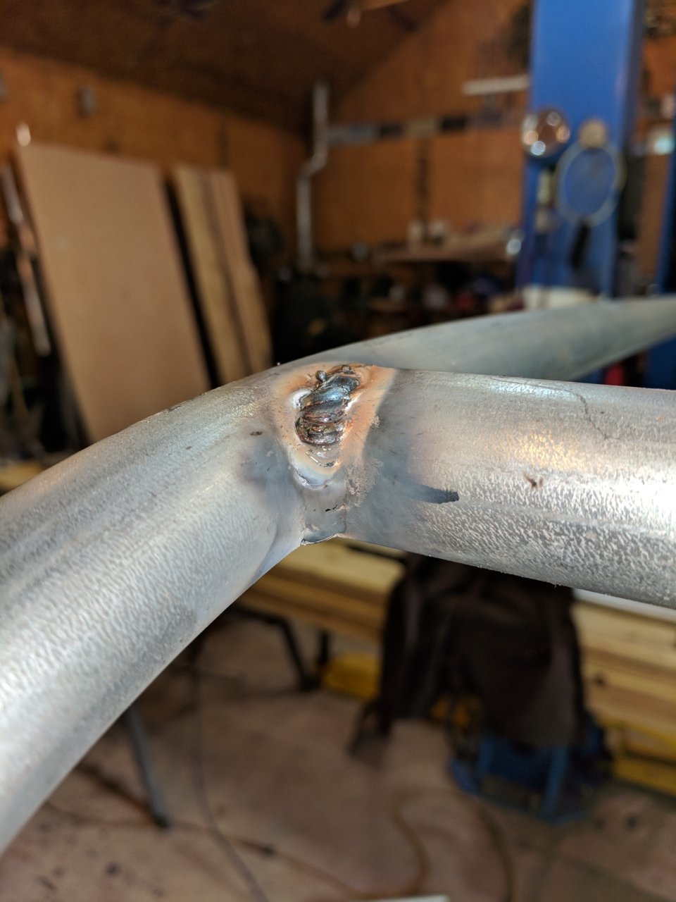

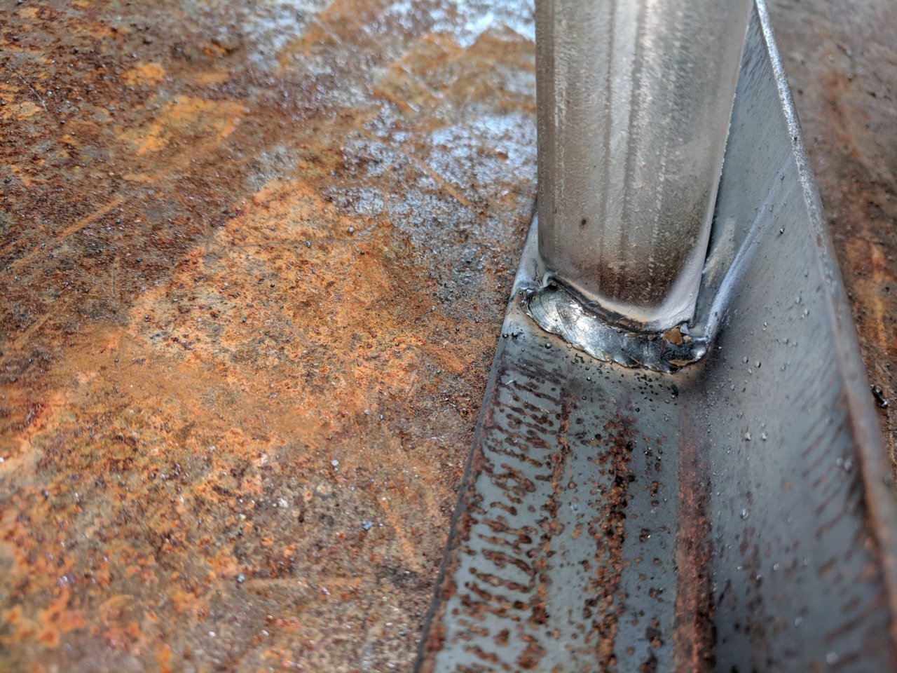

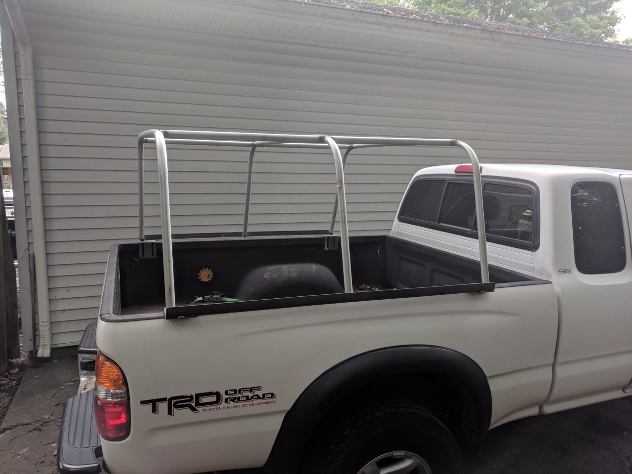

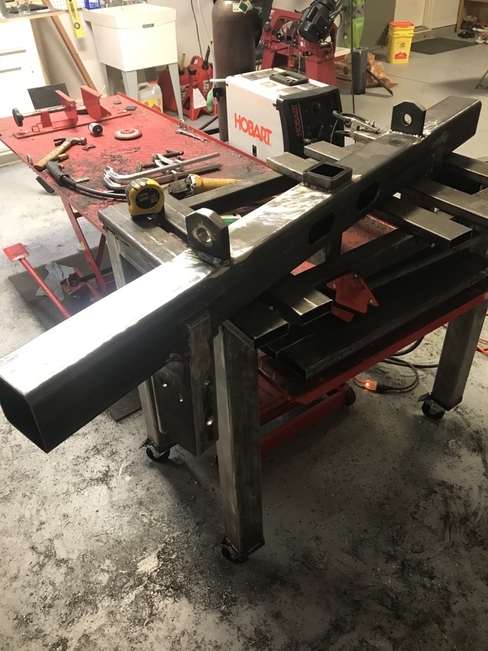

    Well I’ve started the back bumper for my truck. Now I’ve run in to the issue of how I’m going to prevent corrosion inside the main bumper tube since I can’t cap the entire tube off due to how the receiver is situated. I had to cut access holes in the tube in order to reach the hitch pin. Any of y’all know a good way to coat the inside of steel tube effectively?
    Here’s the bumper as it sits right now.

    Undercoation spray gun kit. They come with long spray nozzles. I use the brand Fluid Film u dercoating material with my sprayer.

    How easy does that fluid film wash off? Since its for a bumper, its not going to stay particularly clean or dry on the inside.

    It's pretty tacky. Mine only came off with a pressure washer.

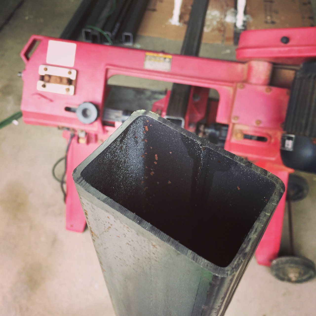

    I've had some very good cuts with my HF 4x6 bandsaw. Picked it up for $190. Has been one of the best Harbor Freight tools I've ever bought. Something to consider since its about the same price point.

    This. The HF saw is a great purchase.

    HF bandsaw for the win, picked this one up used for 50 bucks, bought a couple new blades off of Amazon for 20 bucks or so, gave it a cleaning and oiling, works awesome
