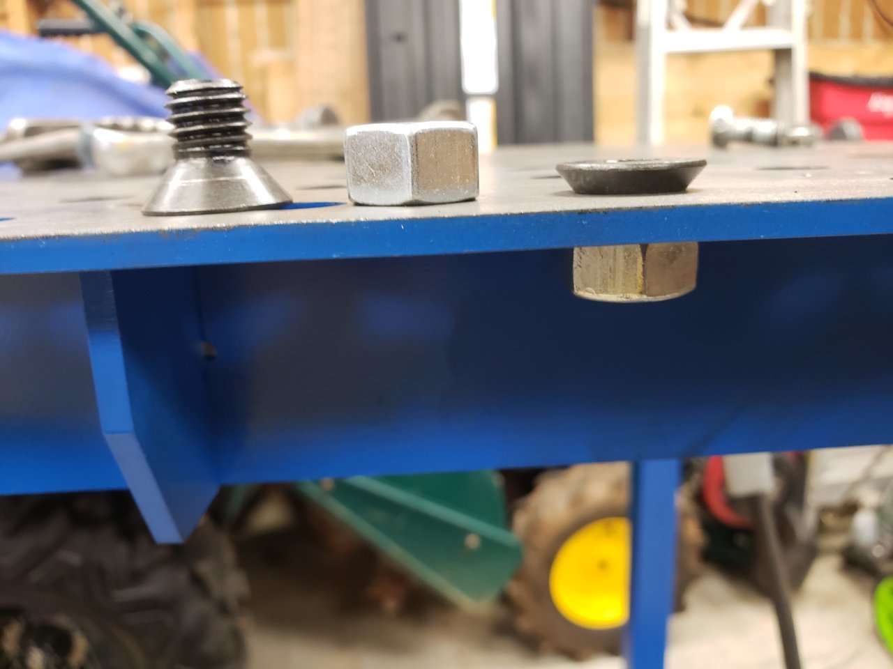

    A little trick I learned a long time ago, put a nut on a machine screw, tack 2 places, remove screw. Perfectly centered threaded hole. This is probably a common trick but I'll put it out there anyway.

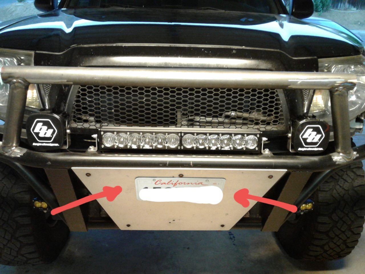

    Next project, to fabricate light tabs/brackets to relocate those lights next to the license plate.
