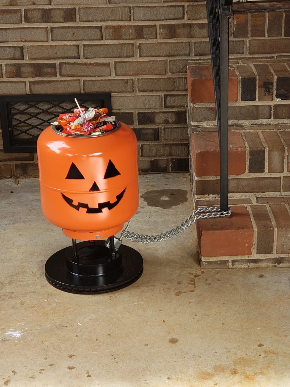

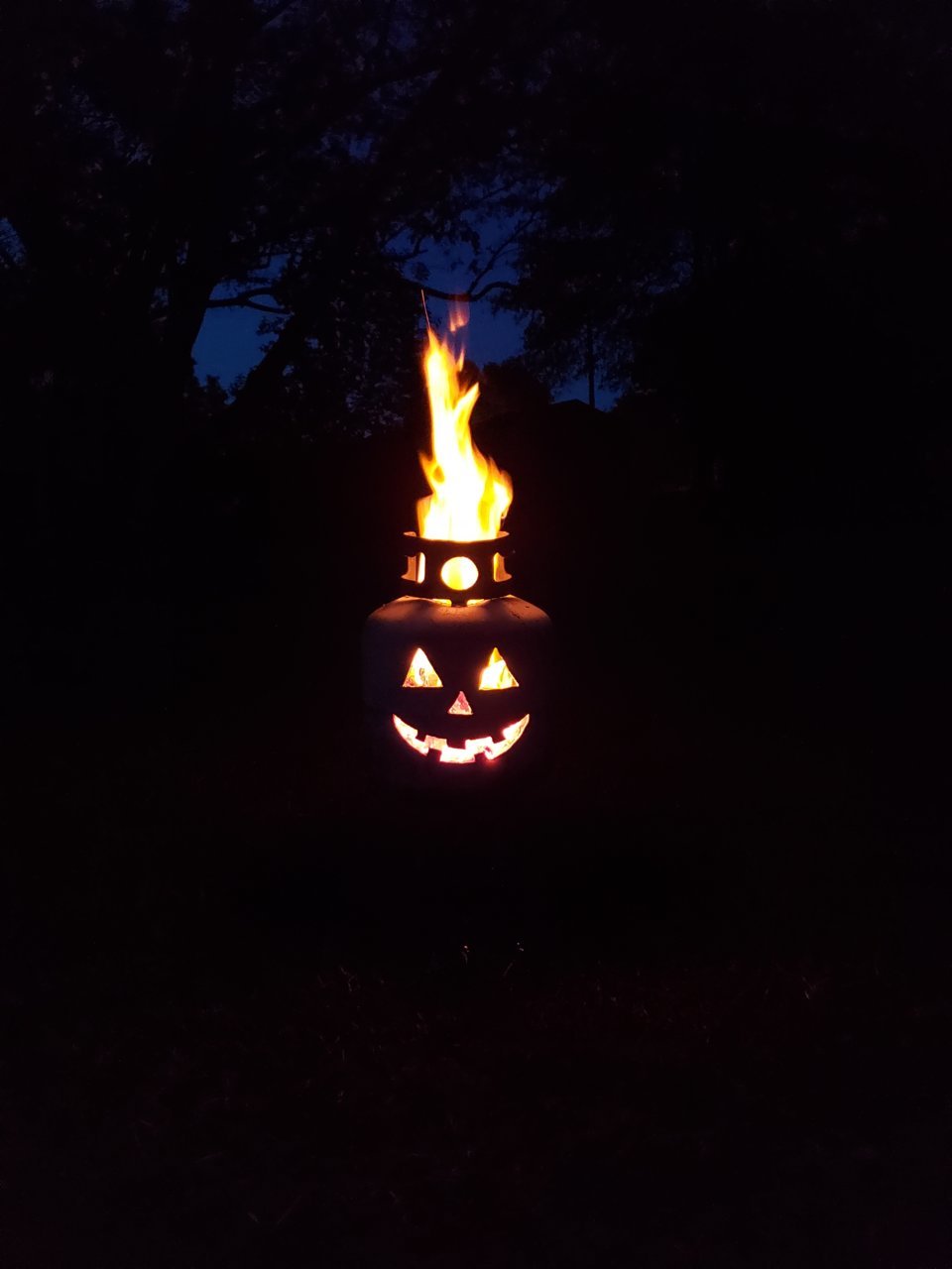

    I did one with water, was a royal pain to get the valve in screwed!
    Had to strap it to a 2x4 so it would not rotate AND use a big cheater on my monkey wrench. Dem suckers are glued in tight!
    Once open, filled with water to the brim. Emptied and started cutting!

    Remove the valve and filled it with water a couple times. 20181024_190721.jpg

    I strapped it in the corner of my trailer and used my biggest pipe wrench!!!!

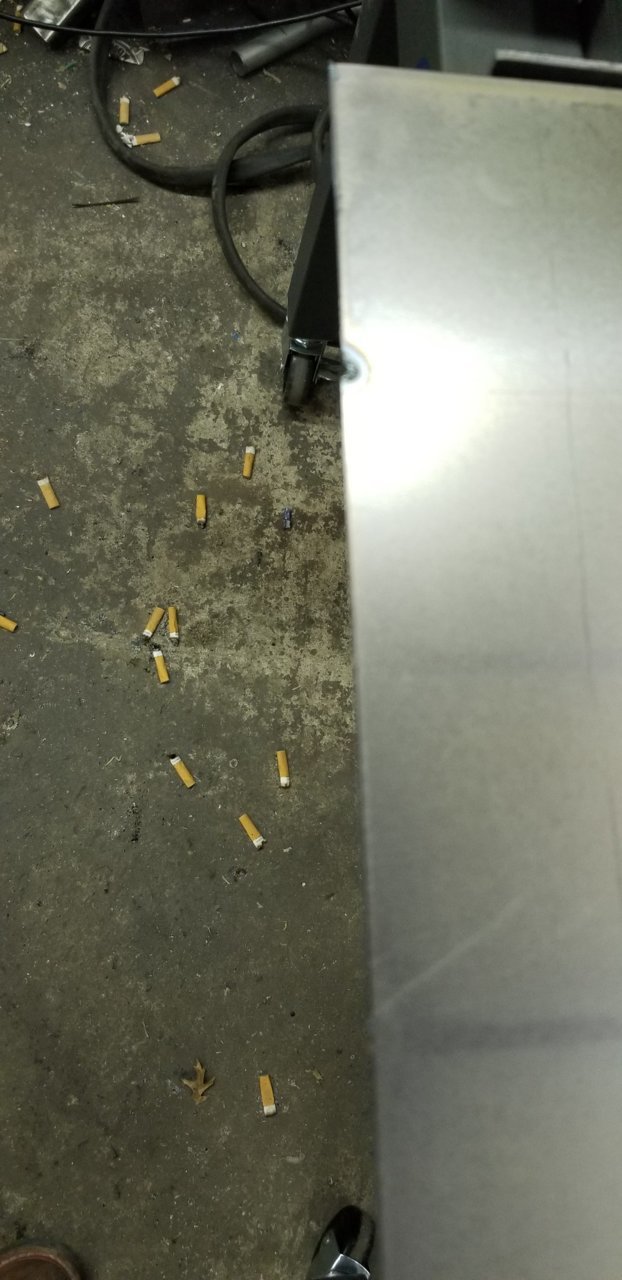

    First cut with the plasma table. Did it in manual mode as a test. Now to learn the ins and outs of the software end. :annoyed:

    What did you plasma cut Jon? Cut the cig butts off of the main cig? :boink:

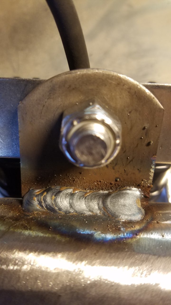

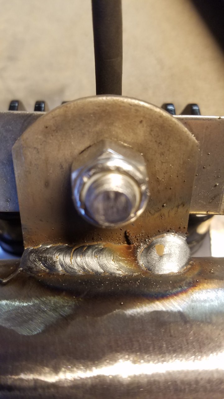

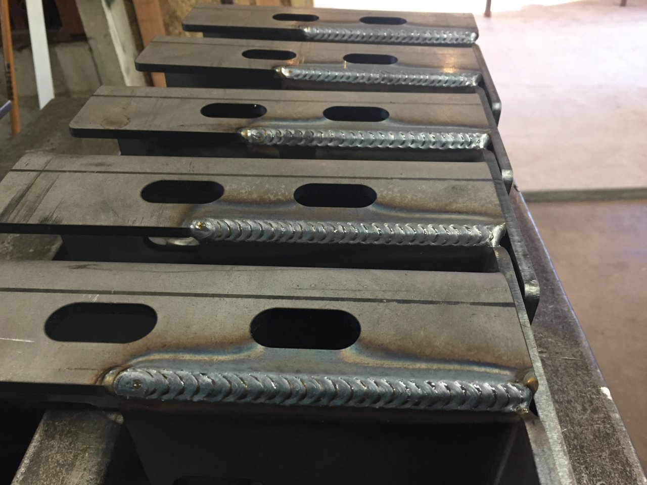

    More light tabs

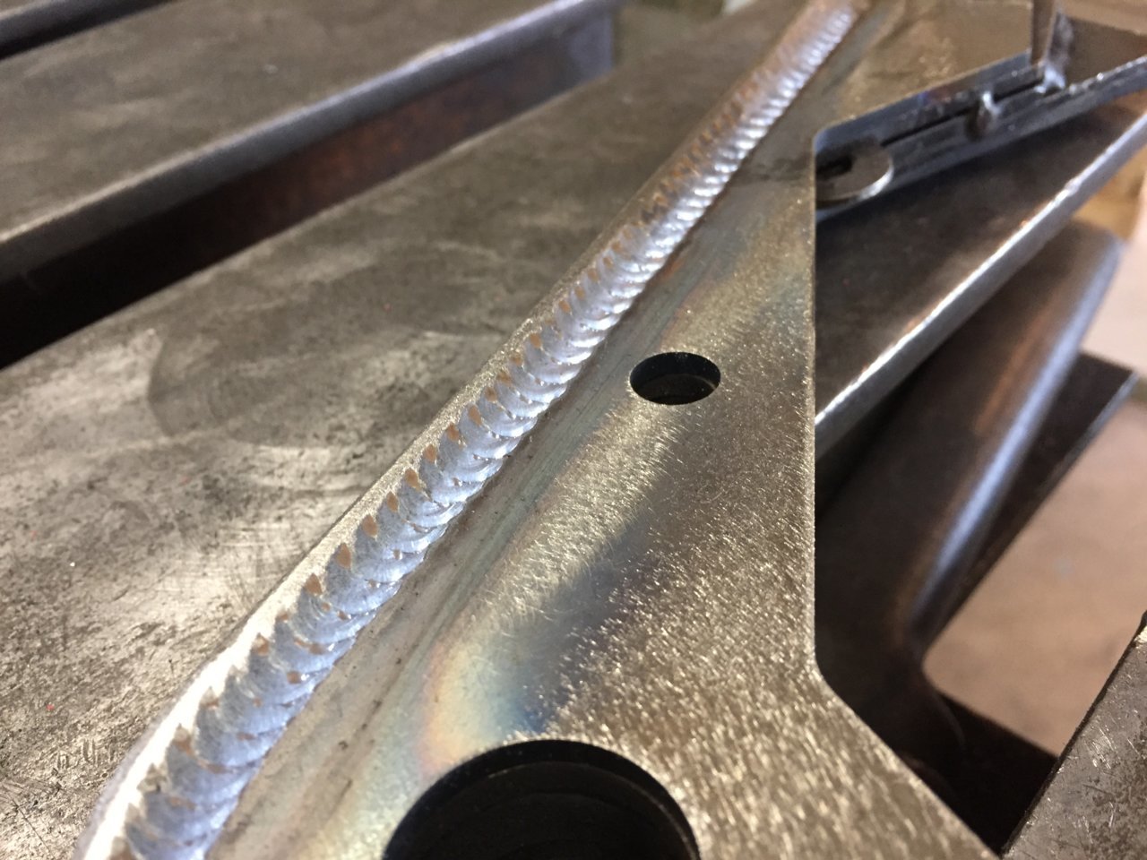

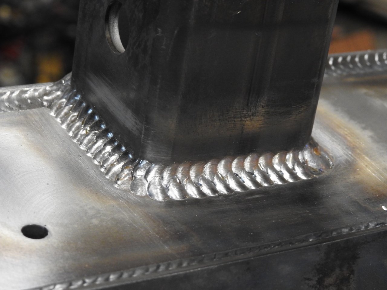

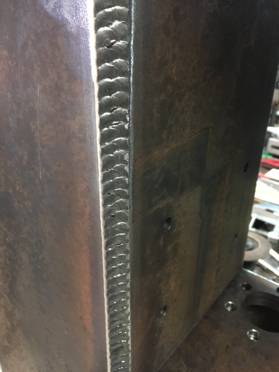

    A few recent projects.
    3/8" open corner with a 1 pass weave
    The was about 24" long done in one go. Probably took about 1/2 hourIMG_0285.jpg

    thats cool as shit! i have a few spare tanks laying around i might have to do this with.

    that looks super! really well done

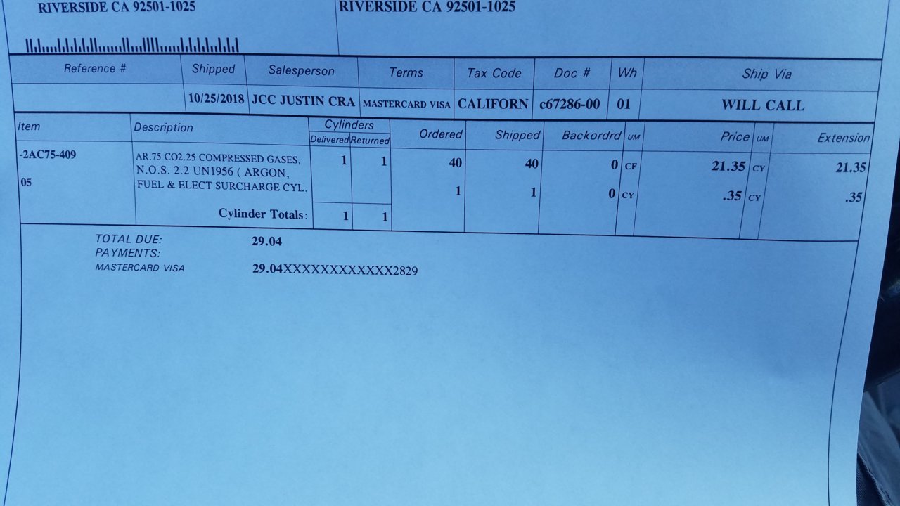

    How much r u paying for mig20181025_121624.jpg gas??

    They turned out awesome.
    Do you live in a shitty neighborhood?

    I live on a busy road near a high school, your truck will be gone through if not locked up. Just part of it, this at least keeps it in place.

    $43 for 80 cu ft

    Last I got 2 125 cubic feet swapped with one hydro test I paid $108.00 and change
    I had to look in the check book to be sure
