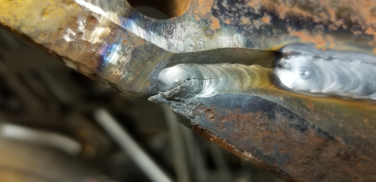

    Ok. What the hell caused this crack? Cutting edge on a small backhoe bucket.
    Beveled both sides. Clamped a backer to it for alignment and gas containment. Did the root pass on one side then flipped it and did the other. One fill pass on this side and the crack happened. 150ish amps with Er70s-2

    is it a bolt on cutting edge of maybe AR-70?
    Different cooling rates between the cutting edge and the filler metal as the back side cooled it pulled the front causing the crack
    how much of a gap did you have ??
    much easier to tell in person

    Weld on cutting edge. Didn't seem hard enough to be anything other than mild steel. I left about and 1/8" gap for the root. Didn't want any voids just in case the operator wanted to go full ham with the outside tooth again.
    Definitely not a good bucket design. The splayed outside teeth put the one hole really close to the cutting edge, not to mention that there is at least a 3/8" gap where the teeth could have been put farther onto the bucket.

    Preheat with a rosebud?
