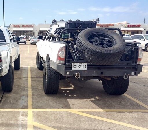

    So i have built stuff in the past and it came out “okay” but I think I want to tackle another HC bumper build for the runner. Before I get into it,
    Does anyone have any recommendations for a YouTube series to watch or learn from ? Just something that will teach me tricks and tips ?
    Here’s one I built before but I want the next one to be better.

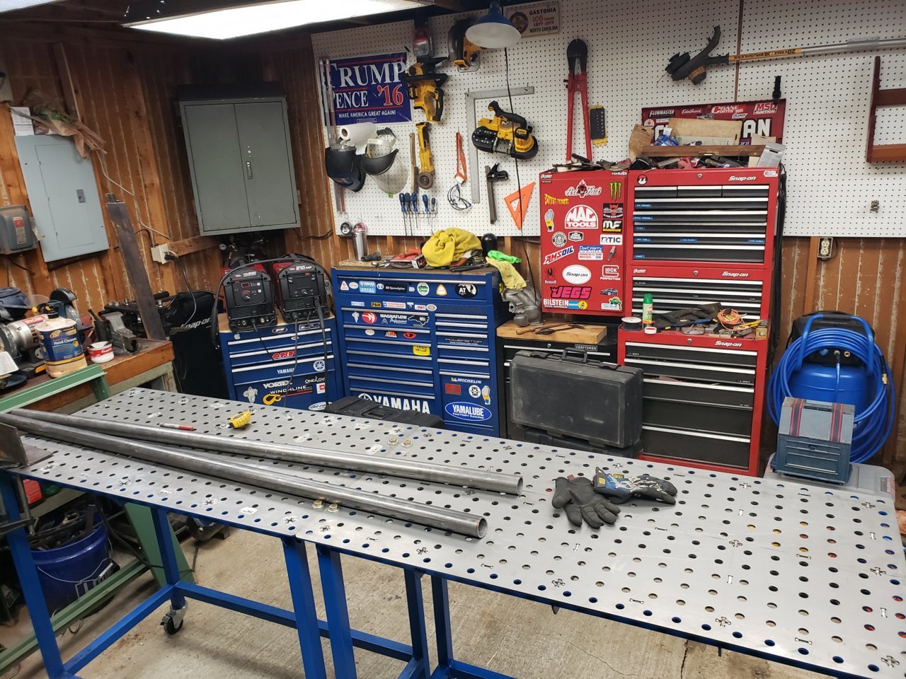

    New table came today, bending some tubing tonight!
    Rakso, koditten and Shmellmopwho like this.

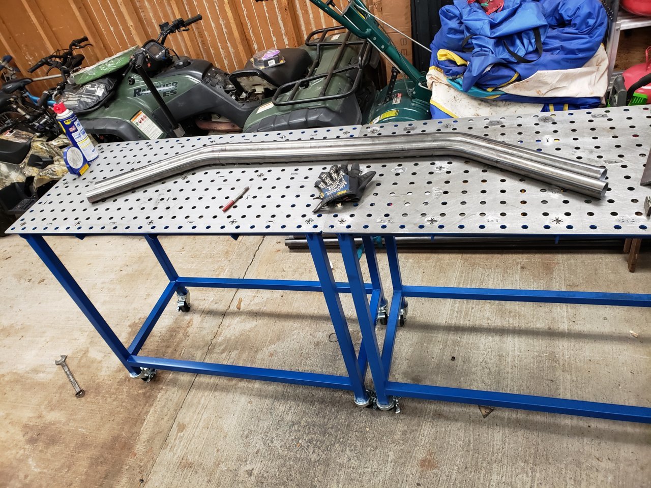

    20181029_233702.jpg Another set of bed bars to hide a rtt under the softopper.
    weldertaco and Shmellmopwho like this.

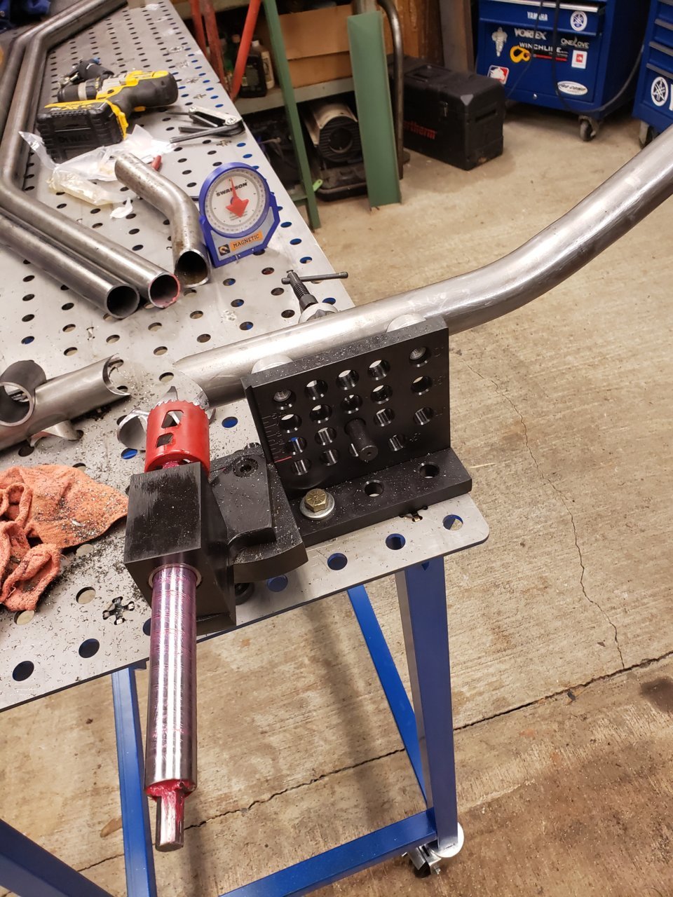

    Decided to get the arczone.com notcher. So far I like it.
