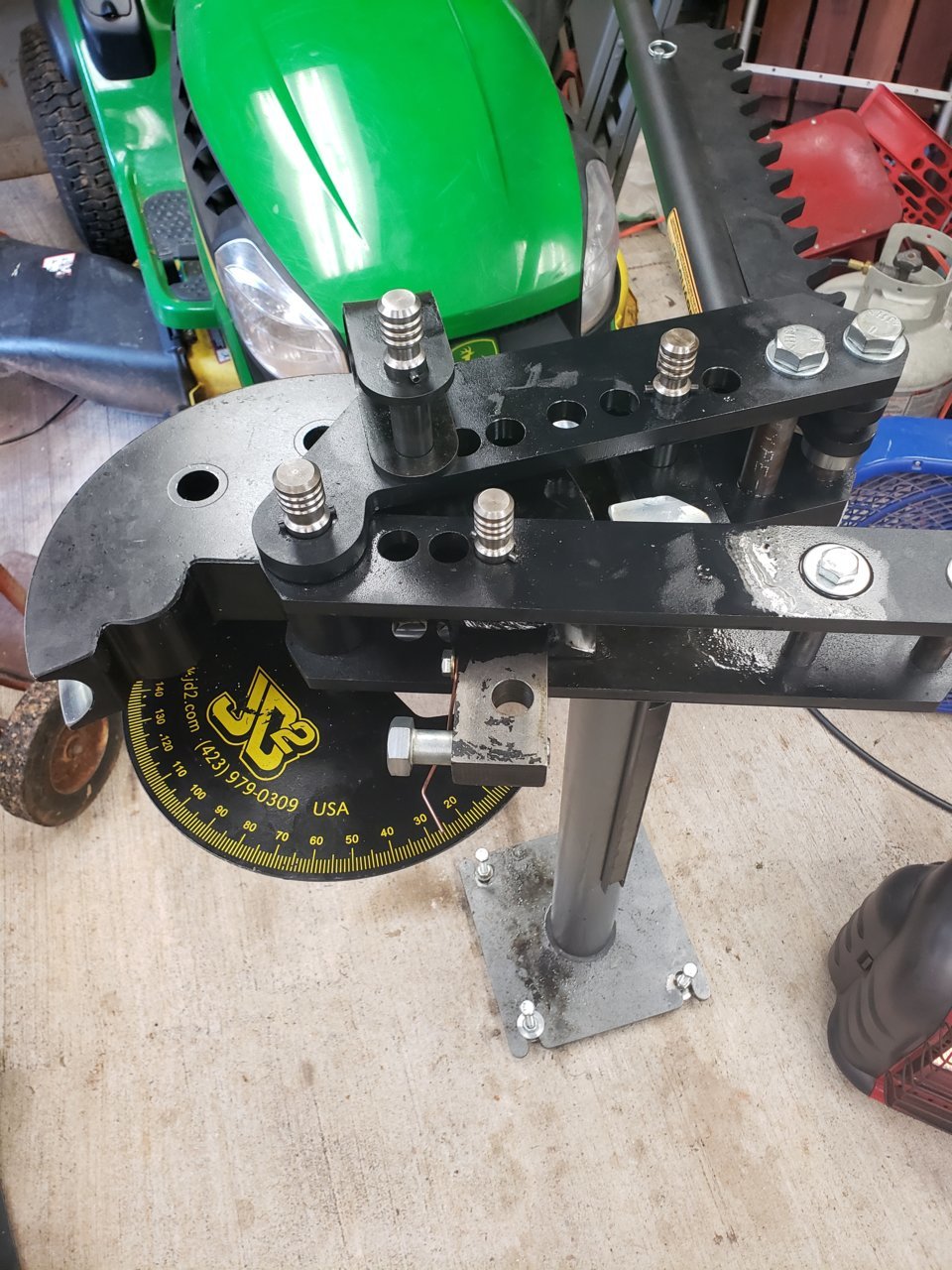

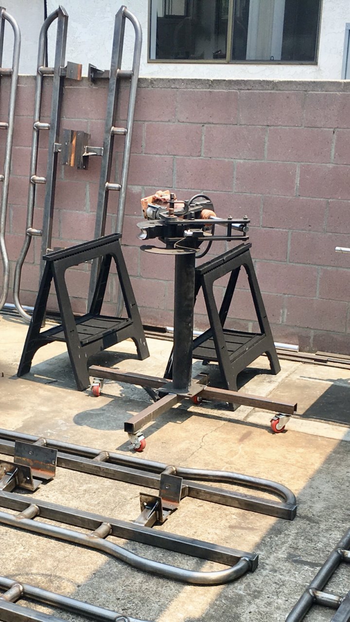

    You can either buy the stuff from JD2 for your hydraulic setup if you wanna spend another $1000-$1400 or you can buy the swag Offroad hydraulic ram mount and buy the 8 ton long arm ram from harbor freight that is air over hydro and hook it up to your air compressor. That route is around $250. Works great and is only a little slower than the Gucci hydraulic setup from JD2
    Edit: also, as for a stand, JD2 wants about $150 I think for their pedestal stand. I went to the rems section of my local metal supplier and found a piece of 4” round 3/16” wall tubing about 4’ in length and made my stand out if that. Super cheap since it was in the rems section. Bout $15. Bought a 3/16” thick 10” round laser cut plate that they had at the shop for another $12. Then I used some scrap 2x2 tubing I had laying around to make some legs and added some casters to the bottom. Bout $60 total to make a rolling stand that works great.
    Martyinco and Rakso like this.

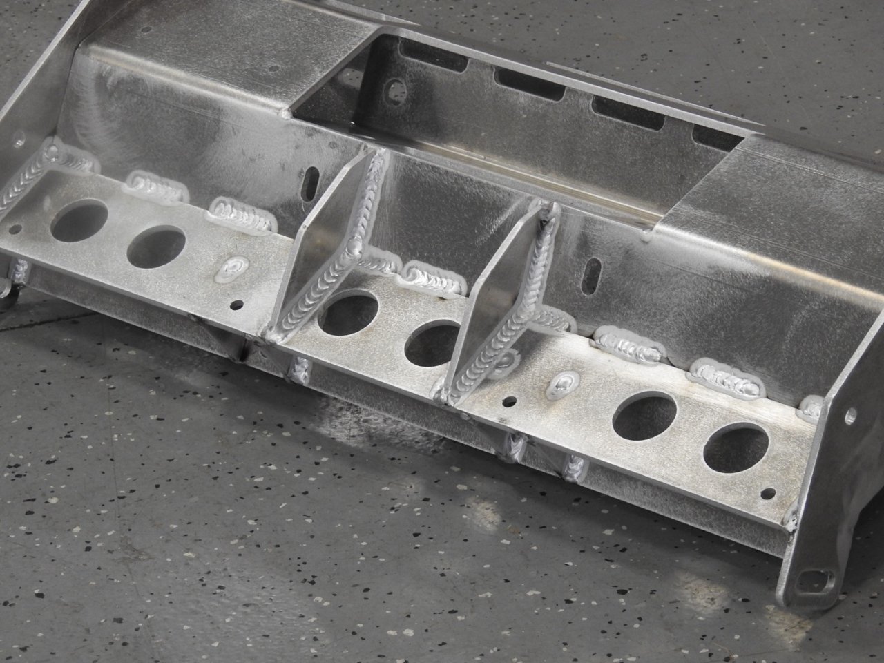

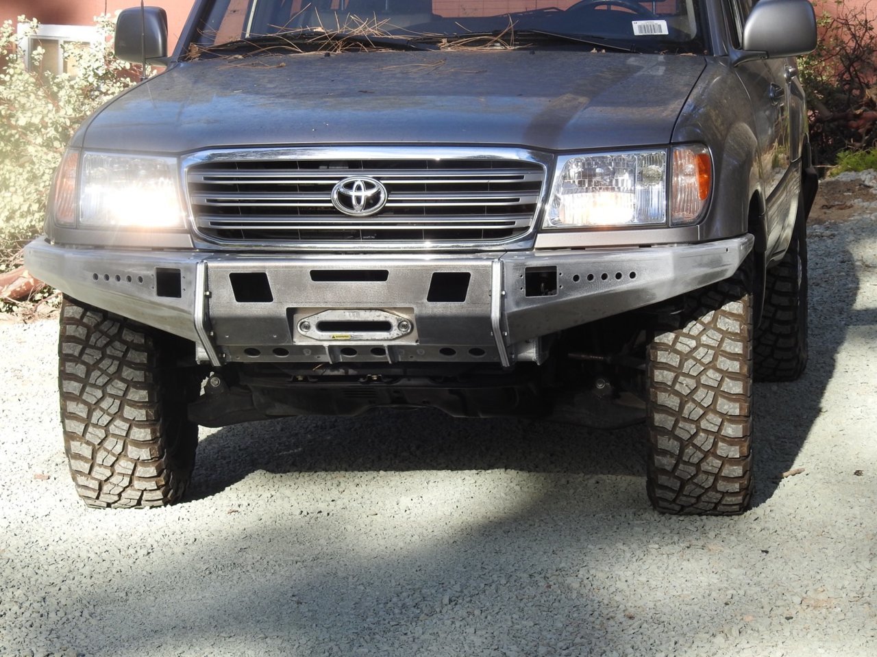

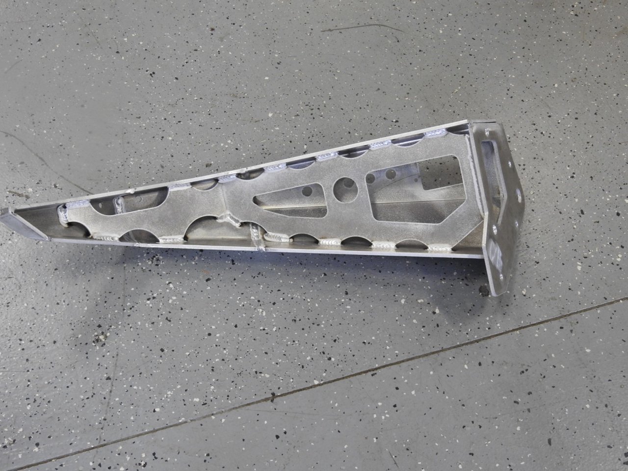

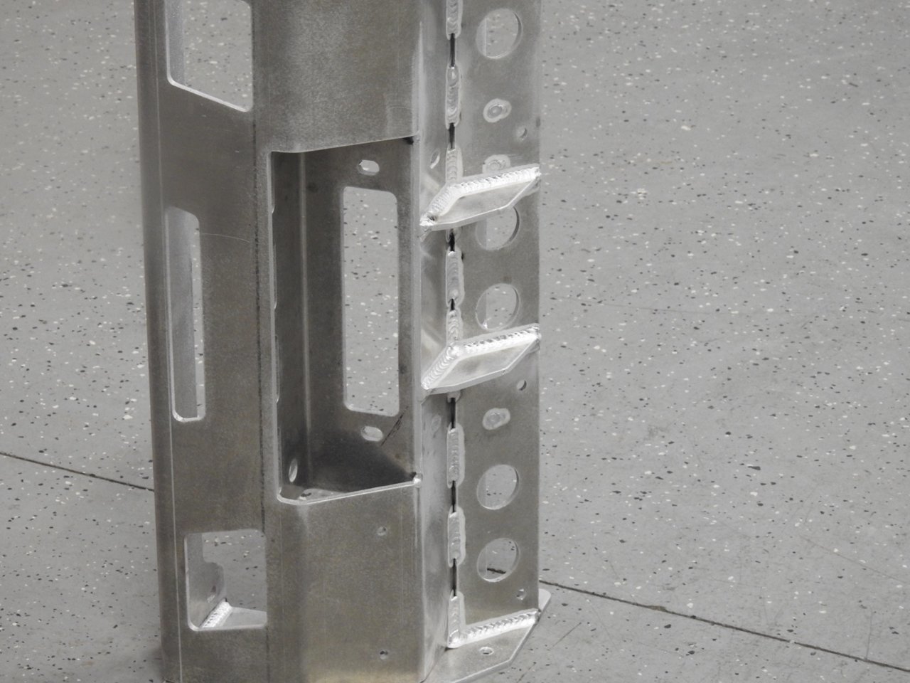

    Finalizing my aluminum 100 series bumper! All welded with my invision 352!
    whitedlite, mjp2, Rakso and 8 others like this.

    @Jerneyman
    Bad picture. But the only one I had on hand to show the stand for the bender

    Adding the hydraulics allows you to mount the bender on a movable stand, correct?
    The hand version needs to be bolted to the floor or something similar?
    Shmellmopwho likes this.
  19. Oct 31, 2018 at 9:28 PM
    #9639
    Shmellmopwho
    Shmellmopwho Well-Known Member Vendor
    Apr 10, 2014
    #127399
    11,682
    Lomita CA
    2013 White DCLB TRD sport
    Bunch of stuff
    Exactly

    that looks soo good!
    would you care to share any dimensions? Myself and another person are looking to do the same. Already have the frame plates cut, just working on the tube bender now, After that is slider time
    are they angled up at all? how much "stick out" past the body are they? total length ect.. :)
    no worries if you want to keep that to yourself. I'll understand.
