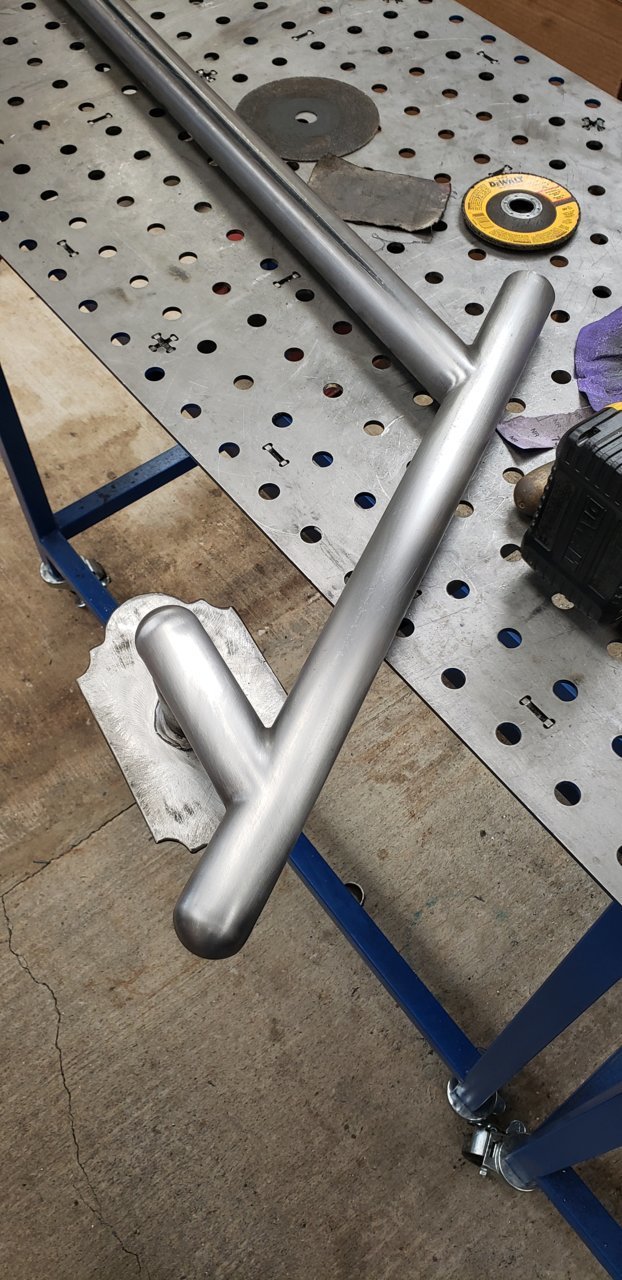

    Waiting on more tube ends to show up and this will be ready to paint. I need a lathe.

    What do you use to get those welds buffed out so nice?

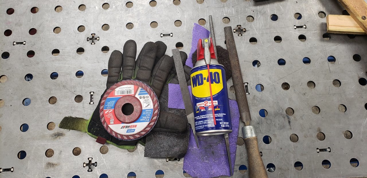

    I blend almost smooth with a flap disc then level with files. Then I finish with sandpaper and scotch brite until smooth and a light reflection shows no dips.

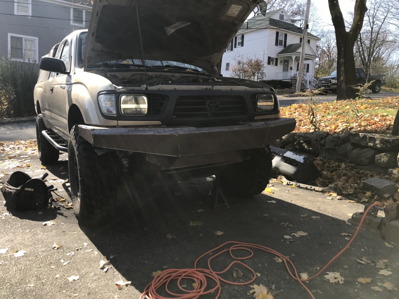

    Life feels pretty damn full, but @koditten made a good point... there won’t be any time later either, bucko!
    Thanks for a kick in the a**
    Got a few more pieces cut and tacked. I want to add a lower “wing” piece and a few gussets. After that I think it’ll be ready to burn in and move on to prep and paint.
    Slow going and crooked as a cop, but I’m happy with it :cool:
    I’ll cut some off the top plates to keep room for a winch and add some cut outs for a fair lead and recovery clevis’
    I’ll trim the sides to help the tires clear and am also planning some cutouts for fog lights at some point.

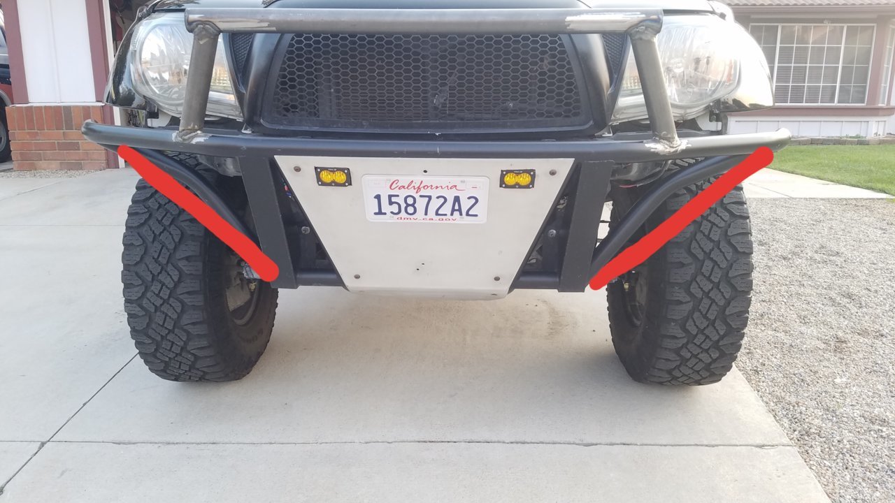

    For my next project I'm gonna replace the side tubes for something different. The red lines represent the new tubes. Thoughts?
    I actually already cut them off.

    Seems like you'll lose a little when approaching rocks. Why the update?
