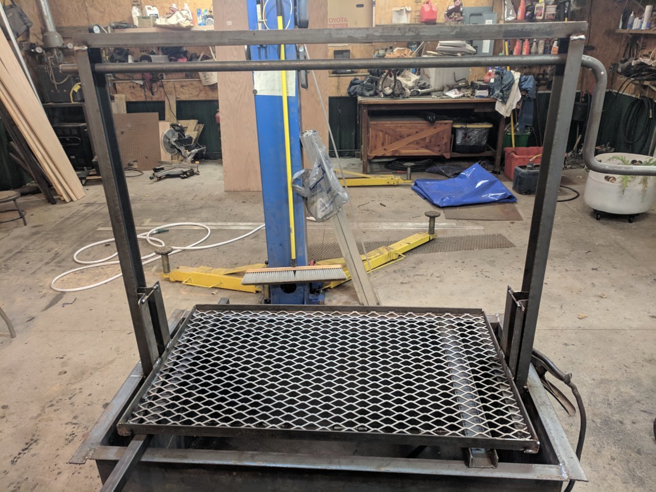

    Here's a model I through together last night of a tire carrier I'm building for a buddy of mine as a first real project. Should come together nicely if I follow my own directions. Haha.

    That’s way cooler haha. I’m stupid when it comes to CAD software. I just started playing around on Autodesk Fusion 360 and it seems pretty user friendly so that’s probably what I’ll continue to use when my plasma table comes in!
    I like what you have come up with there. I’m assuming that the ends of the low round tube at the bottom backside are where the tube bolts into the bolts that attach the bed to the frame? Having the tire over to the left that far doesn’t interfere with the wheel well hump in the bed?

    The "tire cage", if you can call it that, bolts in to the front bed bolts. From what I can tell, it shouldn't interfere but we will see when I get the tubing bent. May have to make some adjustments. I think to avoid some potential flopping, I'm also going to weld in some tabs so I can run some bolts from the cage to the front bed rail. That will give it 4 points to be secured instead of the two I've currently got.

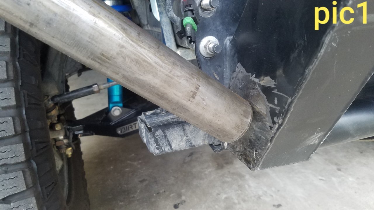

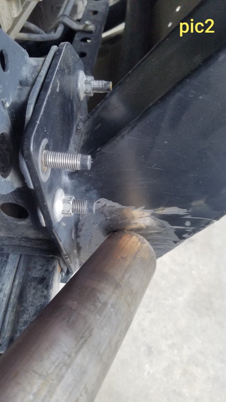

    Some help needed here.
    I'm sure I can find/cut the proper angle if I wanted the tube to be angled to the plate (base) (see pic 1), but I want it at an angle (see pic2). So how do I determine how to cut it? I understand the complexity of explaining over letters but any help is appreciated.
    And this is just get it angled. The opposite side will be another mission.

    The way I’d do it is look at the piece of tubing and the side where you want to attach it directly head on from the front of the truck and draw a line as parallel downward on the piece of tubing as you can and cut with a grinder if that makes sense

    I tape a pencil to a block of wood and scribe the pipe. Make sure the pipebulisv Xtra long.

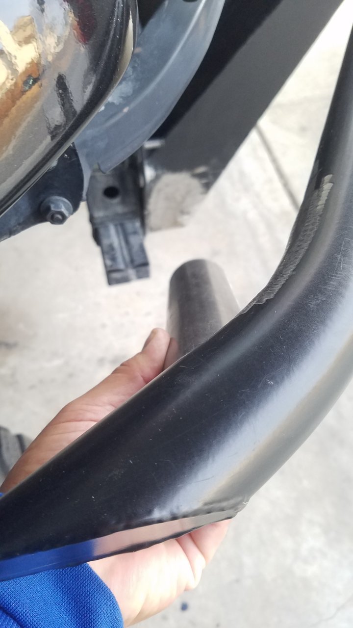

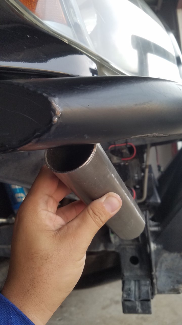

    Ok. What IF I get the notch first. I'll probably use that small piece to get the right notching angle first. I think figuring the angle to weld to a flat surface is easier. What do you think?

    Yeah for sure I would get the notch figured out first
