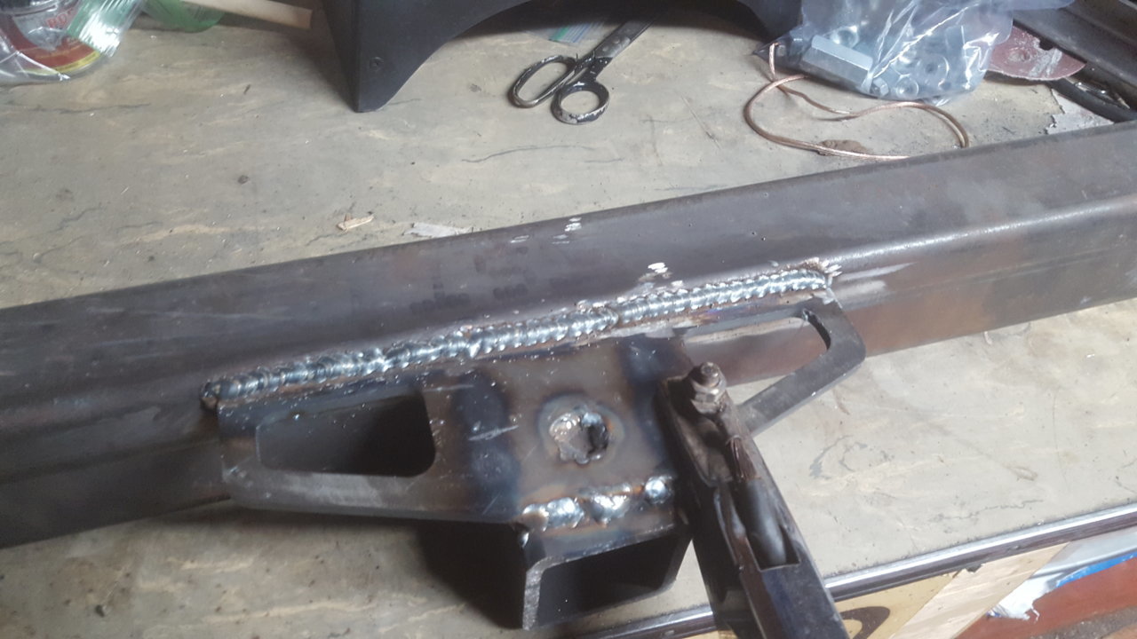

    few practice beads on scrap then welded in the hitch for now. hoping to get the rest done later this week. way better than the flux core welds i was getting just the other week. gas is so much easier.
    any critiques? my stop/new bead blends obviously werent great.

    need more consistent arc movement, and possibly more heat. looks like a lot of cold fusion on some of the hitch welds, if you want good strength for that i would grind a lot of those out and run a new bead.

    yeah consistency is definitely needed. are you talking the square face of the hitch?
    thats as hot as my 120v machine goes but i can move slower i suppose

    Yeah the face of the hitch and the sides of the bottom plate, middle of the plate looks alright,

    ill give it another go

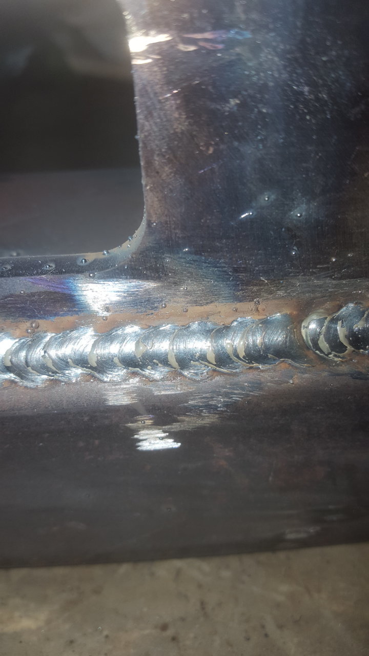

    hows this one? i am only using a 120v clarke weld 130en mig welder for reference.

    I'm not more than a beginner, but that go looks much more consistent. Nice work! I think you could go a bit slower and/or weave tighter circles to burn it in a little more. Maybe slower and less wire speed?

    I think it looks pretty good. I don't think you can get much better with a 120volt rig. You consistency is pretty decent. If you had a machine with more power, there would be nothing you could do better.
    Slowing down with less wire speed will help, but it will also make it easier to kill a contact tip. It's a trade off.
    I like a flatter weld, but that's just me. Once you learn how far you can go on a spool of wire, you learn how to extend that spool.

    thanks! much happier with that one. ill give a little less wire speed a try on the weld. trying to keep enough to not burn have the wire burn back

    glad to hear im on the right track. been following this thread long enough i picked up a few things.
    id like a 210v machine but itd require running a new feed line to the garage. i have a whole pack of contact tips. no worries there.
    first solid wire spool in this welder and a 40lb tank. see how far they both go this time.

    You will be surprised how long that can will last.
    Just keep turning down the flow until the weld looks bad.
