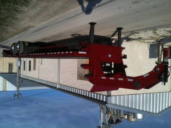

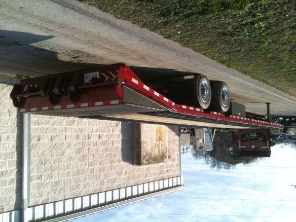

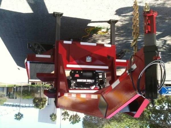

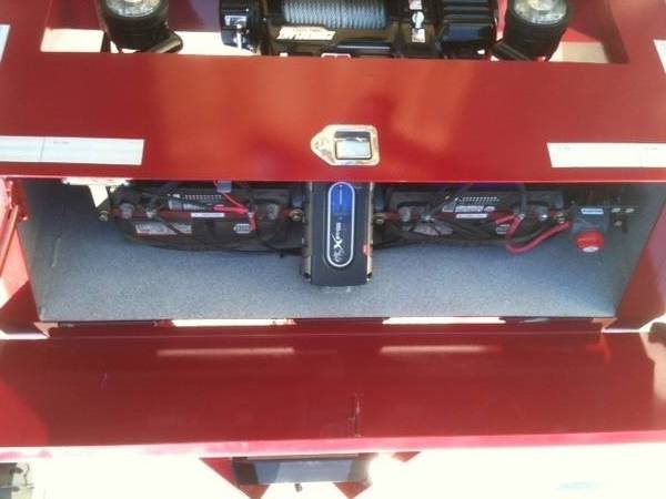

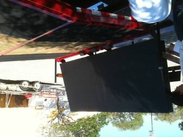

    Normal Highschools have football, band, dance ect. We had a welding team that built projects and took them to contests in San Antonio, San Angelo and Houston Texas. This past year i graduated and this was our project of the year we ended up winning Houston and placed well in the other two. A group of 6 including myself and our welding instructor made this 35ft Hydraulic Float trailer for a sponsor. Trailer was custom built for his needs on the job and includes a unique ramp design and yes we did build this from Scratch. Took 5 Months to build.
    Weighing the trailer at the scales in comfort texas.
    Above. Two Deep cycle marine batteries to power the 8k winch/air compressor and yes it is a warn HD Powerpack winch :D
    VVVVV Us after all the shows. Im the one on the bottom row, right black shirt holding the plaque, and wearing shades.
    Never did sports in highschool, this was my substitute! haha

    cool! What process did you guys use to weld it?

    We Mig welded it together using a Millermatic 350p machine. We used ER70S-6 Wire and 92/8 Shield gas. The whole trailer was pulse welded for deeper penetration and a gorgeous weld.

    Can you rephrase the question?? WE built the trailer from scratch and took a normal 35ft float and made our own twists on it to make it unique. From the tool box on the top of the towers holding the batteries to how we did the spair tire ect.

    No we did not, Our instructor has built float trailers before, this being the 5th in 7 years. We did beef up the bridgework underneith on this one because of its length. Has 15k axles. But no we didnt use any software to do that, our school barely wants us to use google sketchuip.

    thanks! Making the ramp work on hydraulic cylinders and chains-sprockets was a hell of a challange though....

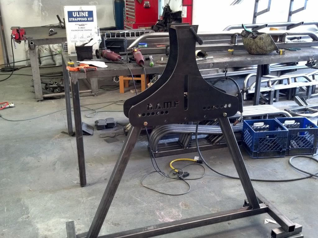

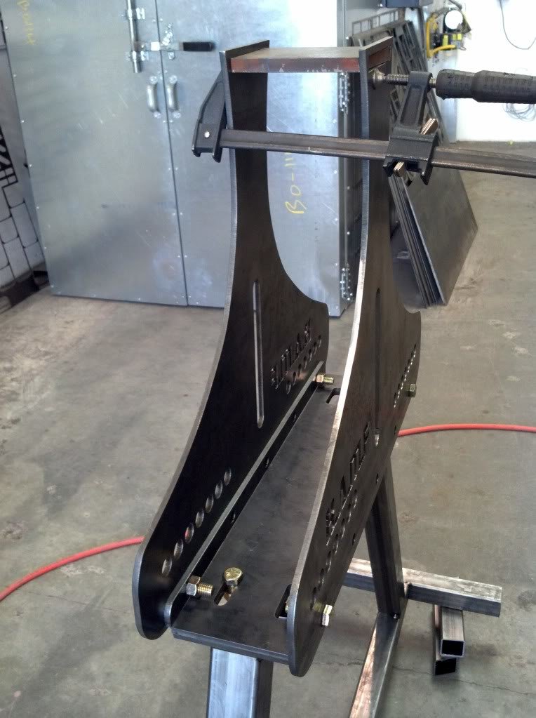

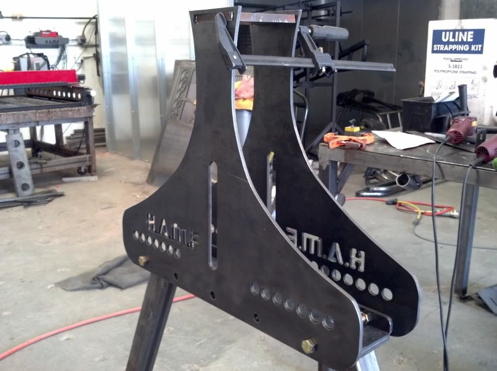

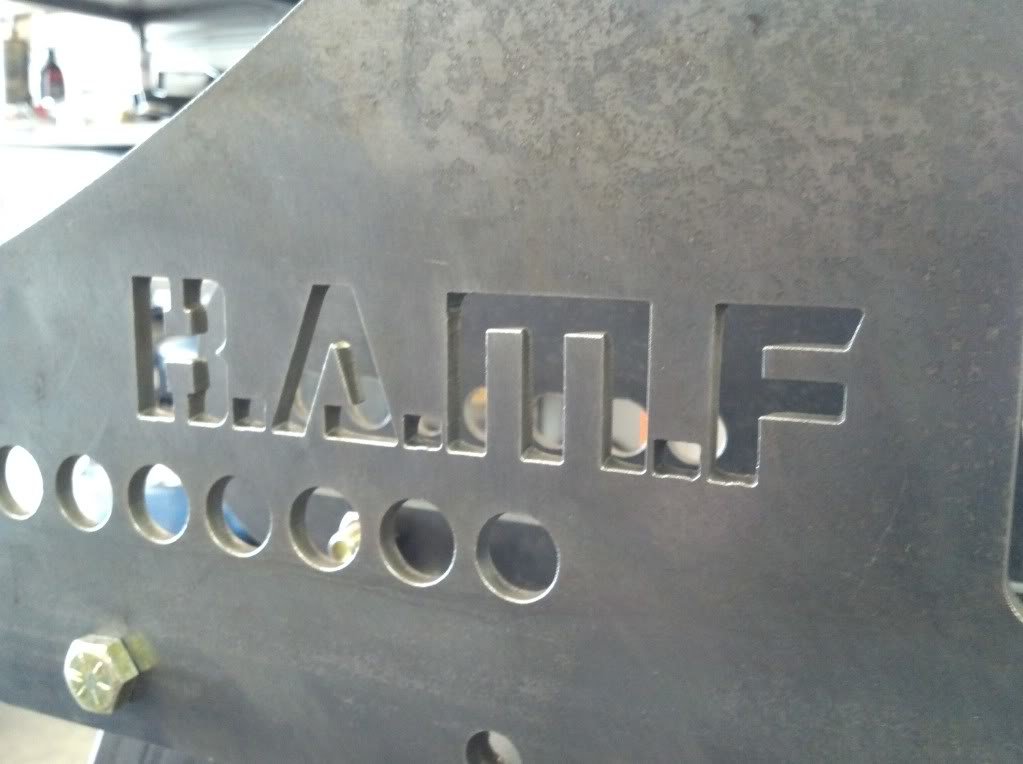

    Here is the newest tool I'm working on for the shop. It's a steel roller It's built around the SAWGoffroad roller dies. I thought about the HF unit but after the upgrades needed I felt it would be better to just built one myself :cool:
    I need to machine out the holes to 20mm then I can fully weld this bad boy up and start rolling steel.

    Looks pretty good. Gonna do the electric drive mod?

    Yep I've got the HF Pipe threader to powder it.
