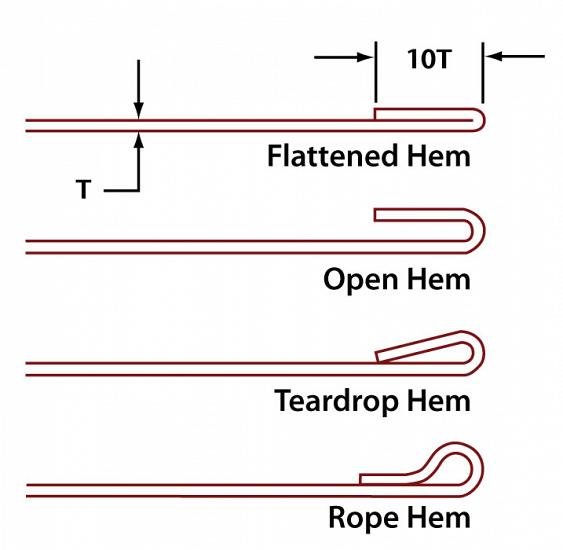

    Lloyd, what about having a sheet metal place press you out something like a rope hem panel to weld in? Looks wise.
    Not trying to talk you out if it. Just providing options

    @Casper66 - you’re the undercover/secret sheet metal expert. Can this be done on 1/8” sheet metal. And most importantly, is it NOT expensive?[/USER]

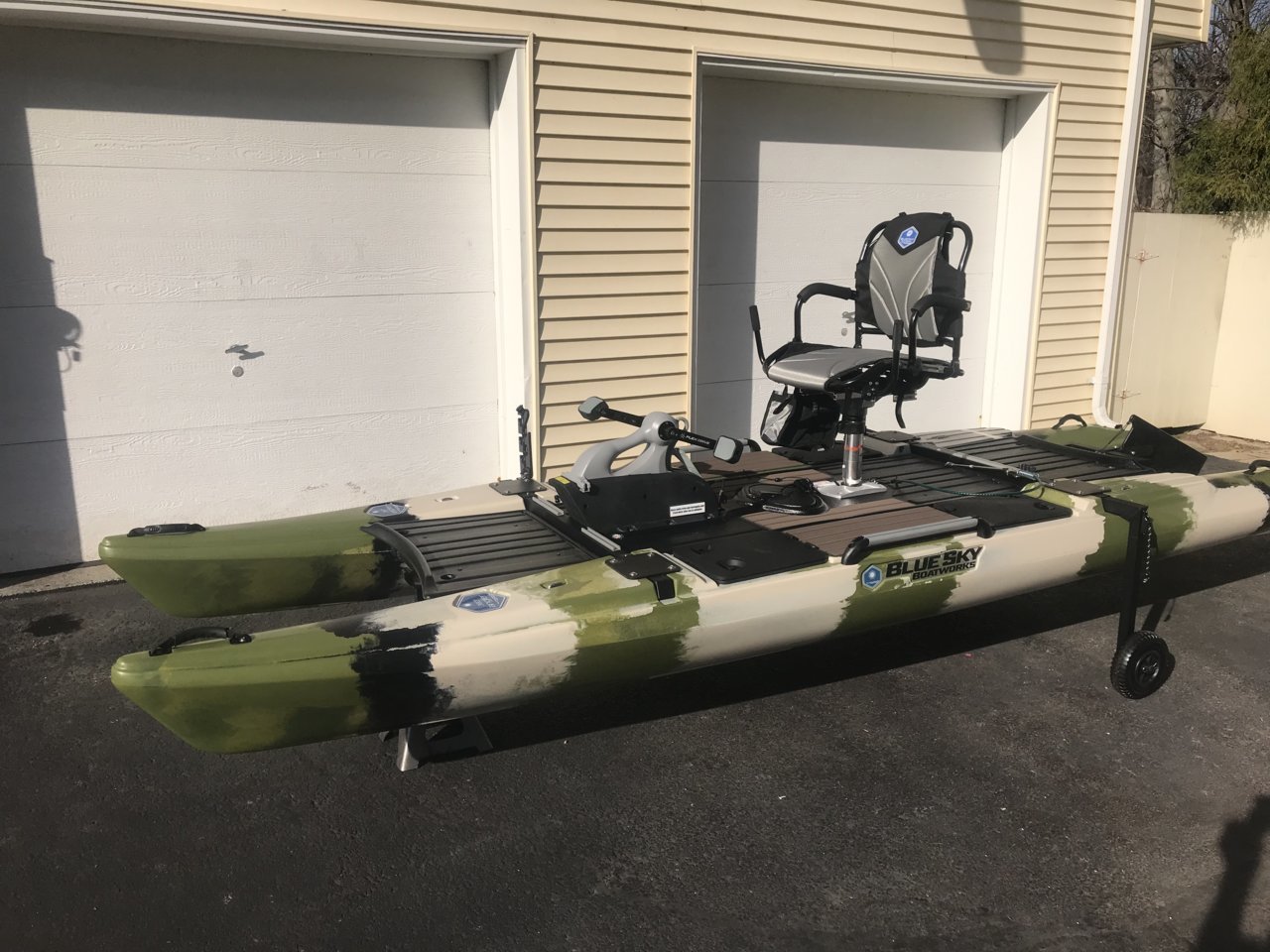

    The other 10% of the time it’ll carry my fishing machine that I got last week.
    Gonna start my new tournament bass fishing career in the spring of 2019. I should take home enough prize money to buy a paddle. Lol.

    Been a custom sheet metal worker for 13 years. Anything is possible if your wallet is big enough. Rolled edges like that will cost you thousand$. Only way to radius 1/8” that tight is to bump roll it. I have done many wired edges but its .020 material that you can use a rotary machine and hammer on. 1/8 is not feasable.

    Good to know.
    I'm going with the welded tube route.

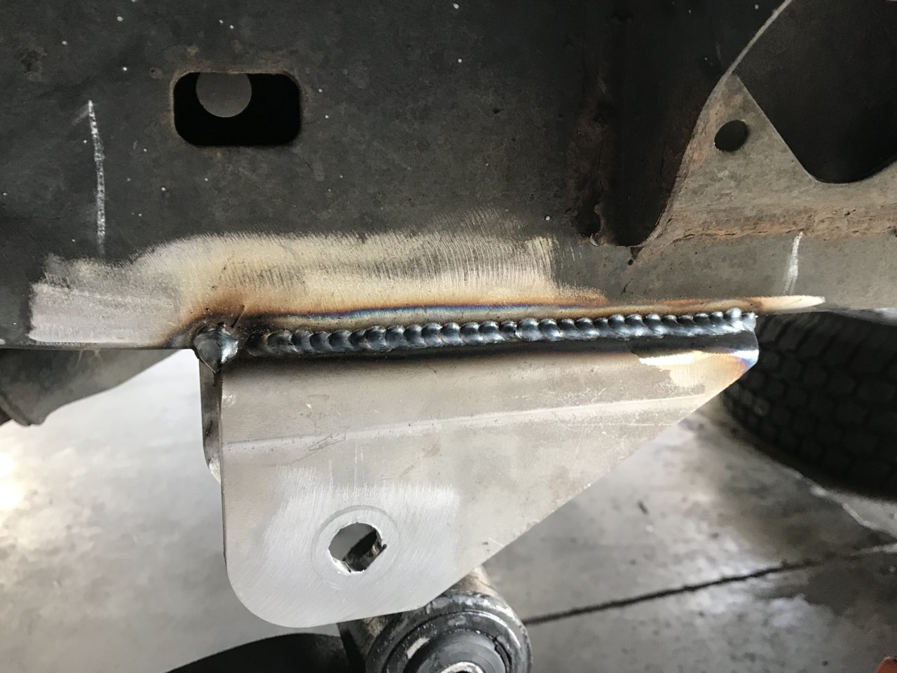

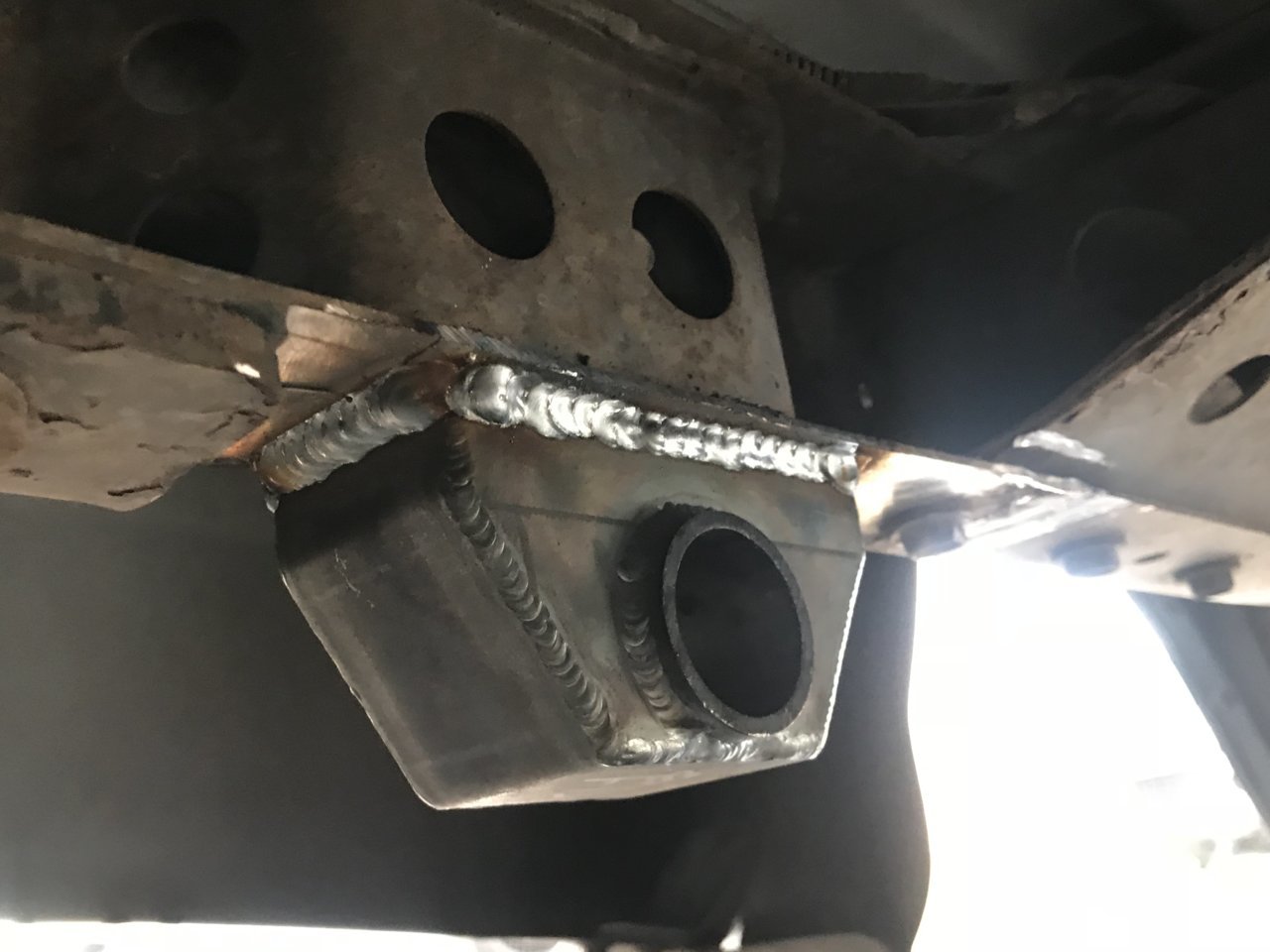

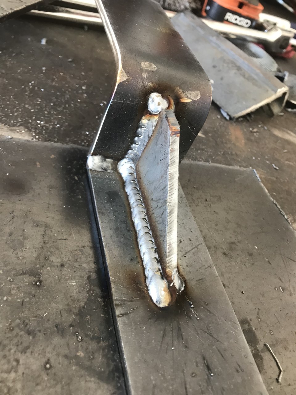

    Some beads from some jobs.
