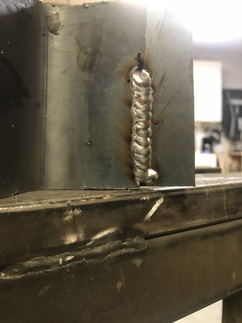

    So I got some time this evening to play around a bit. I was able to get a good bead first go around with vertical down like you said to try. I then tried vertical up with the same settings, about one voltage setting down and feed speed a bit slower than what I would do in the horizontal. I found better penetration going up in my case. This is what I was able to muster with vertical up on the 4th try.

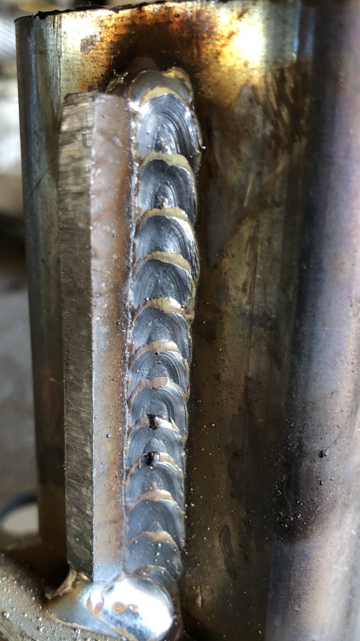

    Interesting. You have a picture of the one going down?
    This is another one of mine today, not as nice as the other one that I posted but a little thicker material (1/8” to 3/16”) here and same method going from the top to the bottom

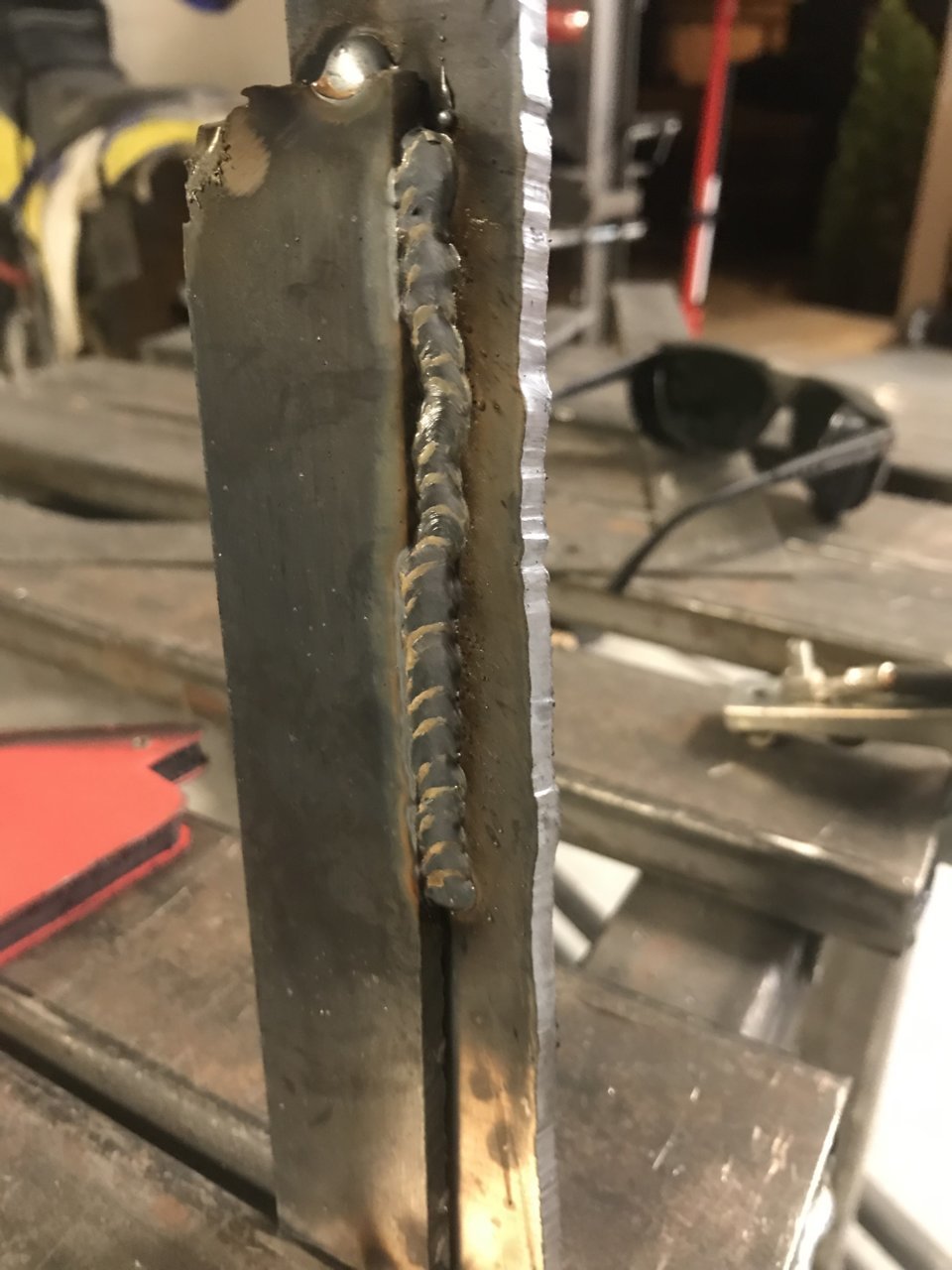

    This is vertical down. Ignore the top half of the weld. Haha.

    Bottom half looks good. Try it again with the heat up a little. I run a littler hotter

    I think we’ve got the same welder. Hobart 210? What settings do you run for 3/16 vertically?

    Yes we do! I run 5 and in between 50 and 60 on the wire speed for 3/16”
