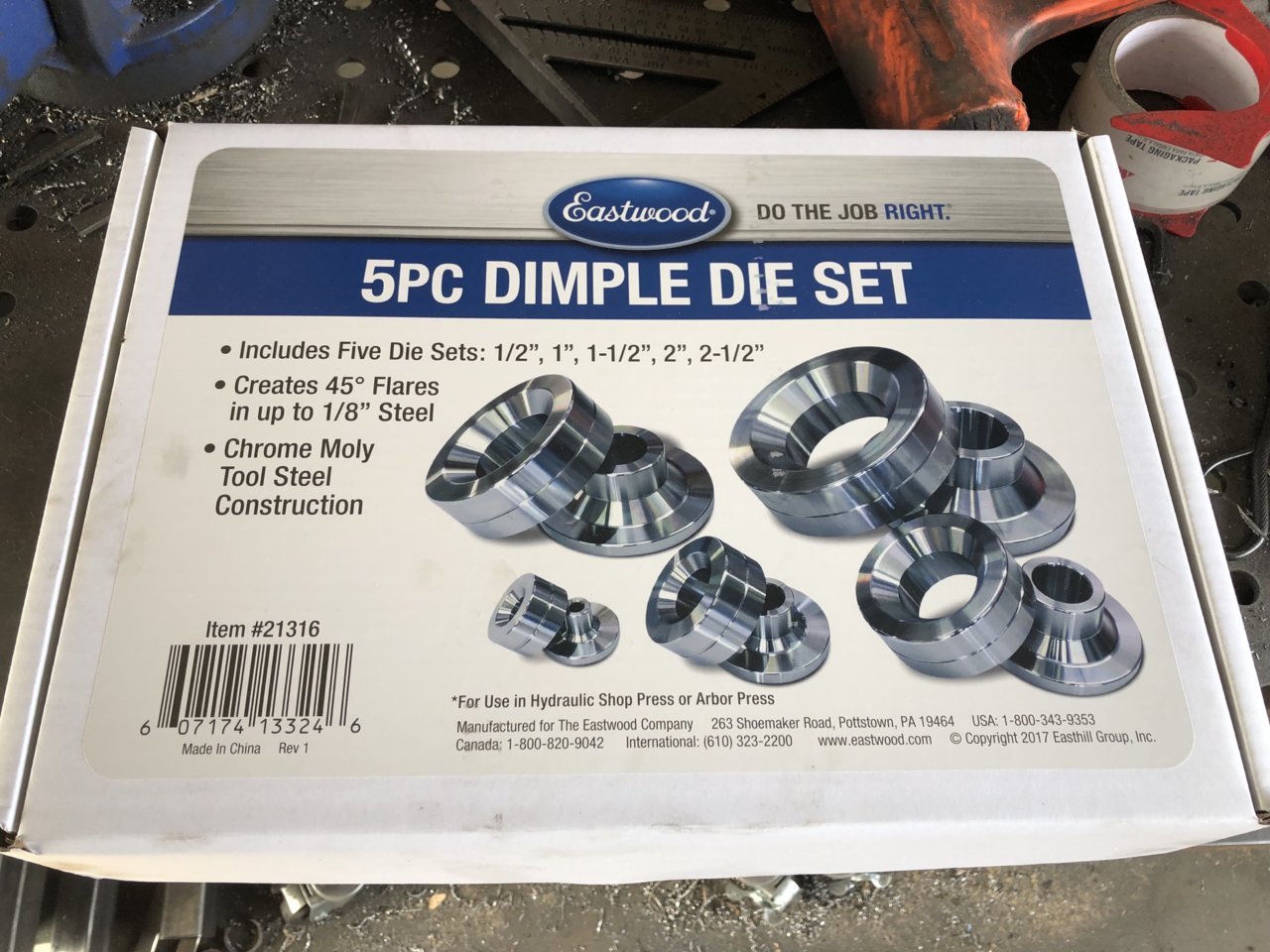

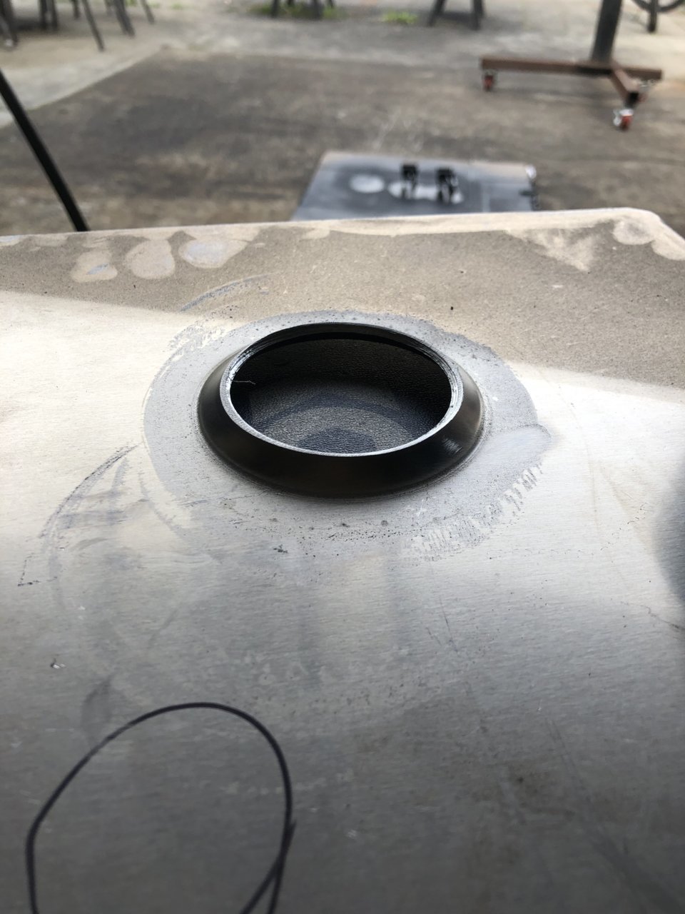

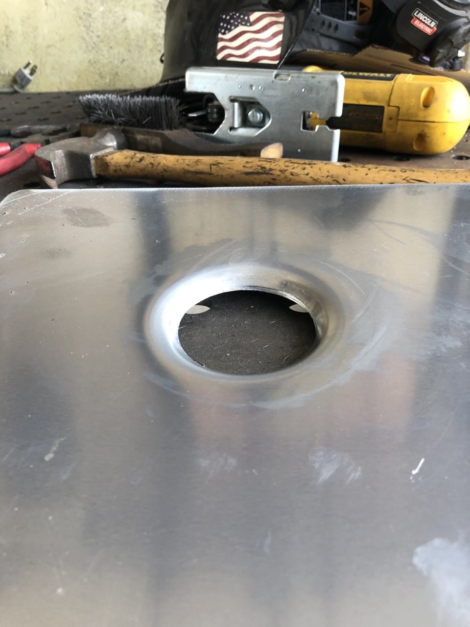

    Got my dimple die set delivered today from Eastwood. Quality looks great. I feel like they’ll last a while with the amount of use they’ll get. Of course I had to try out my new toy really quick. 1/8” aluminum with a 2” dimple die. Works really well. Very excited to be able to do some dimple dies in some things now. Save weight, looks good, adds rigidity back to the part.

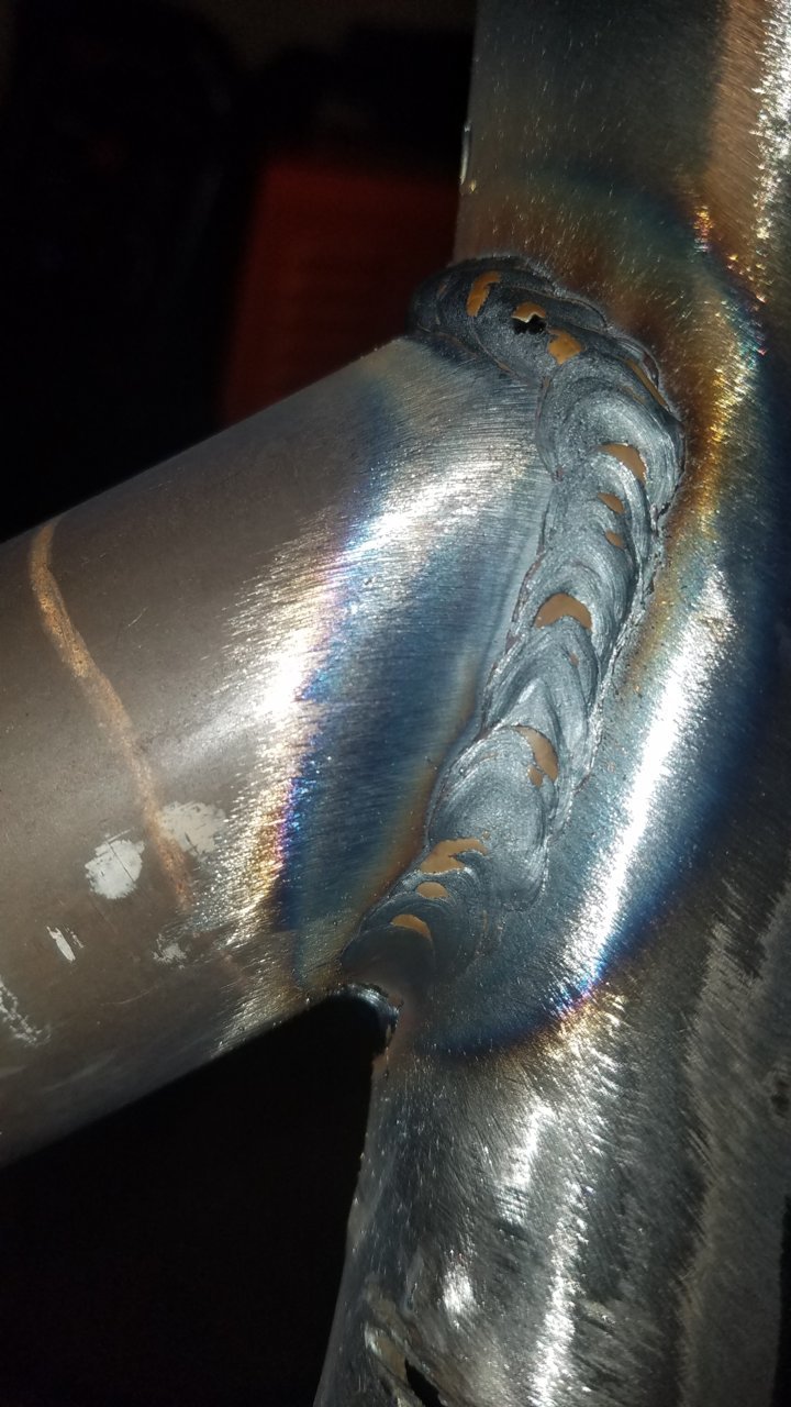

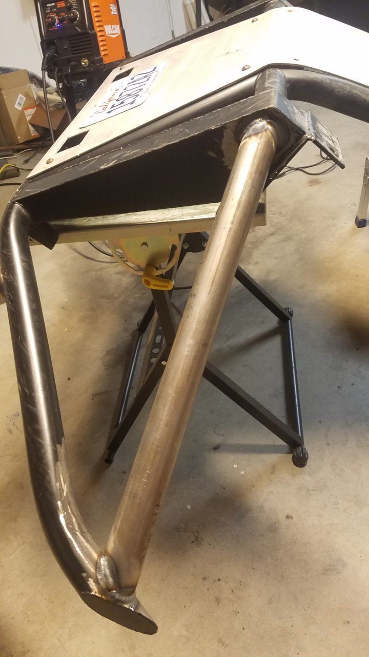

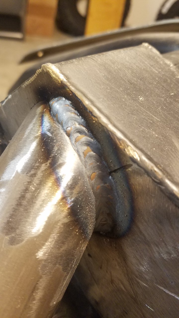

    Finally finished bumper re design project.

    Nice job dude!!!

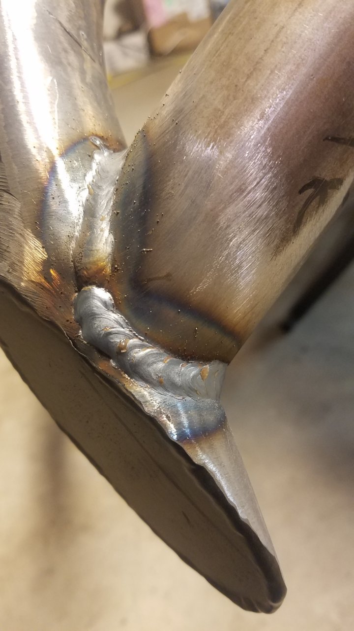

    That Viking welder makes some nice welds.

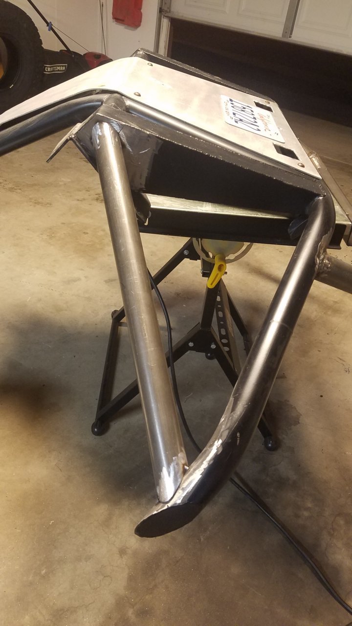

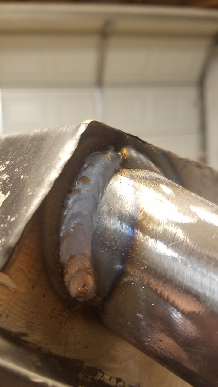

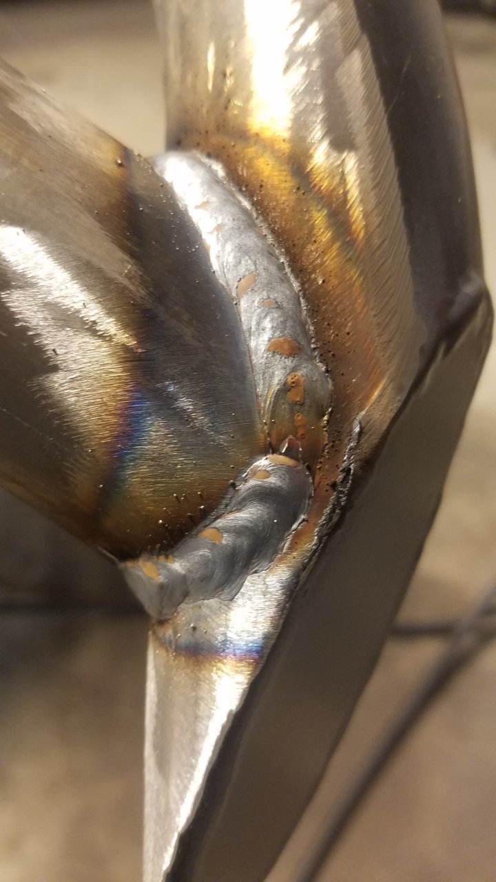

    Thanks bro, here's some more shots. Tight spots got tricky.

    "Vulcan" ? :notsure:

    Oops, got them switched around in my mind. Just woke up.
