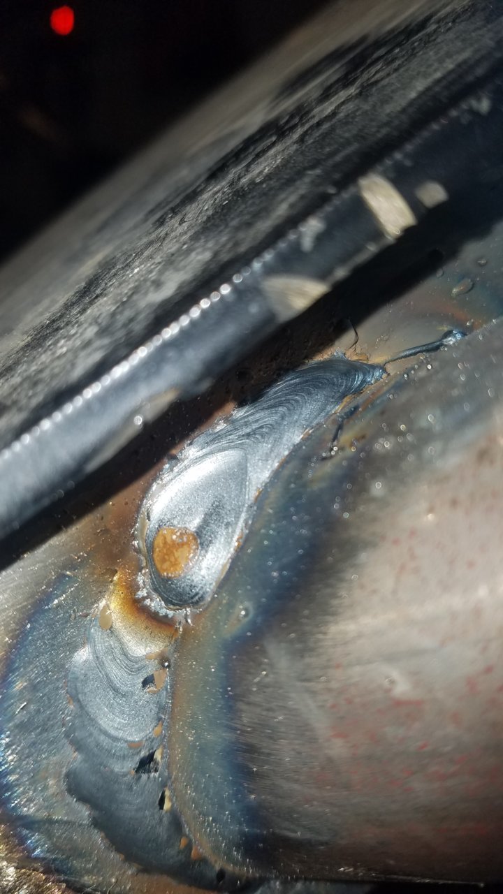

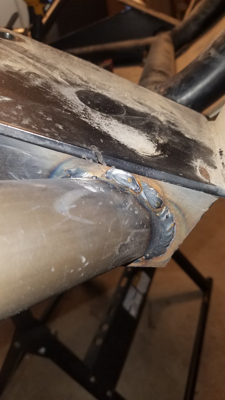

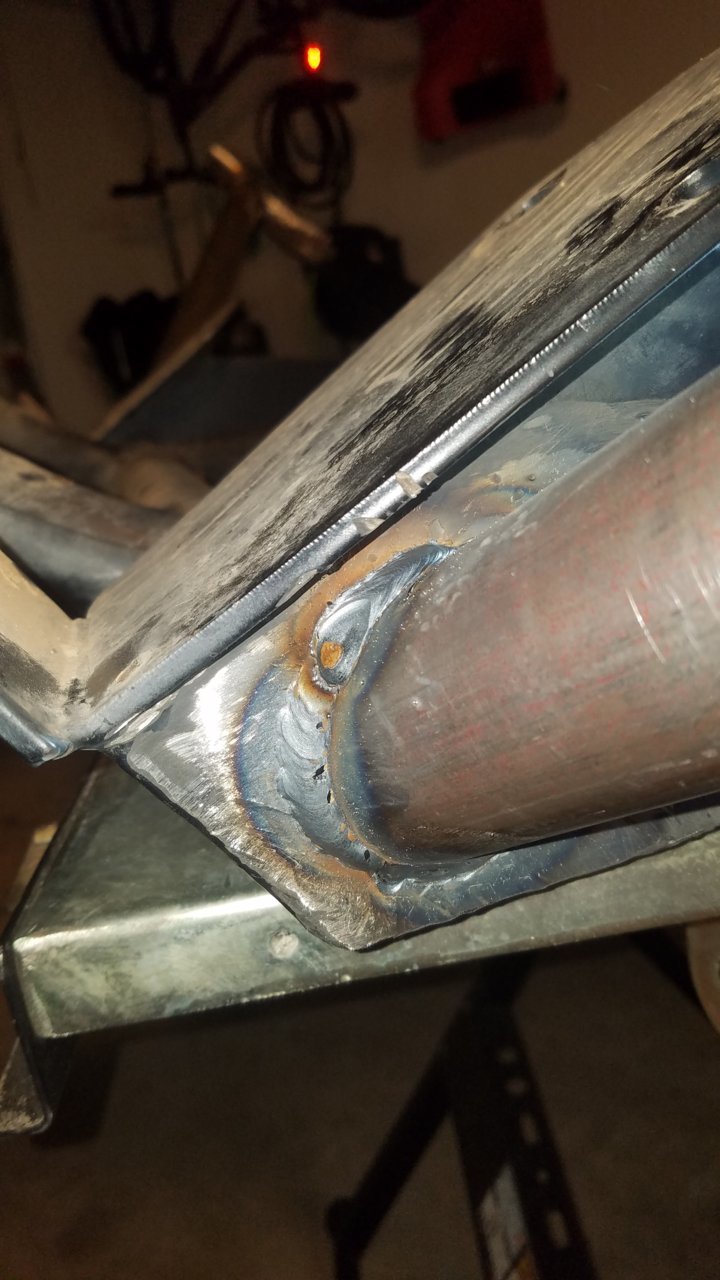

    Correct. I've owned the Vulcan welder for a year now. No issues so far. I've done plenty of stuflf on my truck with it. From welding light tabs to welding spring perches to re designing my front bumper. The machine has payed itself long time ago. I still can justify spending over 1k for a name brand. Here are some more shots from last night fun.

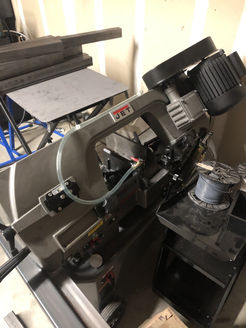

    6ABC5563-537C-442E-A492-B06926BA93AA.jpg It’s a brand new Jet 7 x 12 712D. Work was secure, no rust or cutting welds. I believe the variable TPI is to keep three teeth on the work at all time, across a variety of different metals and thicknesses. I don’t feel the machine was set up right, meaning it’s still not. The front and rear guide bearings aren’t always turning with the saw blade. I took some video prior to the blade snapping, it’s never sounded right. I’m out of commission until the new blade comes in. Jet customer support is amazing. Jet rep feels it was a bad weld on the blade but I’m concerned the tracking is off. This is a screen shot from a video I took. The blade is rotating but that front guide bearing isn’t.CA33E902-D0A3-4535-BE7A-7CE0923530AC.jpg

    If the tracking is off it will sure put tension on the blade.
    It should tell you in your manual how to adjust the blade guides.
    I buy the cheapest spray lube I can and spray on the blade guides when I use the saw in my case it can sit a week or far longer between uses.
    Being it is just me for the most my blades last very long I still have 2 spare blades never fails break one at the worst time.
