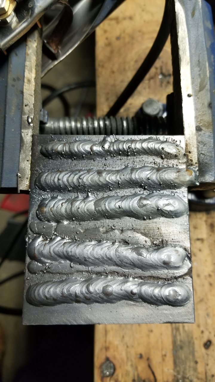

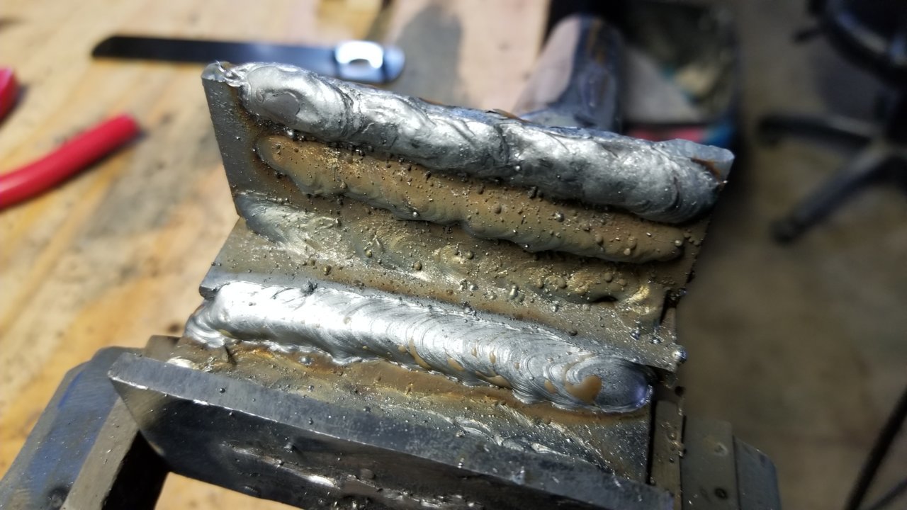

    PERFORMANCE Custom Turbo Setup FRONT SUSPENSION Drop Spindles by Aaron Carswell 01-04 Swaybar Endlinks Energy Suspension Endlink Bushings Cando Upper Control arms QA1 coilovers with 8" spring Custom 4 pot Brembo BBK Modified lower control arms with mjbfab qa1 mounting plates and Poly bushing sleeves REAR SUSPENSION Chasis Tech drop leafs QA1 adjustable shocks weld in drop notch Gas tank cross member bridge 3" angled blocks 2013 Double Cab Short Bed TRD Sport Eibach Pro Truck Shocks front and rear Lifted to the 3rd setting on the front shocks
    Got some more practice in today. Still not close to where I should be but I'm gonna keep practicing.
    jjsul, la0d0g, EatSleepTacos and 3 others like this.

    way to weld it to the vise :)
    Make sure to practice actual joints too though. Running beads on flat plate isnt the same as actually welding two things together IMO

    Lmao yeah I still dont have a table and this was the last of my steel just got too close to the vise haha. But I have been welding t joints I just didnt have any more pieces to weld together. Did this one today with to of the old t joints I had already welded up lol

    Looks good! And dont worry everyone has welded stuff to things they didnt mean to at some point in their welding adventures!
