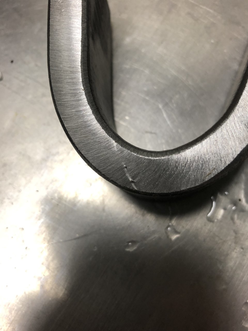

    DCFFEE4F-A8EE-4EED-8A9C-12386F2A8E2D.jpg Going for my first bend test for vertical MIG.

    65D728F5-740B-470A-9604-5E41FDB63A70.jpg Everything went well and nothing snapped but this lack of penetration failed me. It was my first attempt so I have some more practicing to do. I need three root and face bends in a row and then I can test for my vertical MIG certification.

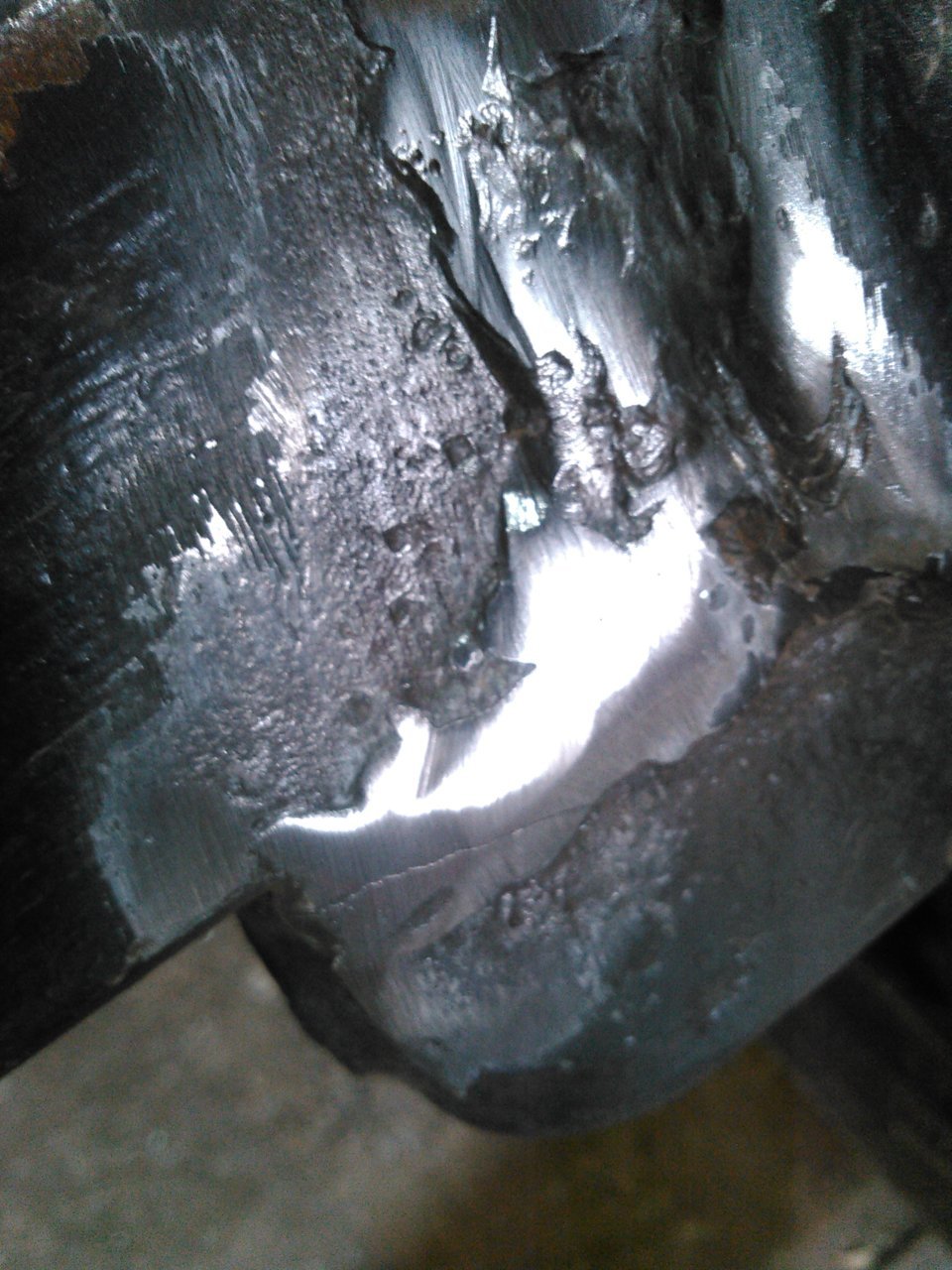

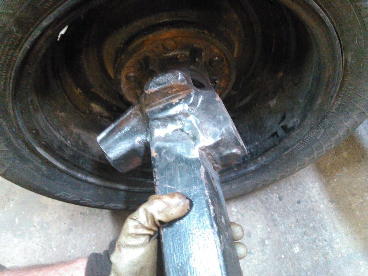

    I have a question for you guys:
    My father is building a homemade trailer and he welded two truck spindles/hubs to an axle (square tubing). His welds keep cracking as the metal cools off. Re-did them a few times with always the same result. It's been like 4 or 5 times now.
    What could be going on?
    wrong or bad welding rods maybe??

    What rods is he using?

    I don't think you can do a continuous weld. Too much cold mass on one side and not enough on the other. Try doing 1/4" or so welds moving from the start of the bead and to the opposite end of the bead. Doing this will preheat the 2 metals and reduce the shrinking of the weld that is causing the cracking.

    Could be a few things .
    First the wrong filler for the metals
    the difference in heating and cooling between the metals is to great
    either the filler or the dissimilar metals might want to try pre and post heating

    It's the difference in expansion between the solid spindle and the thinner axle tube. Also the weld is cooling off too fast due to the spindle being a heat sink. Definitely preheat the spindle before welding, and make sure it cools slowly afterward. Probably the best way to slow down the cooling would be to wrap it in rock wool insulation immediately after welding it.

    I've also heard that putting cast pieces in a charcoal fire (small hibachi grill) during welding helps. And you can make some hot dogs at the same time....

    he was using 7018 rod and he changed for 7014. Told me it's all good now. We'll see how it holds up
    If it doesn't, I believe it is because of the different alloys in both pieces, as the spindles do seem to have some % of cast iron in them. So the difference in expansion and shrinking is too large between the two pieces, resulting in cracks.
    If he has to do it again, he'll try preheating
