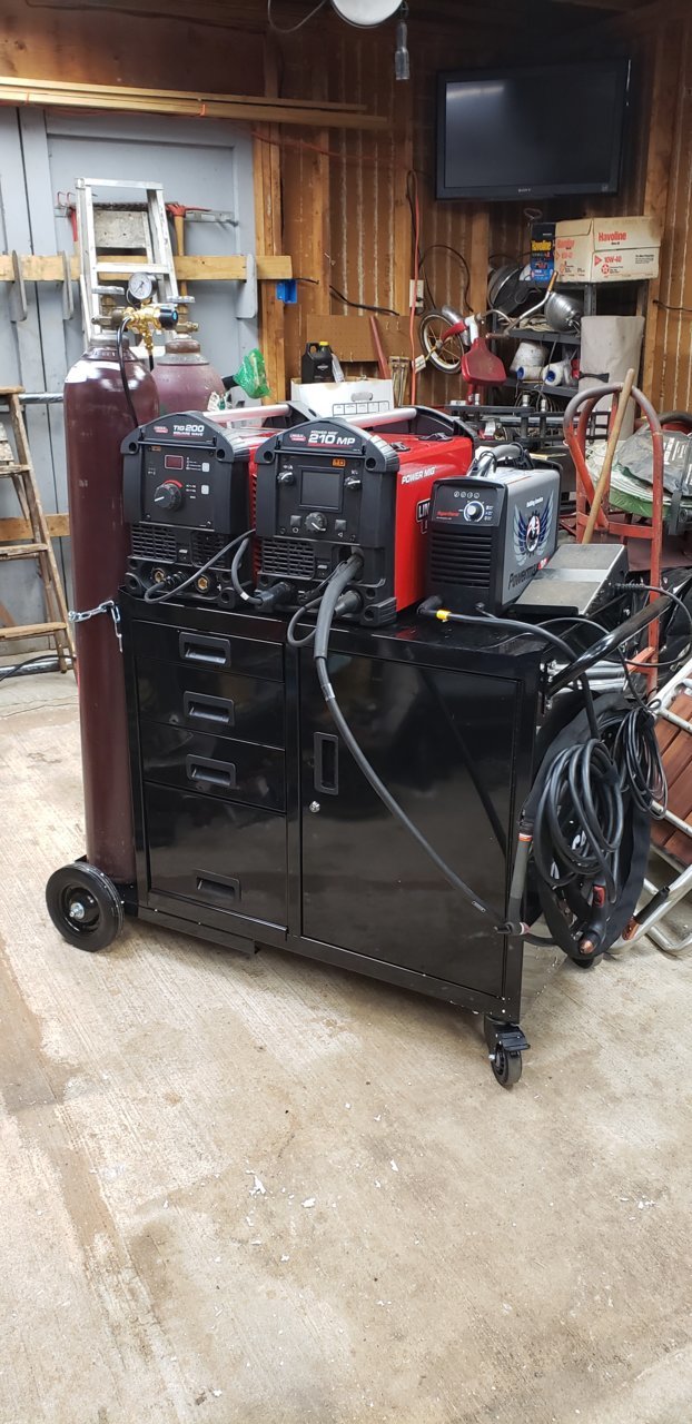

    New welding cart, Harbor Freight.

    Nice set up!

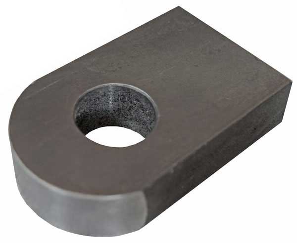

    I have a question for all the gurus.
    Been working on my front bumper made of 3/16” plate. I have some 3/4” clevis mounts that I’ll be welding in and would like some input to get reliable welds.
    Ive read about pre heating, beveling, and taking multiple passes to get a proper weld. Are there any other considerations to take into account?
    I have a Lincoln 180 w C25 gas and .035 wire.
  13. Jan 13, 2019 at 4:36 PM
    koditten
    koditten Well-Known Member
    Sep 8, 2013
    #112077
    19,761
    Kirk
    Central Michigan
    04 trd x-cab 4 x 4 3.4l
    Reserected from the dead.
    I really don't like surface welding big chunks of iron to thinner iron. Like you, I worry about pennetration and burn thru if too much heat is used.
    Is there a possibility you can cut out the shape of the clevice anchors and push them thru the sheet steel? You would only need a 1/4". You can weld both sides and I gaurantee the anchors will not pop off with a violent yank. The bumper will deform before the clevice and anchors become a projectile.
    Drainbung likes this.
  14. Jan 13, 2019 at 4:55 PM
    jjsul
    jjsul Well-Known Member
    Jan 14, 2015
    #146395
    1,648
    James
    New Hampshire
    95.5 OME
    Thanks for chiming in.
    The clevis does go through the bumper. The clevis’ are from Barnes 4WD.
    https://www.barnes4wd.com/Bumper-Clevis_p_279.html

    Yes, I have this clevis to mount. I will weld the front and back. I was planning to bevel the clevis where I would be welding.
    I am adding a brace inside the bumper like the one pictured above. It’s not exactly on a frame mount, but will be on the sturdy winch plate.
