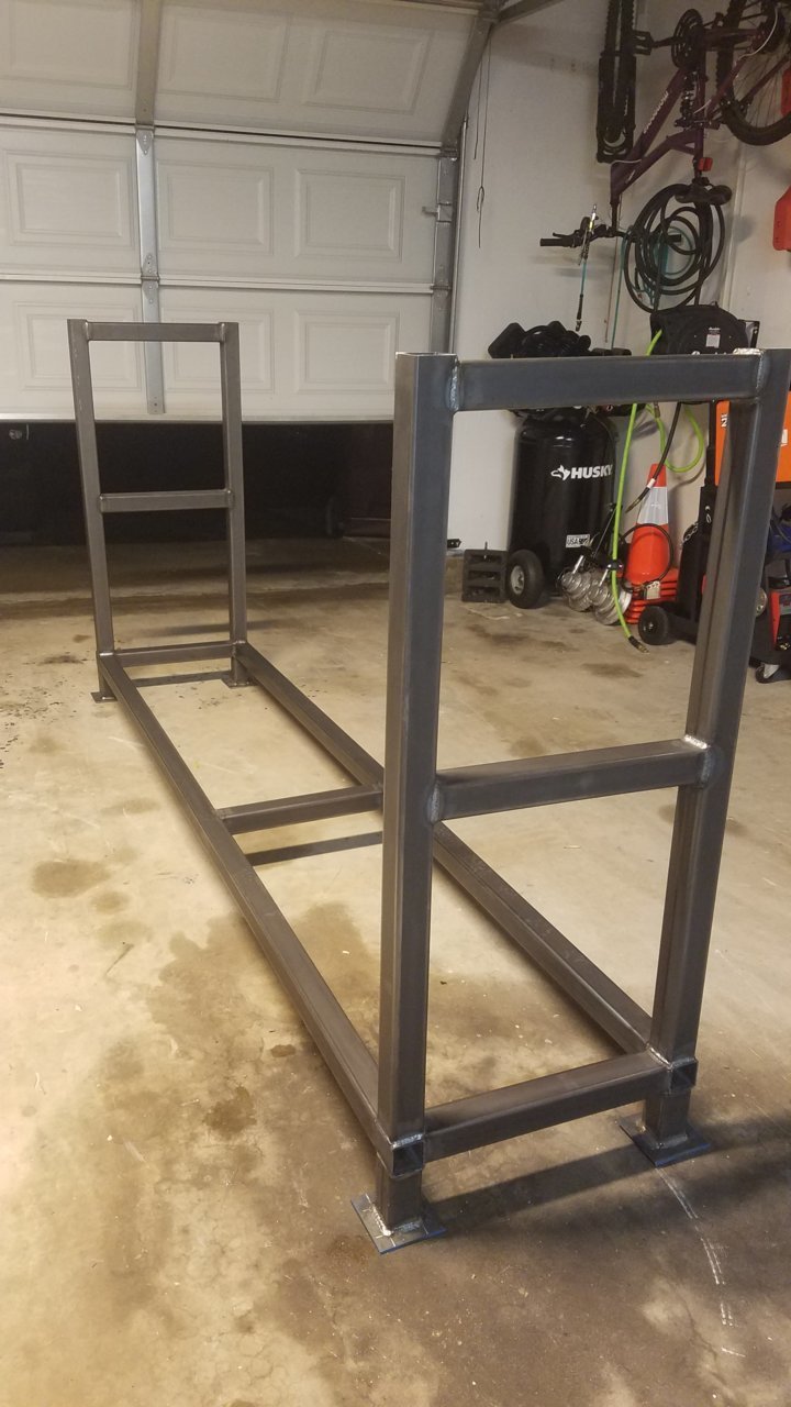

    Finished product before paint.

    Do you have weep holes at the bottom. No matter how good you weld it, condensation builds up. After a few years you will have a foot of water in the tubes. The following winter you will now have pipes instead of tubes.
    Ask me how I know.

    I do not. I will drill some. Thanks for the observation.

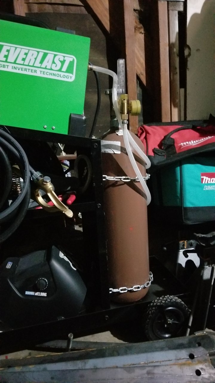

    Pelfreybilt Front Bumper,BAMF sliders, Airflow Snorkel,Mini D2S Retrofits, ADS Rear Shocks, Deaver U402 Leafsprings, 35s, AllPro +2LT
    i have a 40 at home now. 20 was way too small, that and i may have forgotten to turn it off. either way ive been getting in the habit of turning it off if im not welding again within a few minutes. making seat brackets is time consuming in between measuring/cutting/fitting

    Kings and a TW DECAL!!!
    I would always forget to turn my bottles off and found these things. https://www.valveview.com/
    Totally worth the money!

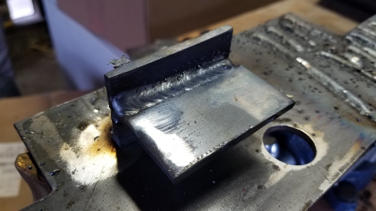

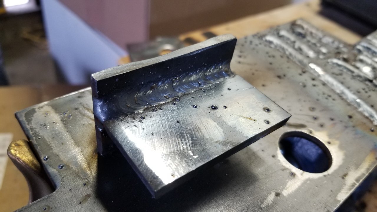

    Turbo'd 95.5 extra cab and 2013 Silver DCSB TRD Sport
    PERFORMANCE Custom Turbo Setup FRONT SUSPENSION Drop Spindles by Aaron Carswell 01-04 Swaybar Endlinks Energy Suspension Endlink Bushings Cando Upper Control arms QA1 coilovers with 8" spring Custom 4 pot Brembo BBK Modified lower control arms with mjbfab qa1 mounting plates and Poly bushing sleeves REAR SUSPENSION Chasis Tech drop leafs QA1 adjustable shocks weld in drop notch Gas tank cross member bridge 3" angled blocks 2013 Double Cab Short Bed TRD Sport Eibach Pro Truck Shocks front and rear Lifted to the 3rd setting on the front shocks
    Some more practice today. I really need to practice more often. Seeing some improvements but not exactly where I wanna be before I start building anything.
