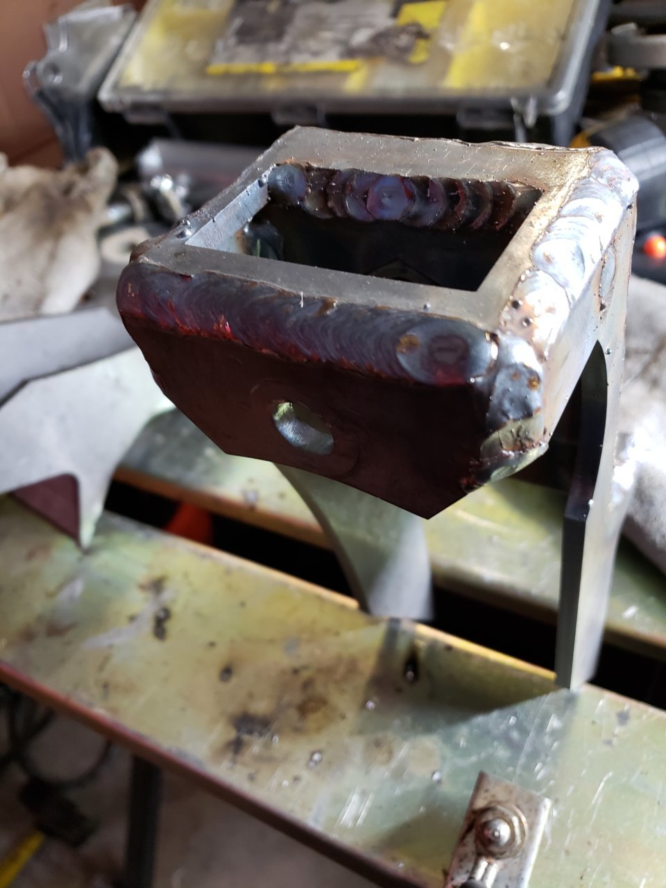

    Looks like it will hold.

    Welds look great man!

    I'm getting pretty good with it. Not a pro by no means but for basic stuff. Practice and lots of you tube videos has gotten this far.
