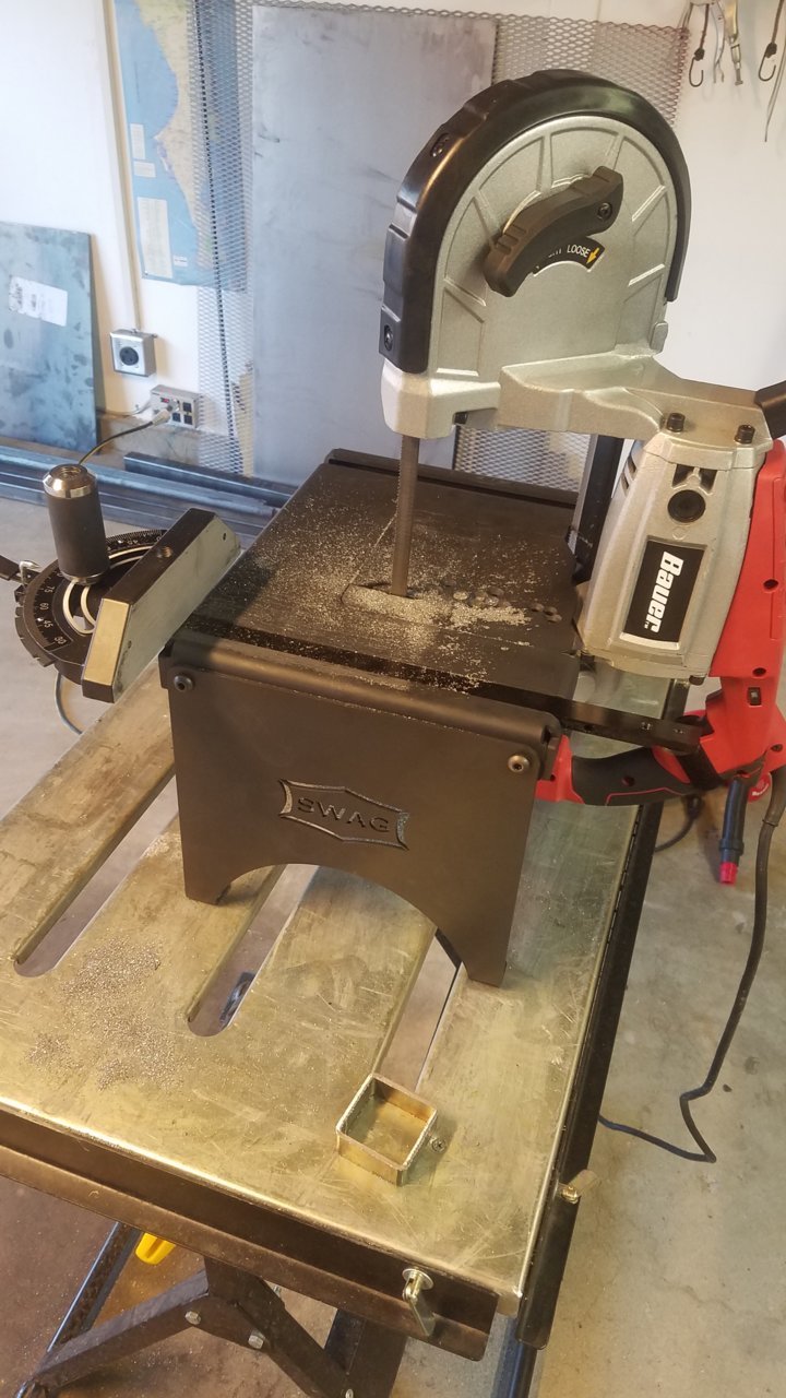

    I need to tweak this thing. Not cutting 100% straight. Then again I have to mount it properly. :facepalm:

    I don't understand the miter gauge? I see no way you can get a precise cut with that gauge. I think its more as a marketing gimmick. The saw will cut just fine freehand.

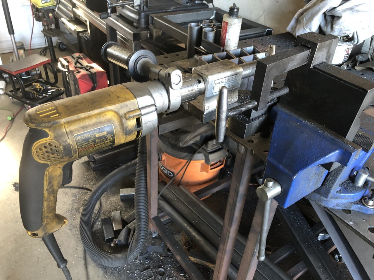

    I use this guy

    Any issues with it running at 850 RPM vs something closer to 500?

    Nope. Having the handle on the side makes it easy to hold on to in my opinion. I use Tap Magic cutting oil for every cut and use Lennox hole saws. Cuts easily

    Nice. That's definitely less expensive than what I was looking at. My biggest issue was really just overheating batteries and my only corded drill runs at 2500 rpm. Way too fast for steel. This should work great.

    In my opinion it works perfectly for the notcher!

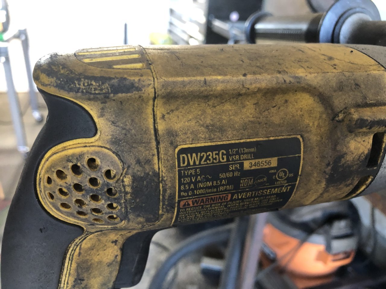

    Mine is the DW235G

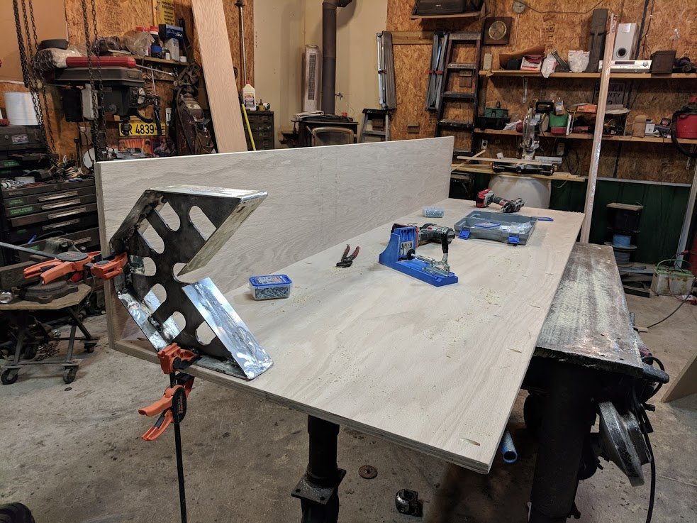

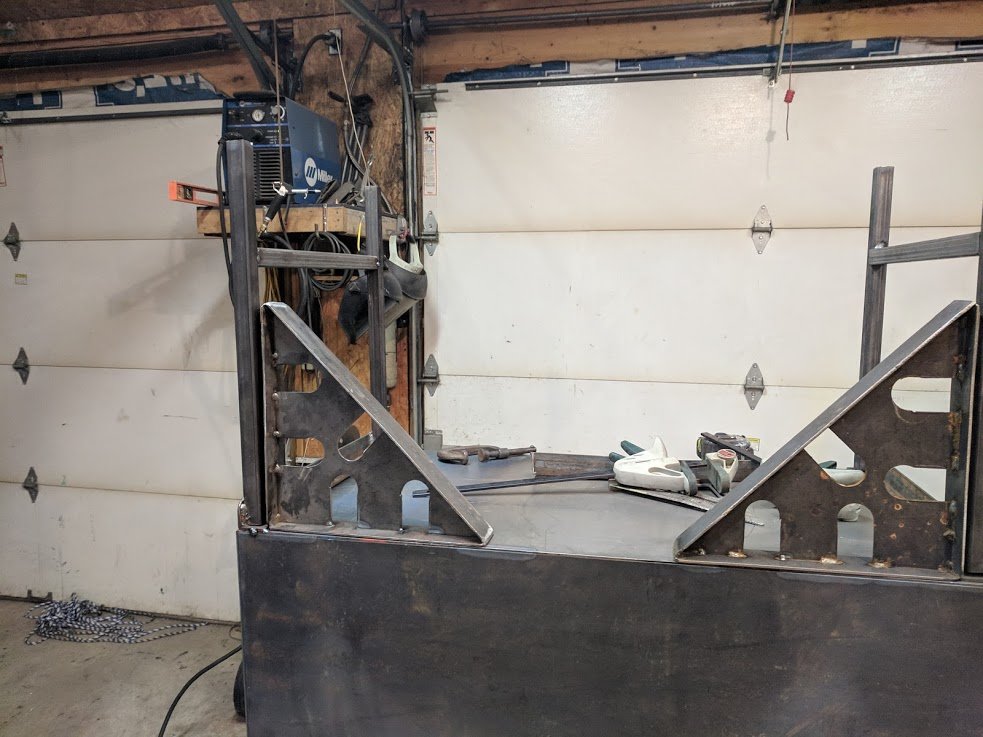

    These are my favorite fab squares. I use them for wood working as well as metal fabrication.
    I need to make some more, I keep giving them away.
