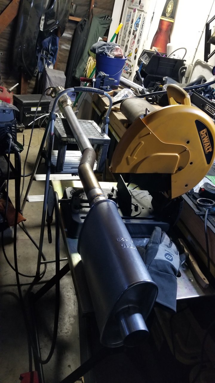

  6. Jan 12, 2019 at 7:16 AM

    Some sneak peek

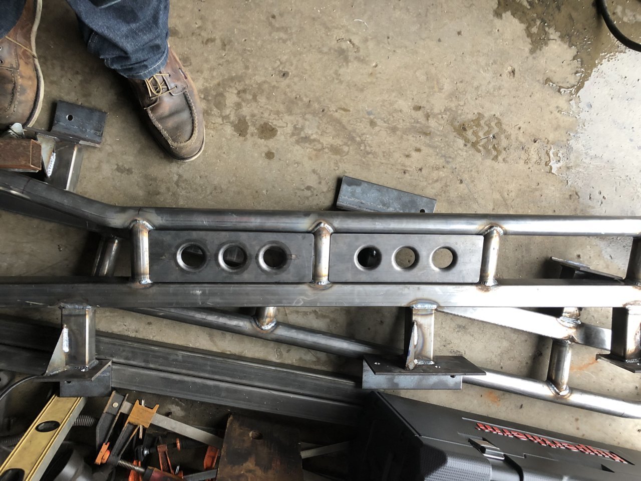

    I have a question for all the gurus.
    Been working on my front bumper made of 3/16” plate. I have some 3/4” clevis mounts that I’ll be welding in and would like some input to get reliable welds.
    Ive read about pre heating, beveling, and taking multiple passes to get a proper weld. Are there any other considerations to take into account?
    I have a Lincoln 180 w C25 gas and .035 wire.

    I really don't like surface welding big chunks of iron to thinner iron. Like you, I worry about pennetration and burn thru if too much heat is used.
    Is there a possibility you can cut out the shape of the clevice anchors and push them thru the sheet steel? You would only need a 1/4". You can weld both sides and I gaurantee the anchors will not pop off with a violent yank. The bumper will deform before the clevice and anchors become a projectile.

    Thanks for chiming in.
    The clevis does go through the bumper. The clevis’ are from Barnes 4WD.
    https://www.barnes4wd.com/Bumper-Clevis_p_279.html

    If you can try to position them so it hits the frame tie-in point (or anything else). Kind of like this sort of setup. Will give a bit more support to keep the plate from deflecting.

    Yes, I have this clevis to mount. I will weld the front and back. I was planning to bevel the clevis where I would be welding.
    I am adding a brace inside the bumper like the one pictured above. It’s not exactly on a frame mount, but will be on the sturdy winch plate.
