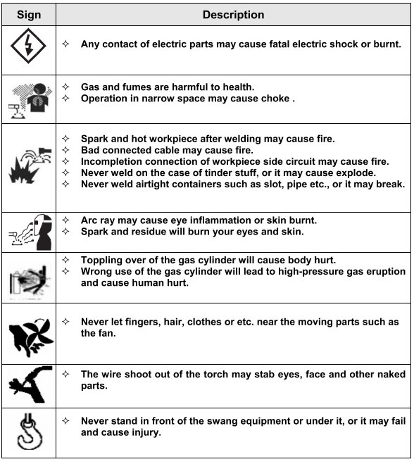

    Yeah the Weldpro is made in China. Here's an excerpt from the manual. The chenglish is awesome!
    I've always thought it would be a dream job to be the guy who draws stickman getting mutilated in all sorts of ways for the warning stickers.

    Hahahahahaha!! Toppling of gas cylinder will cause body hurt!!!! The wire shoot out of the torch may stab eyes!!!! :rofl::rofl::rofl:

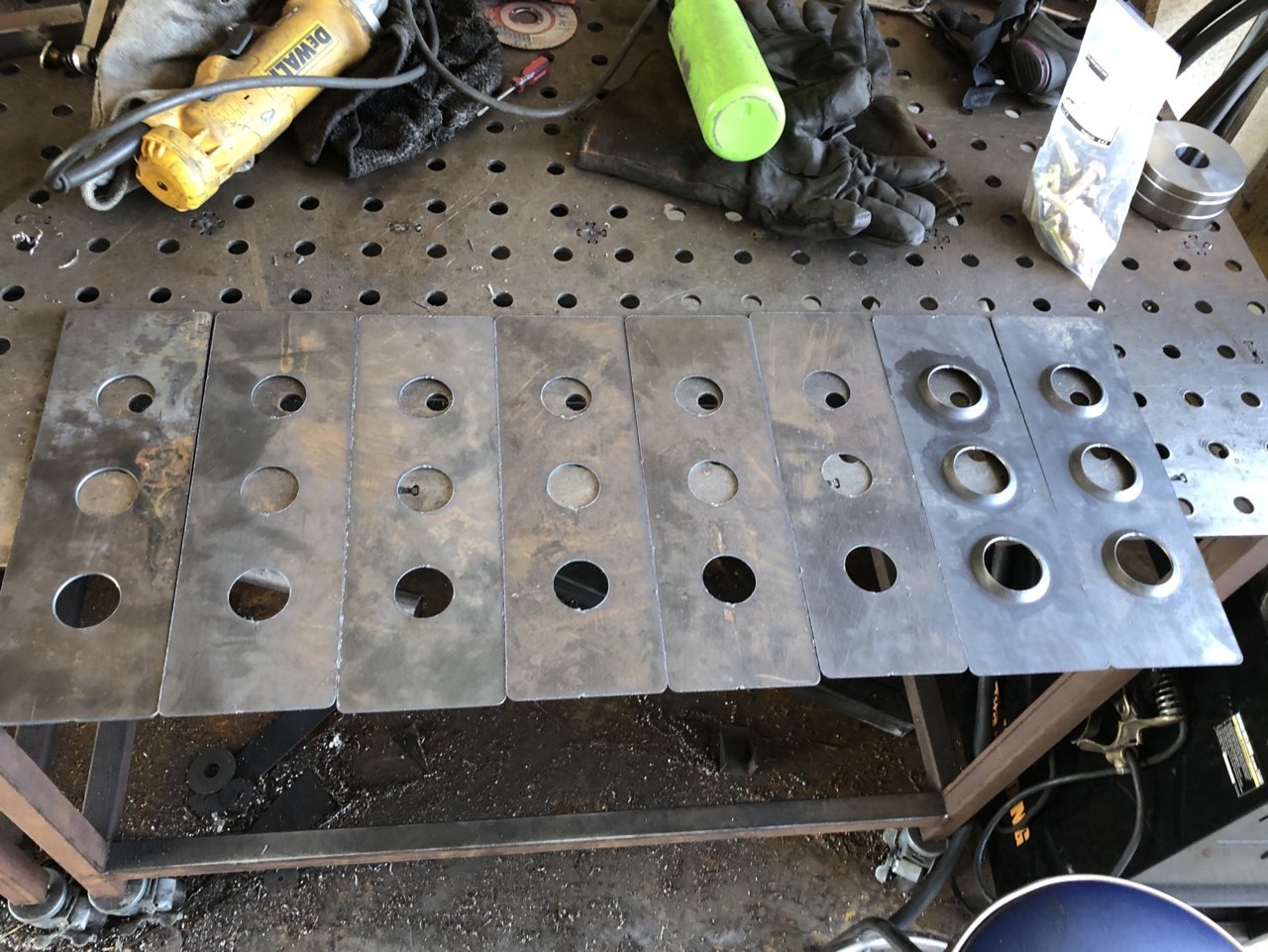

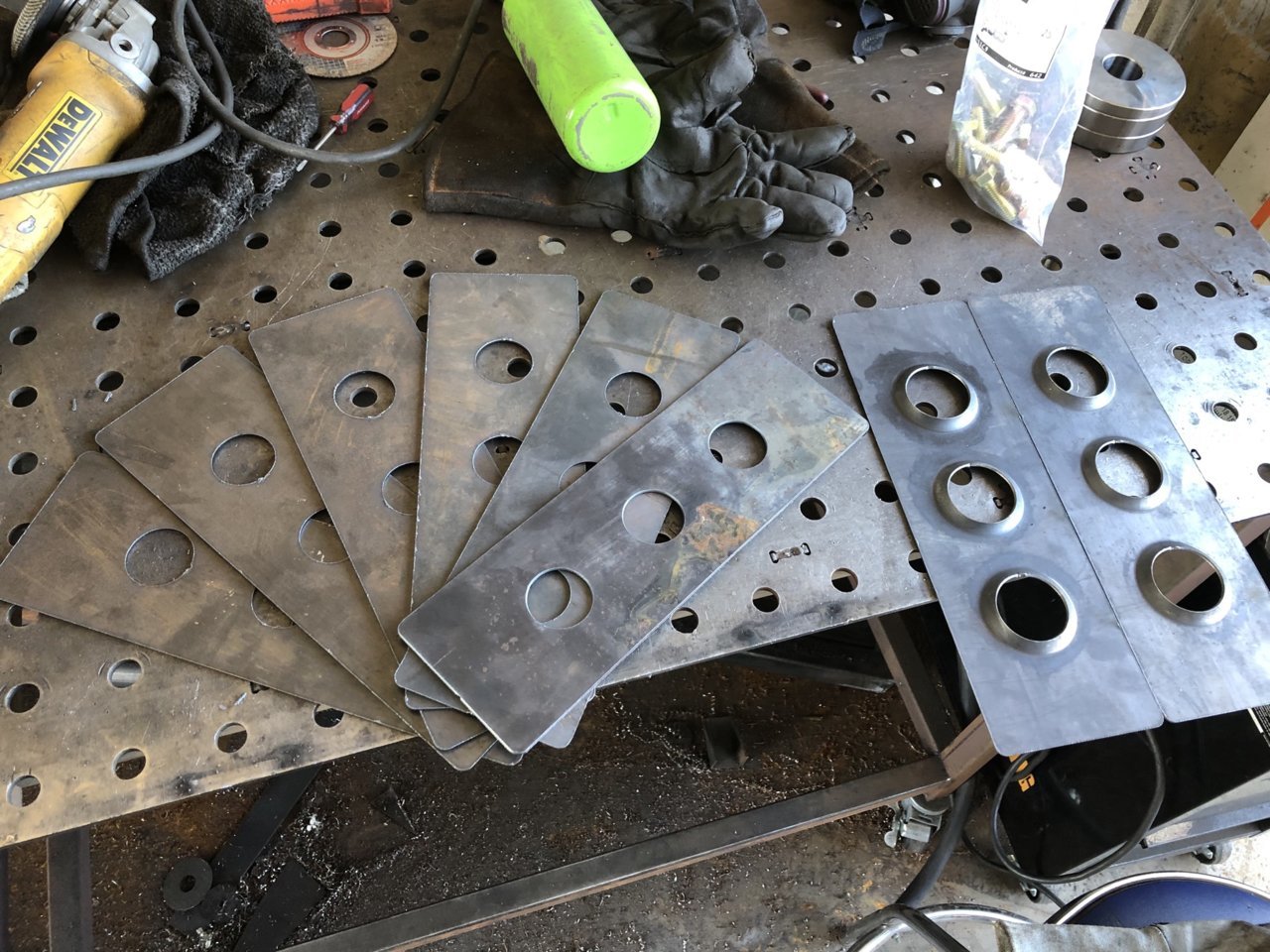

    Cutting out rock slider fill plates with the new plasma table! 30 seconds per plate on the table vs about 5-6 minutes per plate by hand

    Those cuts look pretty clean. Are you running torch height control?

    Naw it’s a pretty basic machine but badass. Only an X and Y axis. Manual heigh control but honestly with what I’m doing a Z axis would be pointless. The machine comes with shims to adjust the height. Those were cut with an 1/8” shim gap between the torch and material. 14 gauge sheet (.078). Very minimal dross on the back side. Using a Hypertherm Powermax 30XP
