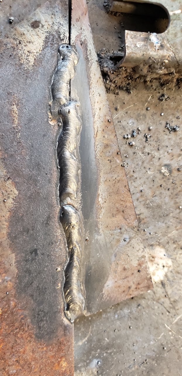

    20190222_125953.jpg So I have no idea what I'm doing......
    But the welder makes sparks, I didn't get flashed, nothing caught on fire, and the metal appears to be stuck together.
    :rofl::rofl::D

    Dragging .035 flux core through mig gun with no gas flat on a table.
    Think the settings were a bit hot/fast.
    First weld ever :bananadance::bananadead:

    Try pushing the gun. I do 90 percent of my MIG welding pushing the weld gun.
    jubei, FastEddy59 and Shmellmopwho like this.

    I thought with flux core that you'd get worm holes pushing.
  17. Feb 22, 2019 at 2:30 PM

    It's possible. It's just easier seeing the weld when push the gun.
    A little porosity isn't going to hurt anything.

    Personally I hate pushing. It just feels more comfortable and natural for me to pull a weld.

    Stick pull, mig push.

    Push = flatter, wider, less pen
    Pull = taller, narrower, more pen
