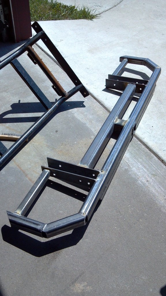

    The Hobart 140 is great. I was able to build this (all 1/4" wall) bumper using it (with flux core) without any problems. Some of it was multiple passes, but in most areas I used a heavy bevel and easily did it in a single pass.

    Did you go off of any plans for that bumper? Im very interested in creating something like that but im not really sure where to start.. do you have any pics of it in your truck?

    any pics of the finished project...? I am curious now

    Didn't go off any plans, but the finished 'look' is based off a couple trucks on TTORA.
    Some pics of the finished product on this page of my build
    http://www.tacomaworld.com/forum/1st-gen-builds/198660-45acp-s-divorced-build-18.html
    http://www.tacomaworld.com/forum/1st-gen-builds/198660-45acp-s-divorced-build-28.html#post5498827

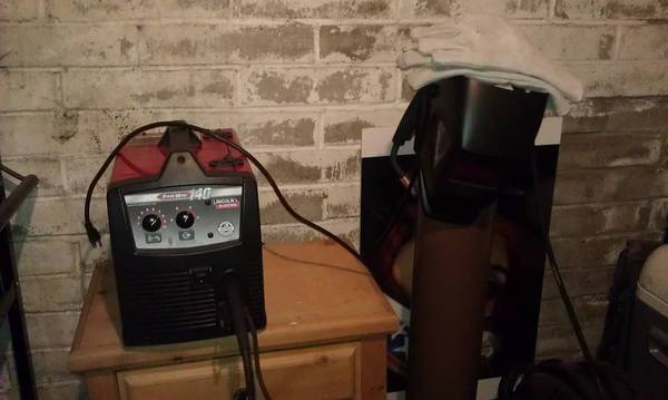

    Just picked up this Lincoln 140 MIG welder

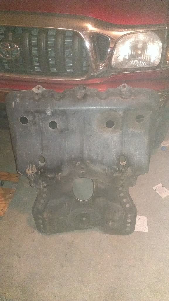

    Going to start building my front skidplate next week for my welding project at school. I have access to all the fab tools etc.. and i'm just looking to make the simplest possible design that will use something thicker than 1/16" steel to protect my front end and transfer case. Took my old one off and got a picture. IMAG0125_515bf66606c48cc0a6e8054e0500994ba264bed6.jpg
    Just looking for any advice as far as mounting and stuff from people who may have done this before. Will i be able to bend 1/4" steel or will i need to go with 1/8 or 3/16". Thanks TW

    3/16" is more than enough for the front skidplate. Anything else on the belly I'd use 1/4". I run a 3/16" budbuilt front skid and it has held up really well under heavy abuse. The 3/16" belly pan on the other hand is a raisin at this point. Bending shouldn't be much of an issue. Box Rocket, Slodgetto and others have used the 'whiskey bend' method that seems to be pretty effective.
    http://www.pirate4x4.com/forum/toyota-tacoma/1063350-skidplates.html

    I made a ifs skid last year for my 2nd gen, used 3/16" and the same bending method as posed above, i use it to jack my truck up from without any issues.
