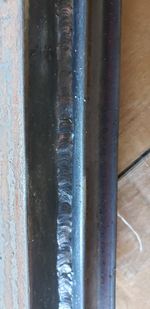

    Still struggling a bit with stick but the wire feed is getting better....20190309_161810.jpg

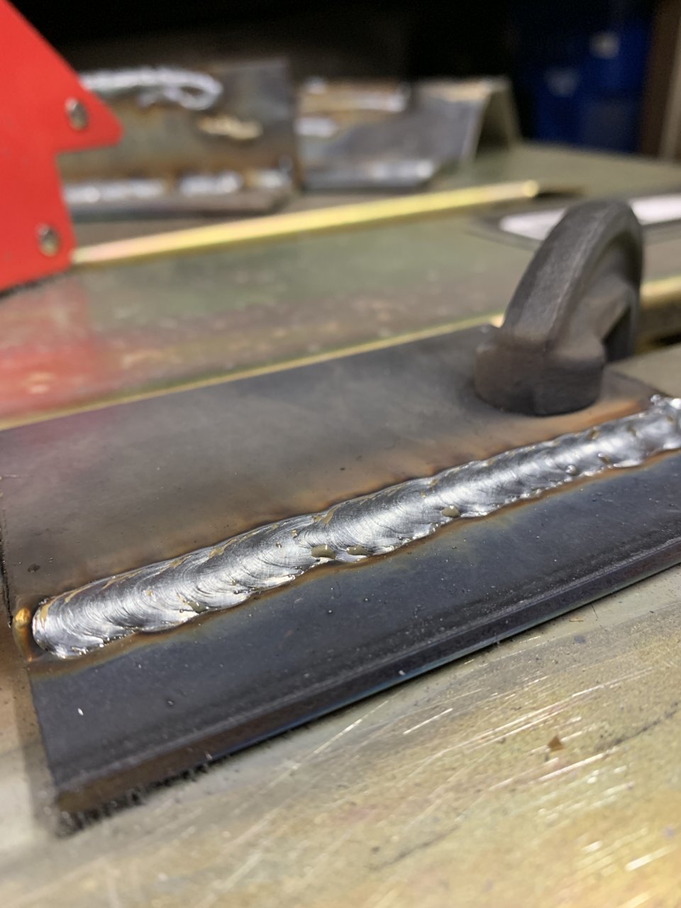

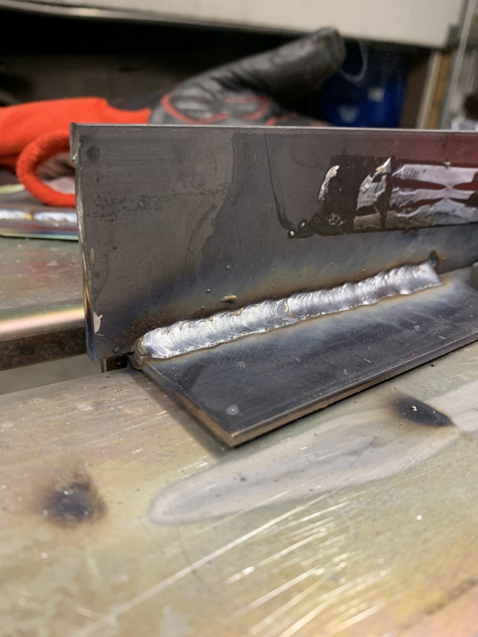

    Icon Extended Travel, SPC control Arms, OME Dakars, B110's

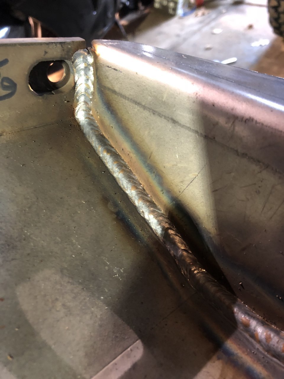

    First night having a welder. Can anyone look at these and possibly let me know what I’m doing wrong? Tips and tricks?0F5F802C-70E3-4803-8245-3BA1F7EAACE6.jpgE940A256-D208-4BF9-9B84-35ACCD454A80.jpg34585CF0-C19F-4FFD-8395-3DB20BC4372A.jpg

    I'm still quite a noobie, but those welds look pretty consistent for your first night out. Nice
    I think they're cold? The toe of the welds look raised and the discoloring seems to be lacking. Try a bit more amps and a bit faster?

    A bit too much wire feed rate. I like a flatter weld. Might need to up the heat as well.
    If you cut a weld you will likely see that you don't have great penetration. You are caulking with a welder.
    For a 1st time I think your welds look very good.

    Thank you guys. That’s kind of what I was thinking also after looking at more welds. Going to get some more practice in tonight. Will keep these in mind
