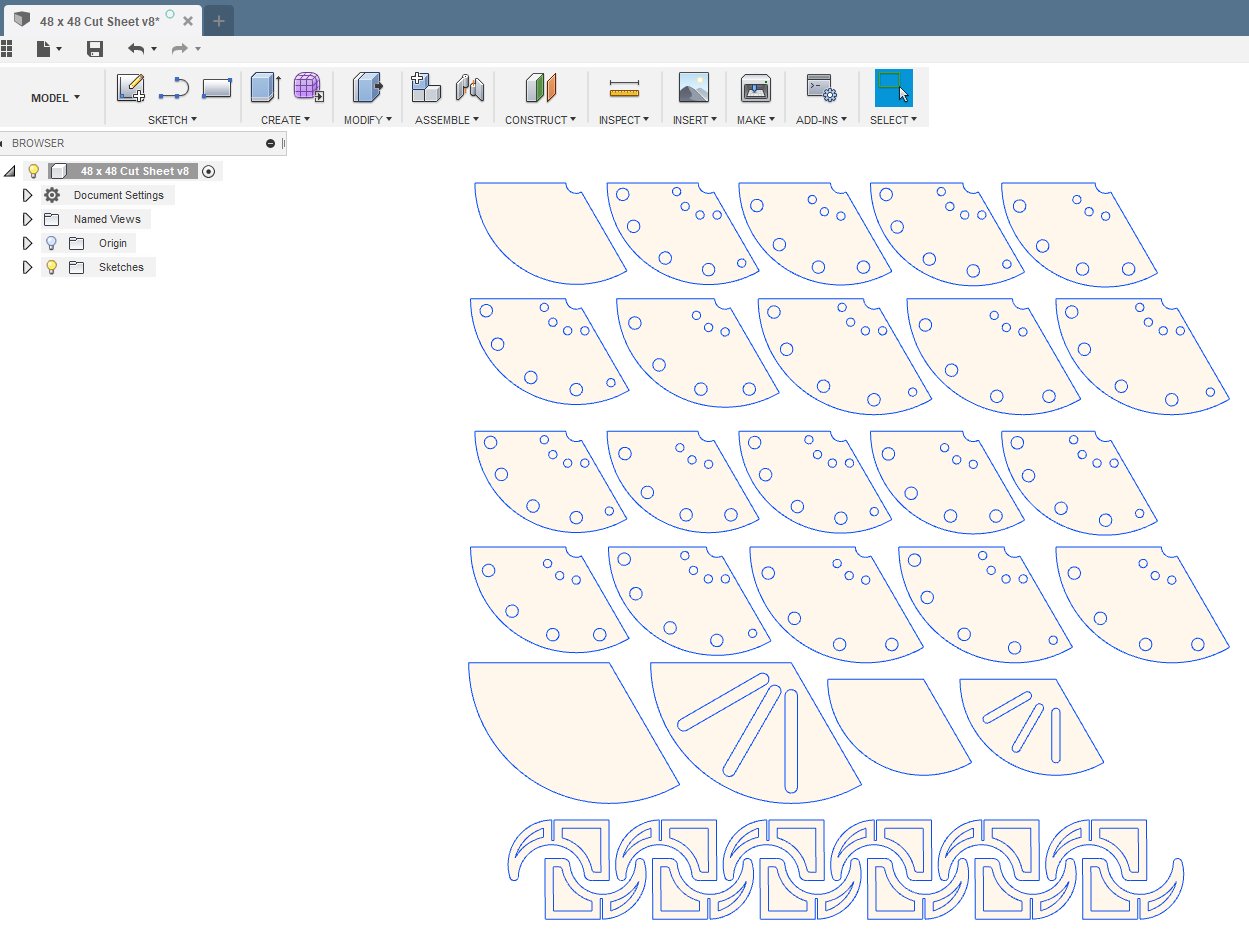

    I most certainly do.
    Designed fully in Fusion 360

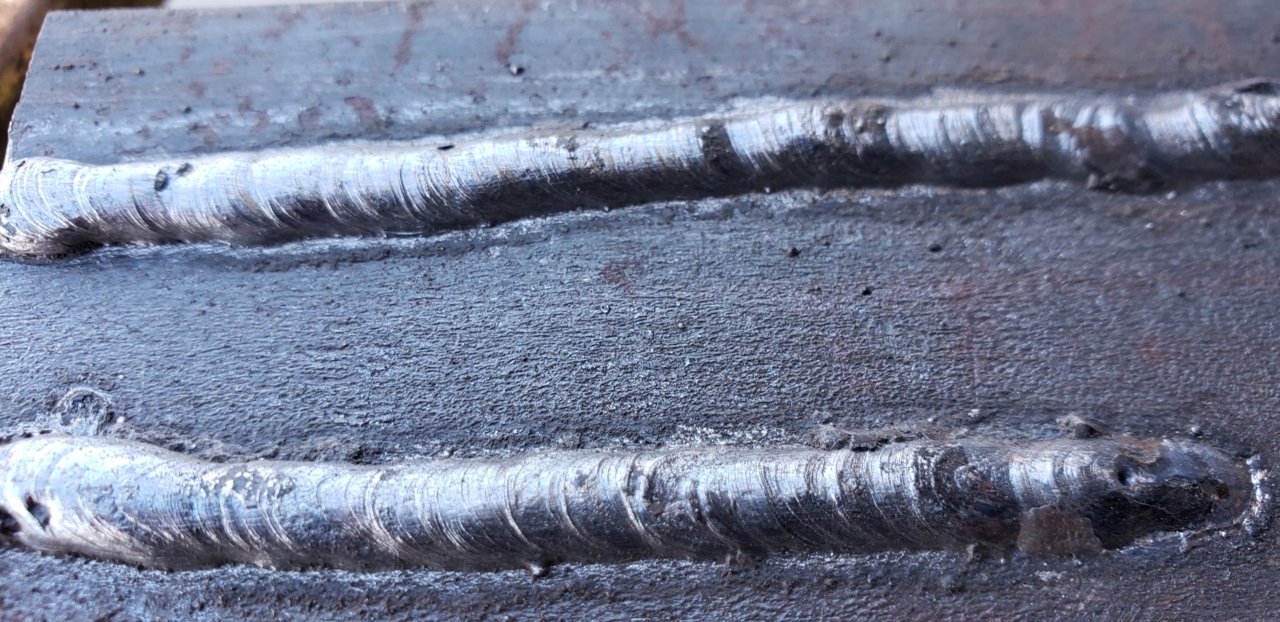

    Drop bracket lift and booger welds
    What rods are you using? Those look great!

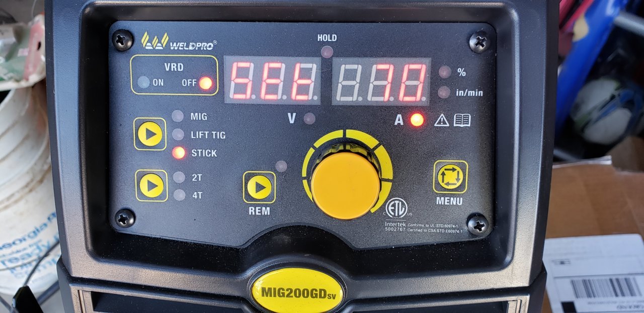

    I can finally participate in this thread. I have only welded mig before a few times using my friends machine, saw this on Craigslist for $60 and scooped it up. Between the welder and 15lbs of rods I'm only $100 into it. Really want to get good at it before I take on some of my smaller projects I have set aside. I figure if I can get this down, I can transfer some of the skills I learn (like patience lol) when I get a nice 220 Mig setup one day.
    [​IMG]Garage update by Michael Halat, on Flickr
    Here are the first beads at 75 amps on 6011.
    And at 60 amps:
    I clearly have a lot of practice ahead of my but I'm stoked to get going. I jumped too fast from laying a bead to trying to join two pieces together IMO. I need to practice lighting the arc a bunch first, I'm like Michael J Fox trying to get a bead going. Once it's going I can see the pool and what not, but striking the arc was very frustrating at first. So I figure I'll give a solid start stop practice, then move to filling a coupon with beads, then work on joints. I feel if I said fuck it and jumped into a project, it's going to turn out like shit.

    7018 I think?
    Nice score on the welder!

    Congrats on the rig!
    I first self learned on a stick, Great skill to have. I forget my exact method of striking an arc, but I do remember sometimes knocking off some of the powder on the sticks so that I could make a connection to my work ( right or wrong, that's what I did ) Also some one passed on to me some tips to keep the spatter down. when you are ready to work on a project, pick up some nozzle spray ( not gel ) and spray your work and surrounding area ( what you think will get spatter ). most of the spatter will just fall right off, and you can weld through the spray ( some one please pipe up if this compromises the weld, I'd hate for some one to take my advice and build something structural / life dependent and have it fail )
    doing those two things I was able to produce some decent welds that are still holding up today ( 10+ years later )
    Good Luck! and keep posting pics!
