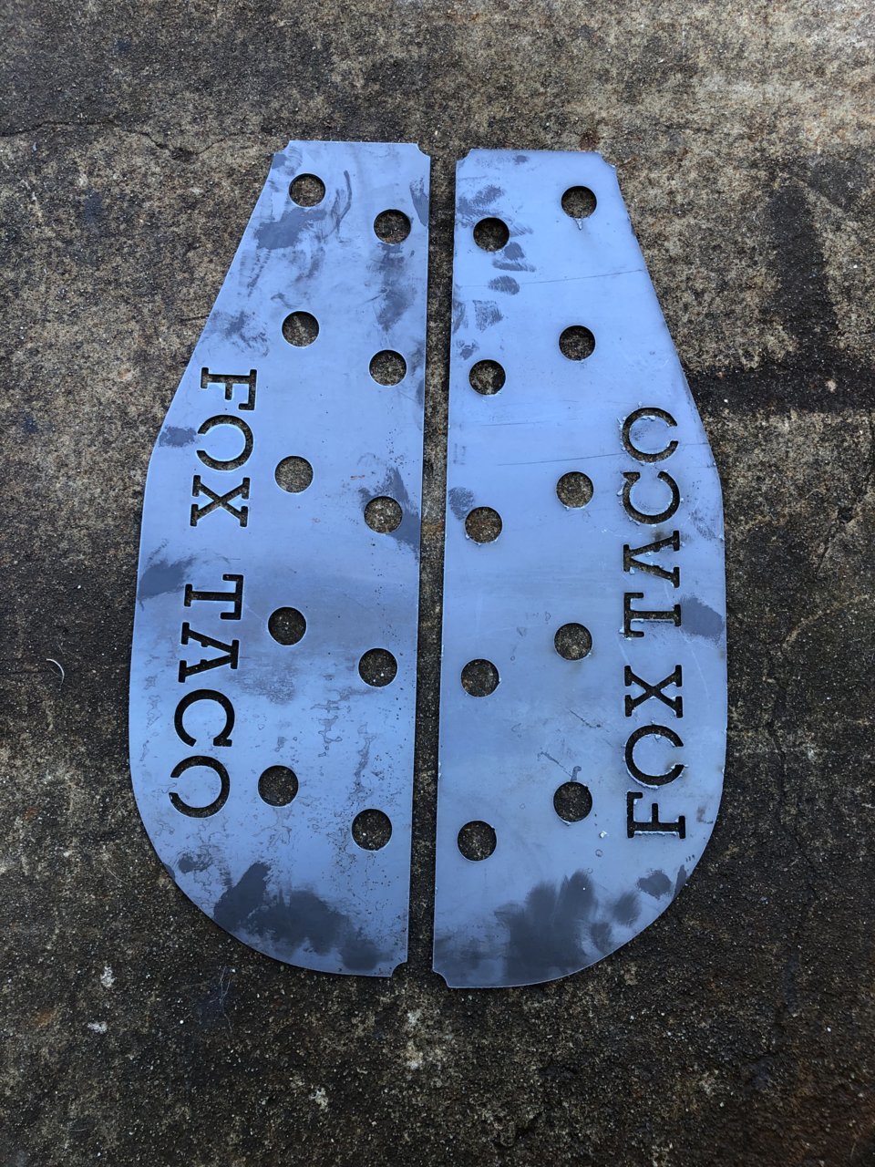

    Special request for some customized fill plates for a member here. Still have to knock off the little dross and dimple the holes

    Thanks buddy!! Having lots of fun with this plasma table!

    Which plasma did you get?
    Shmellmopwho[QUOTED] likes this.
  18. Mar 12, 2019 at 11:45 AM
    Shmellmopwho
    Shmellmopwho Well-Known Member Vendor
    Apr 10, 2014
    #127399
    11,663
    Lomita CA
    2013 White DCLB TRD sport
    Bunch of stuff
    The plasma cutter is a Hyperthem Powermax 30 XP and the table is a Langmuir Systems Crossfire
