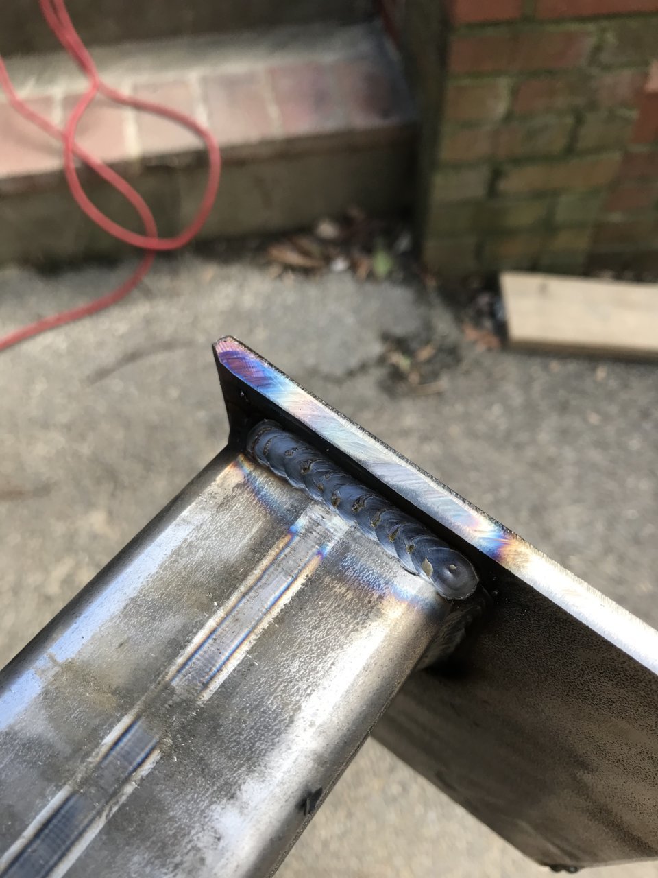

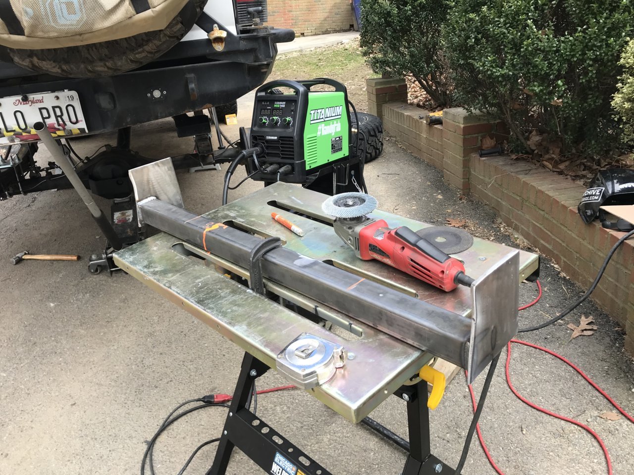

    Anytime I’m talking with anyone about welding, and they’re like “well I wanna get a welder and learn how to weld, but I just don’t know what I’d do”, it’s stuff like this. I’ve done so many misc little bullshit projects where it’s nice to be able to weld. Sure some things could get by without it, but it’s in my top favorite purchases that’s truck related.

    What's your gold in the 2nd pic? air tank?
  9. Mar 13, 2019 at 12:59 PM
    EatSleepTacos
    Mar 24, 2015
    #151688
    59,835
    Randy
    West Valley, AZ
    2017 4Runner
    Resi brackets

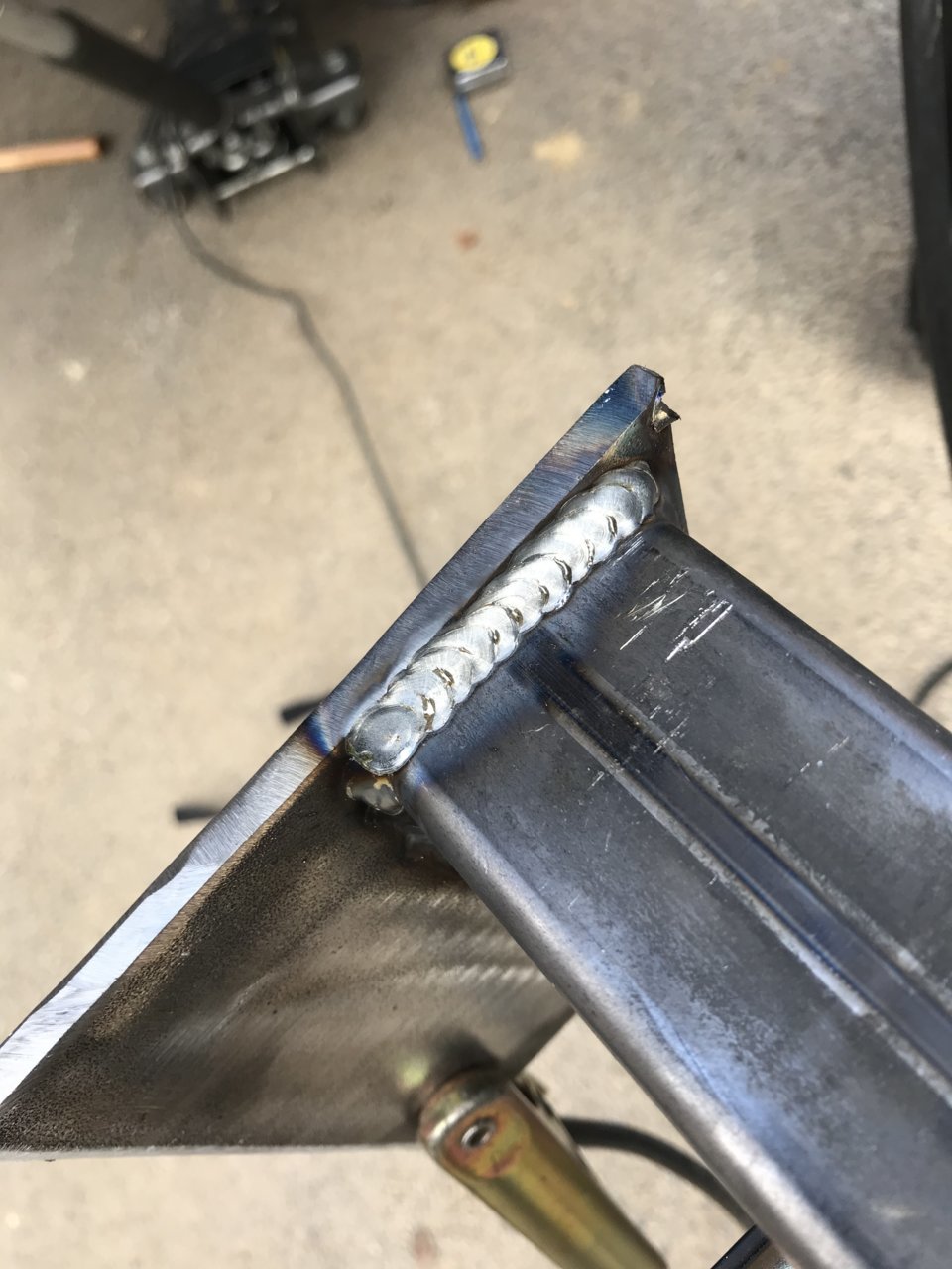

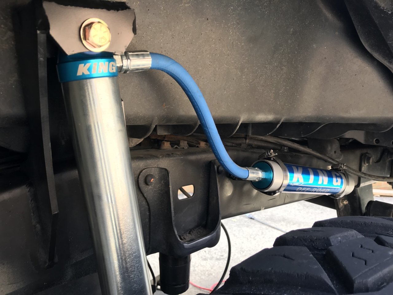

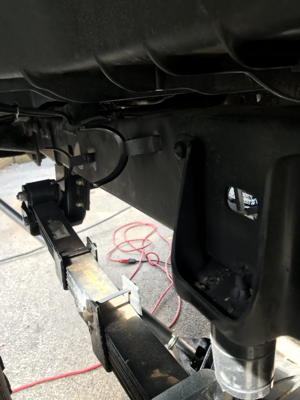

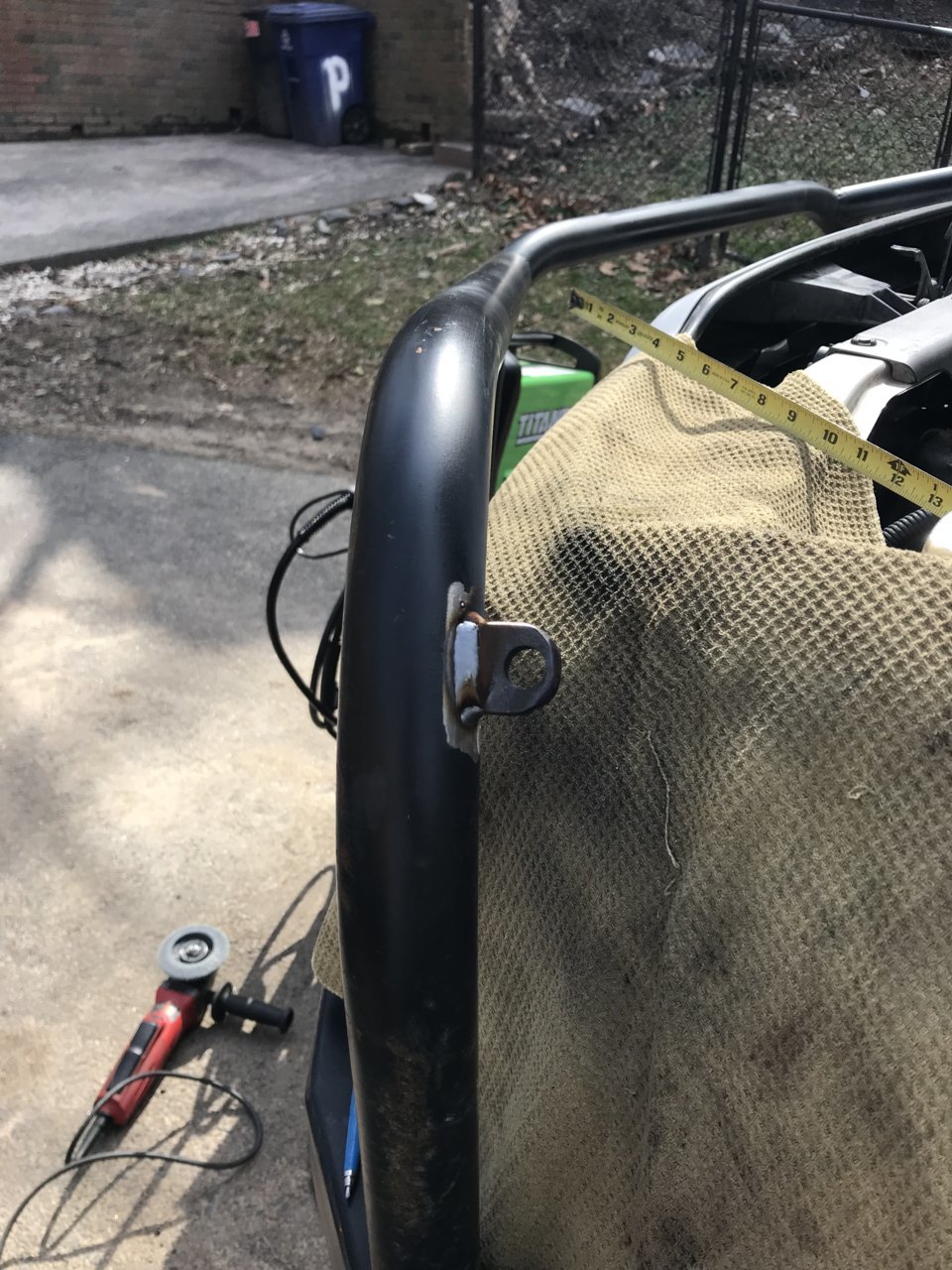

    Did some more welding today. It’s just such a nice day out so I’m knocking out a few projects. This has 1/4” plate on the sides and 2” square tube, 1/8” wall. It will be for the adjustable upper limit strap mounts. Most people don’t bother adding limit straps but it’s cheap insurance.

    cant remember is that machine 220 for those? they look great. i need to start practicing more and finally install my frame plates

    Shocks are natures limit straps, change my mind.

    110! Works really well. Thickest I’ve done is 1/4” and it handles it fine.
    Haha get outta here. I’m fine with spending $120 on limit straps to protect my expensive new shocks.

    wow thats awesome. i might just need to mess with mine more. the hard settings for voltage and wire feed seem to be either too much wire or too little based on voltage.

    I’ve been going off the welders recommended settings and it’s been awesome. My go-to settings are 260 ipm, 18.5V, .030 wire, and C25 gas at 20CFH. That seems to be the sweet spot for most everything I weld.

    mine are 1-4, lol. i did print the welders guide though. it sounds like the right sizzle. i probably just need practice

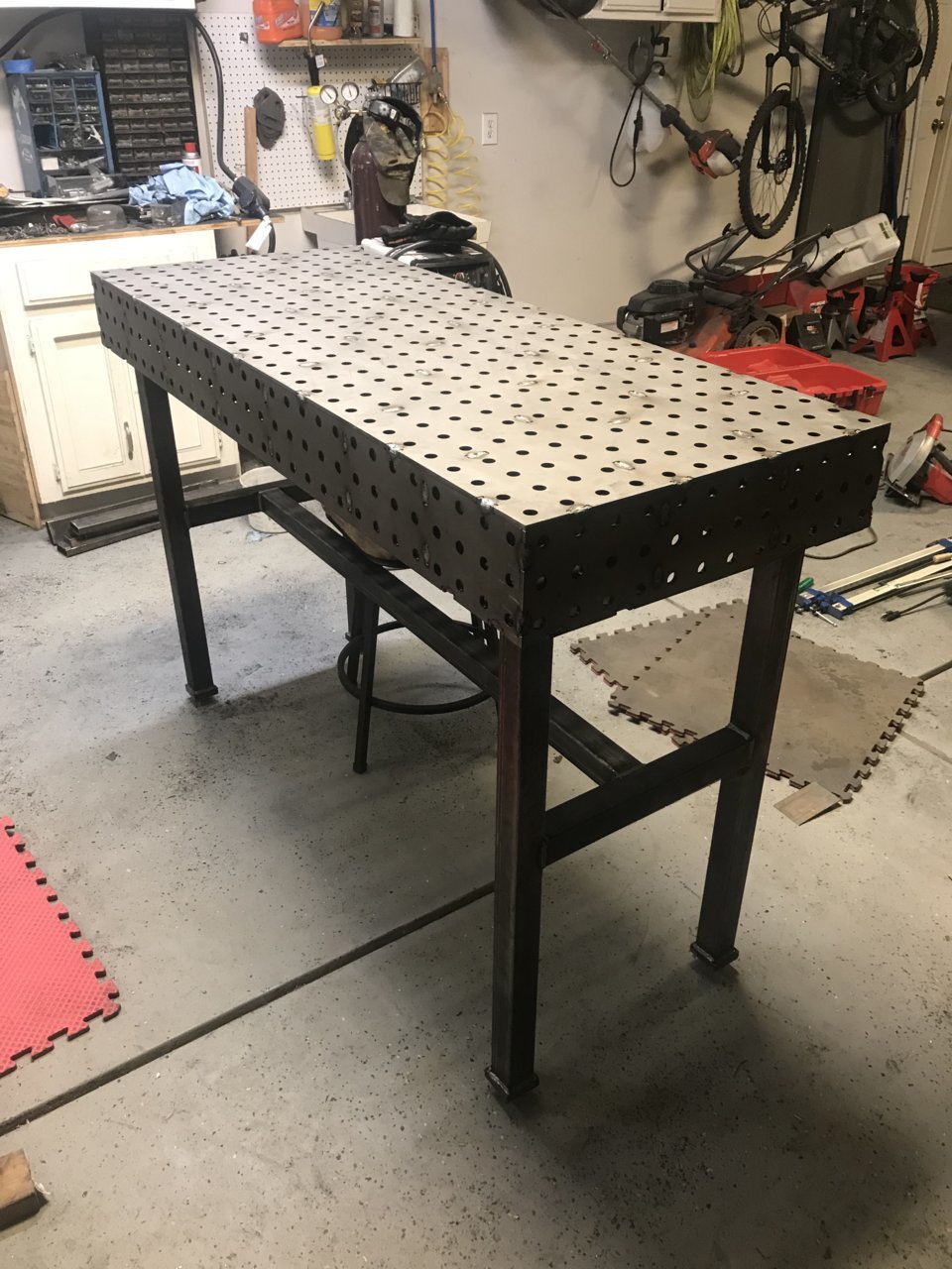

    My first welding project is of course a cart. It’s taller than most I have seen but needed the additional vertical storage in my garage. Definitely some crappy welds, but it was a good learning experience. Getting the 45* cuts to line up properly on the angle iron was a pain.

    Looks awesome man! You’ll definitely get your use out of it.
