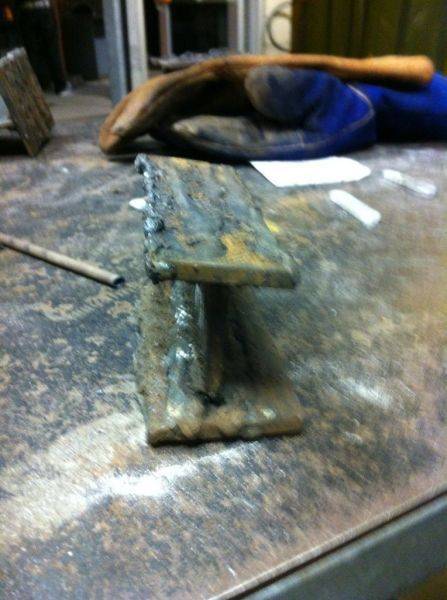

    I Beam from last weeks lab, I need more practice ha
