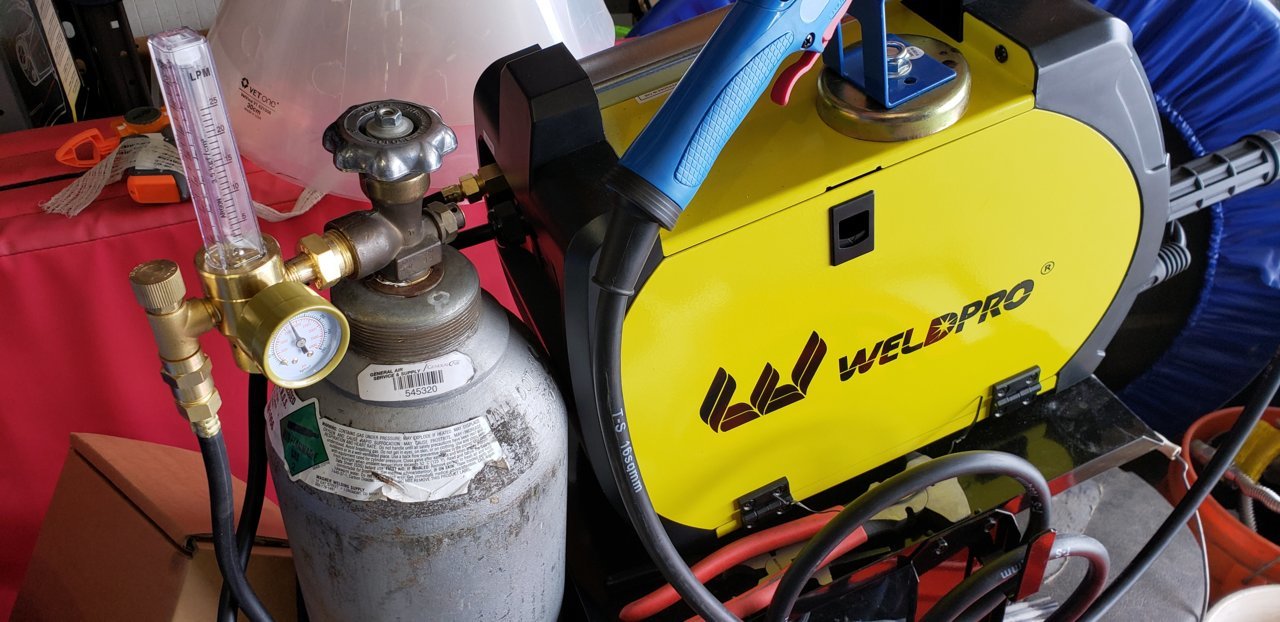

    Got some 75/25 gas today so I can start practicing with that. 15526063125782369680550311407545.jpg

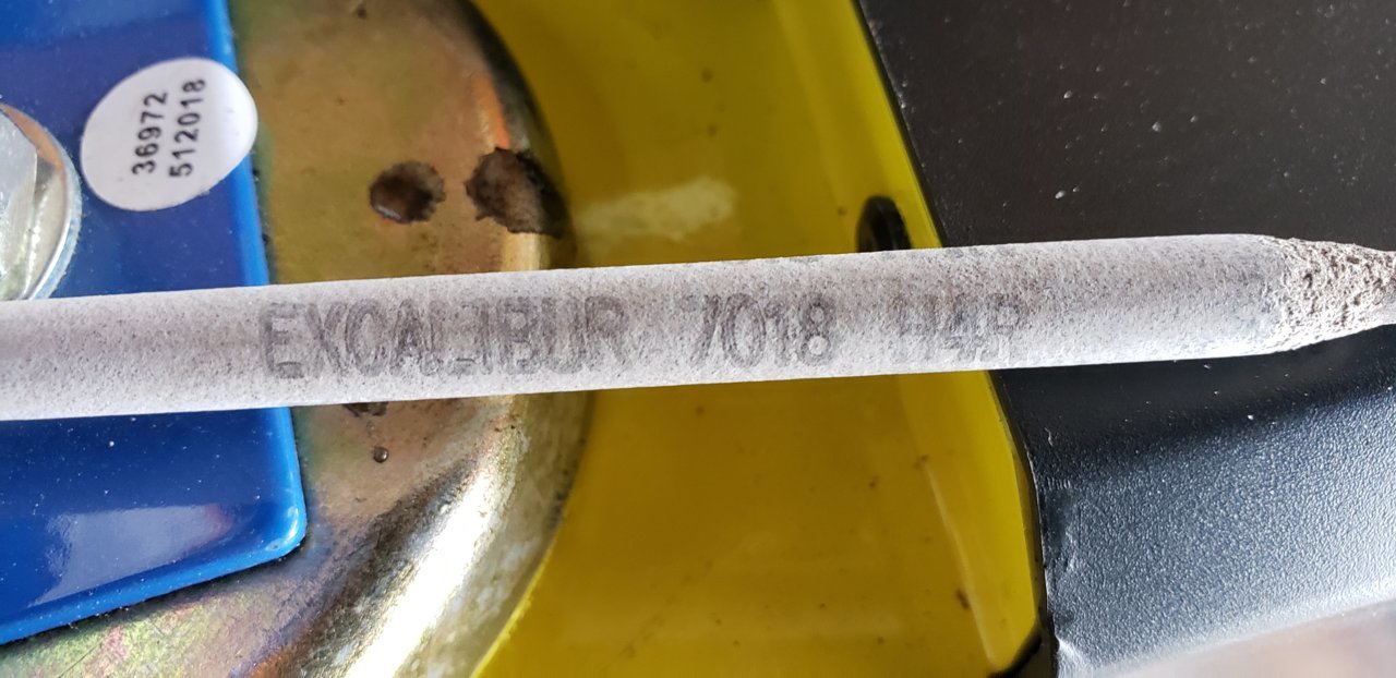

    And some excalibur 7018 rod that the shop guy swears will magically make me an expert stick welder :D1552606429710695236427595280779.jpg

    I've burned a lot of that exact rod. It's really a good way to learn. You learn a lot about arc length and heat management.
