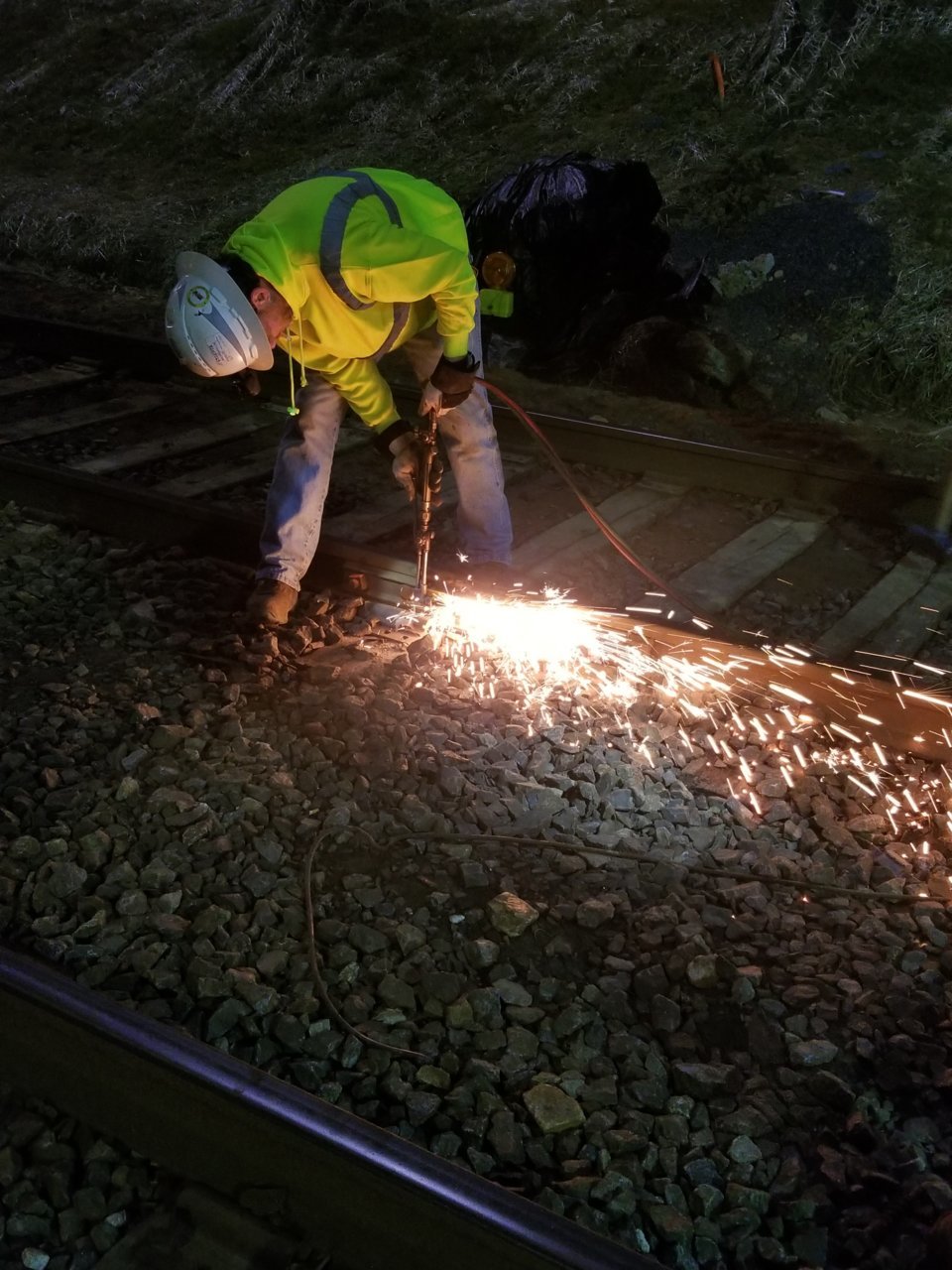

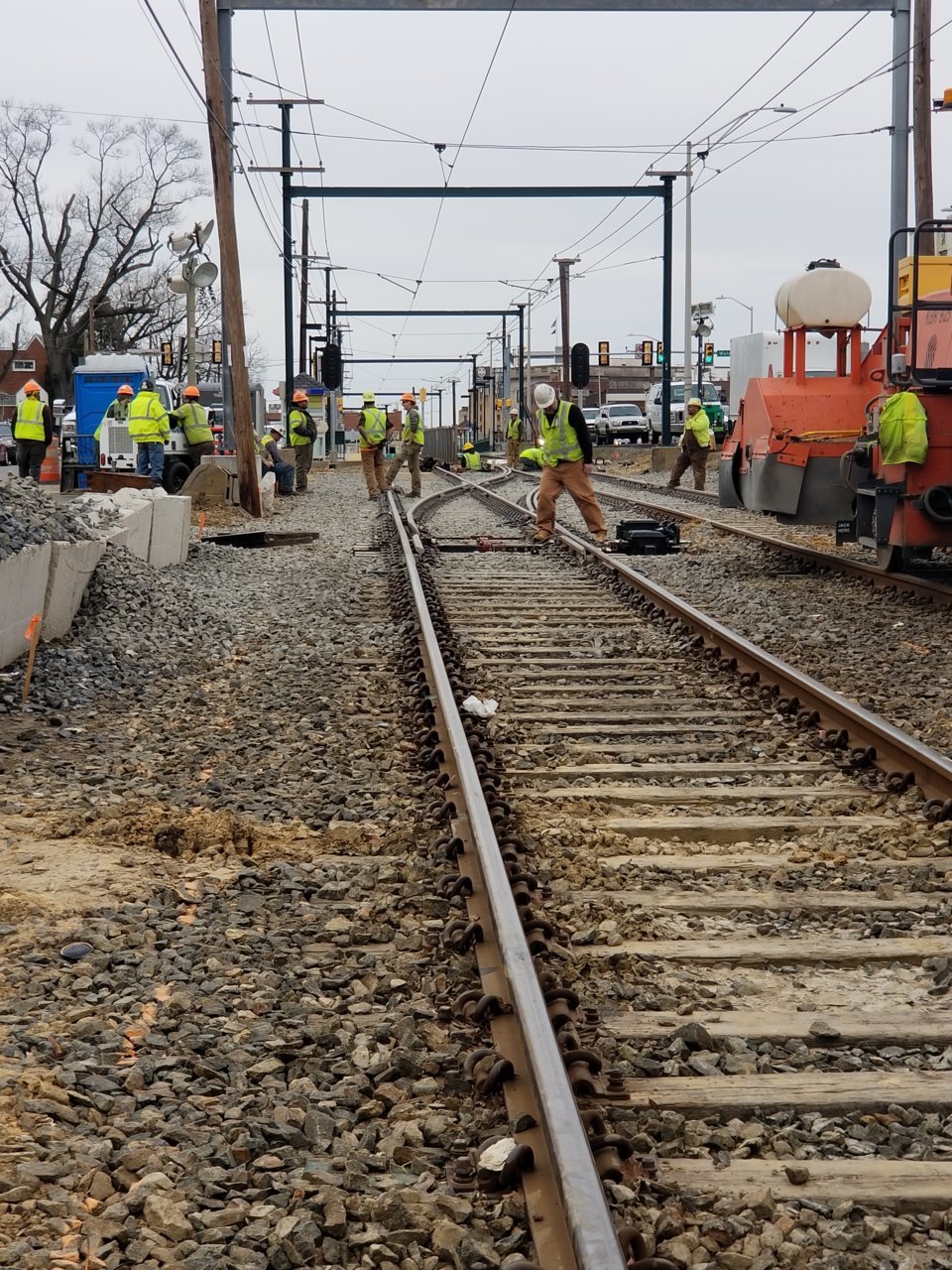

    Freaking railroad tracks...

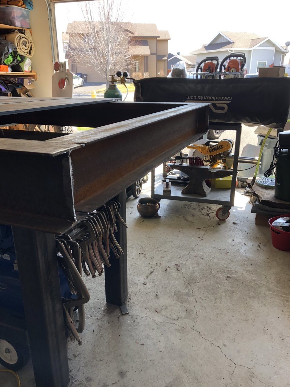

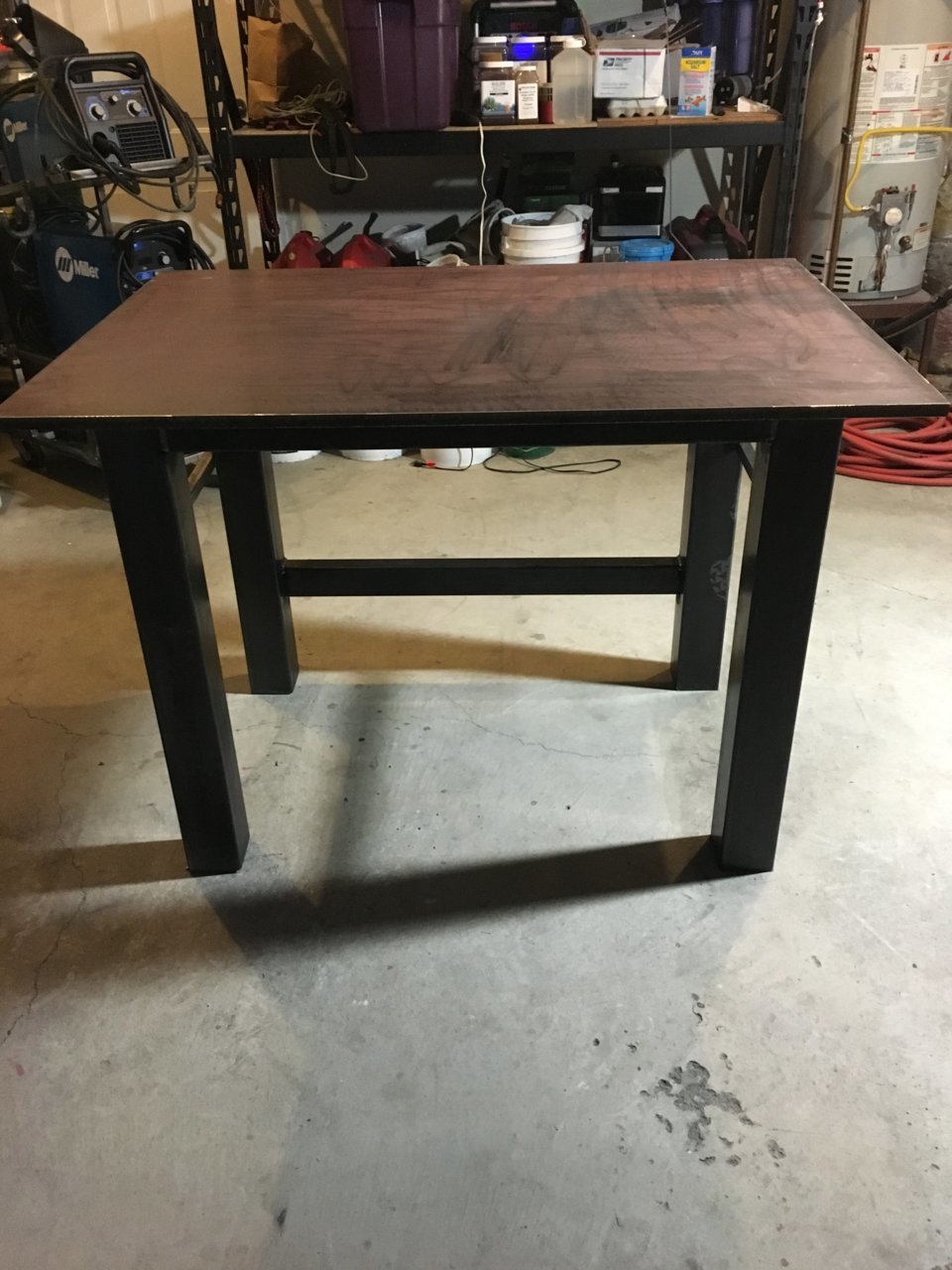

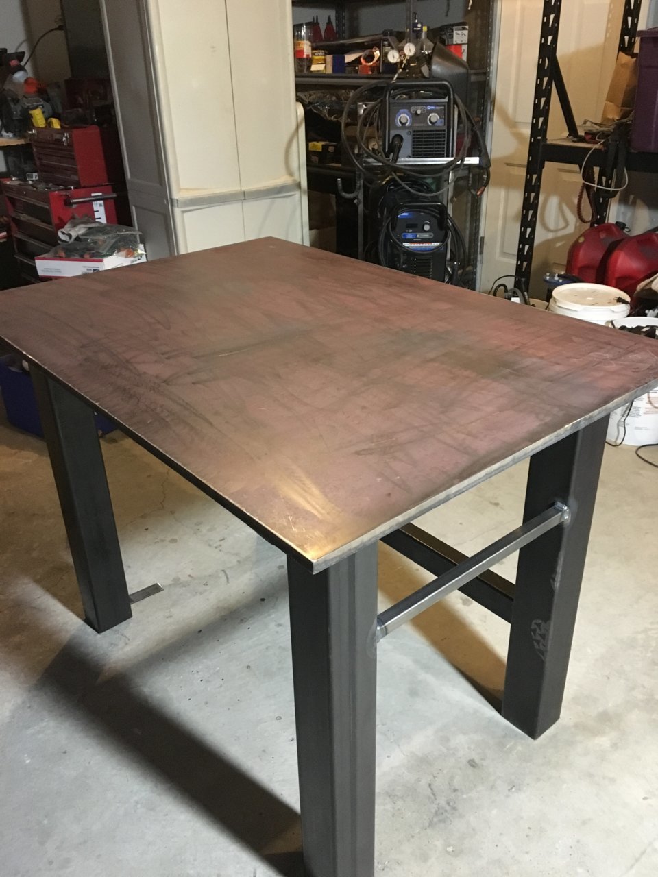

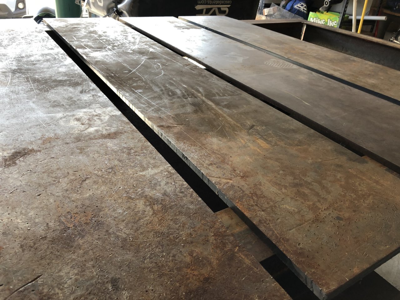

    Building a new welding table 5’x7’. I beam top frame, 1” 1/2 in between 1’ panels so you can clamp from a any area on the table. Second picture is of first table I built. I need a shop. :)

    Get in the Habit of rounding off your corners the trip to the ER wastes lots of time
    Also the height of the table just might catch tender parts and that trip you won`t forget
