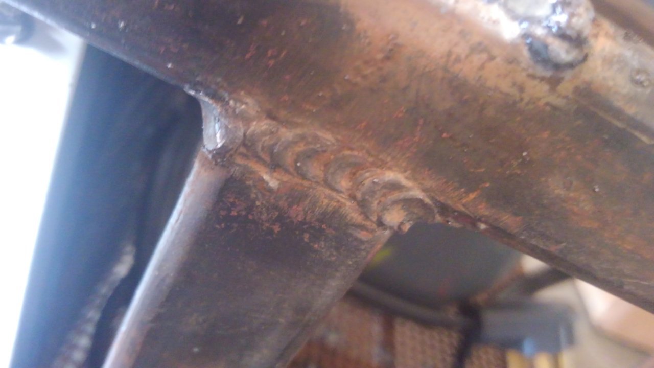

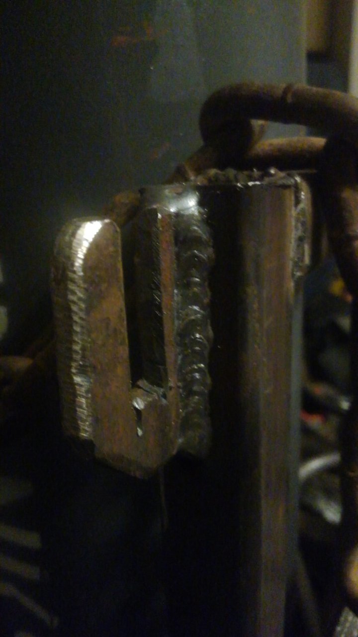

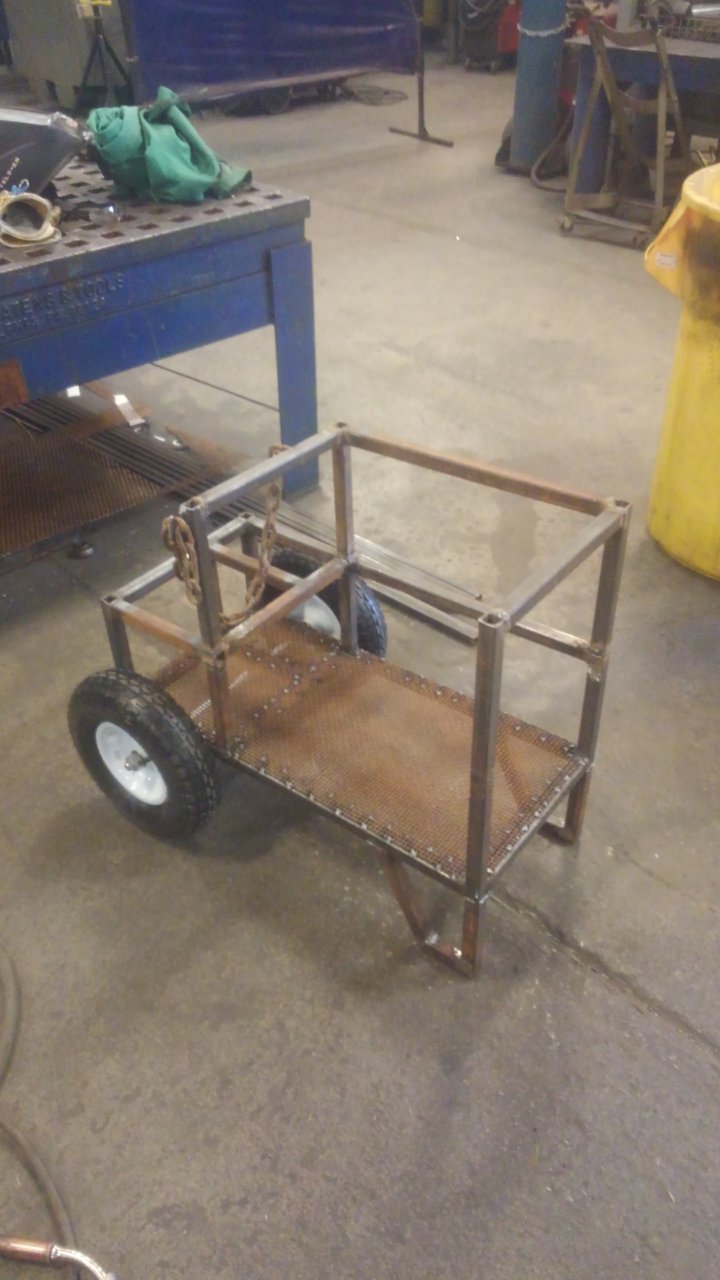

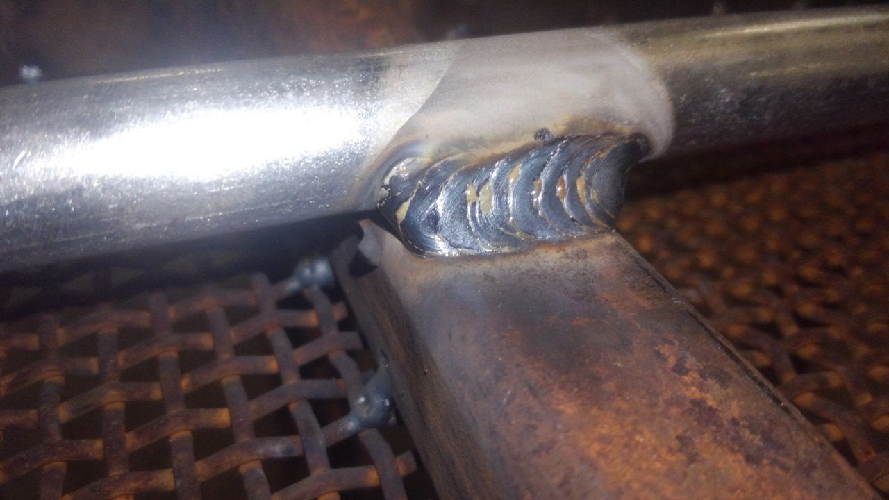

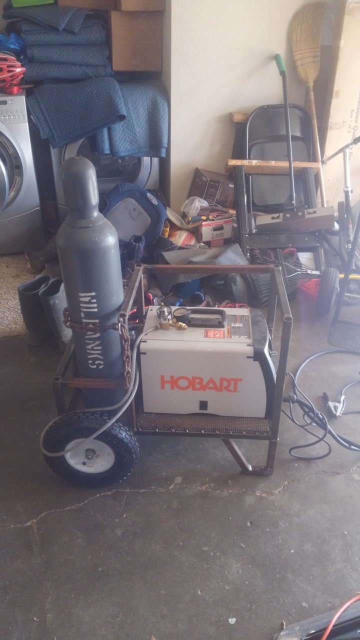

    Worked on a cart for my MIG welder. Hobart Handler 190, 80CF bottle. Floor screen is crusher mesh, 1" 10 gauge square tube frame. Piece of sheet for the top and a handle and it'll be done.
    Most of the frame was built with 3/32 6010, some stuff I MIGed. Was a pretty quick build, not perfect but functional.
