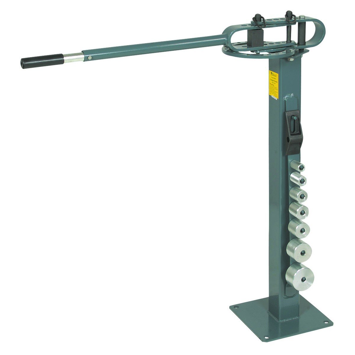

    Anyone in SoCal want this thing? It’s been floating around the shop for a while. I’ve never used it and am ready to trash it. Free to anyone in SoCal who wants to pick it up. Located in Santa Clarita

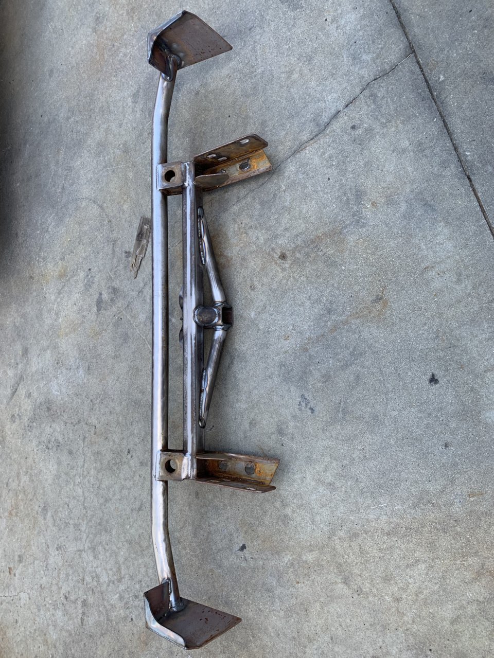

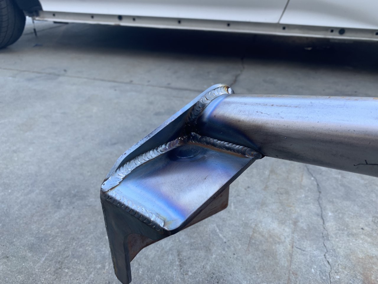

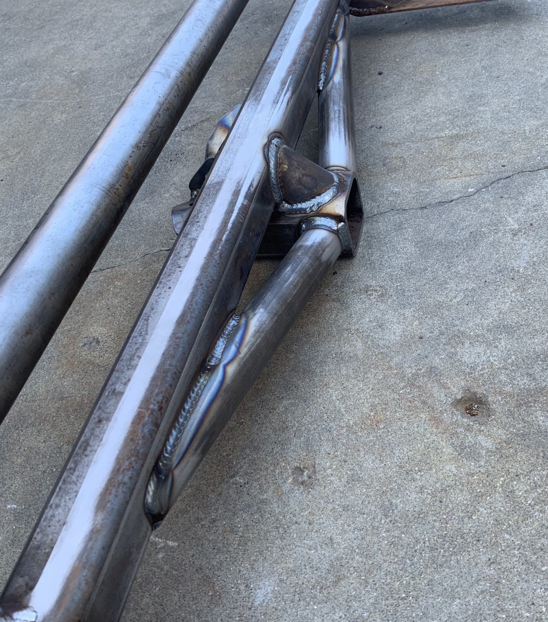

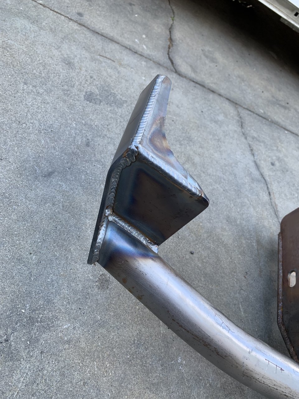

    Here’s some weldy stuff from the bumper I’m building.

    That is some nice weldy stuff!

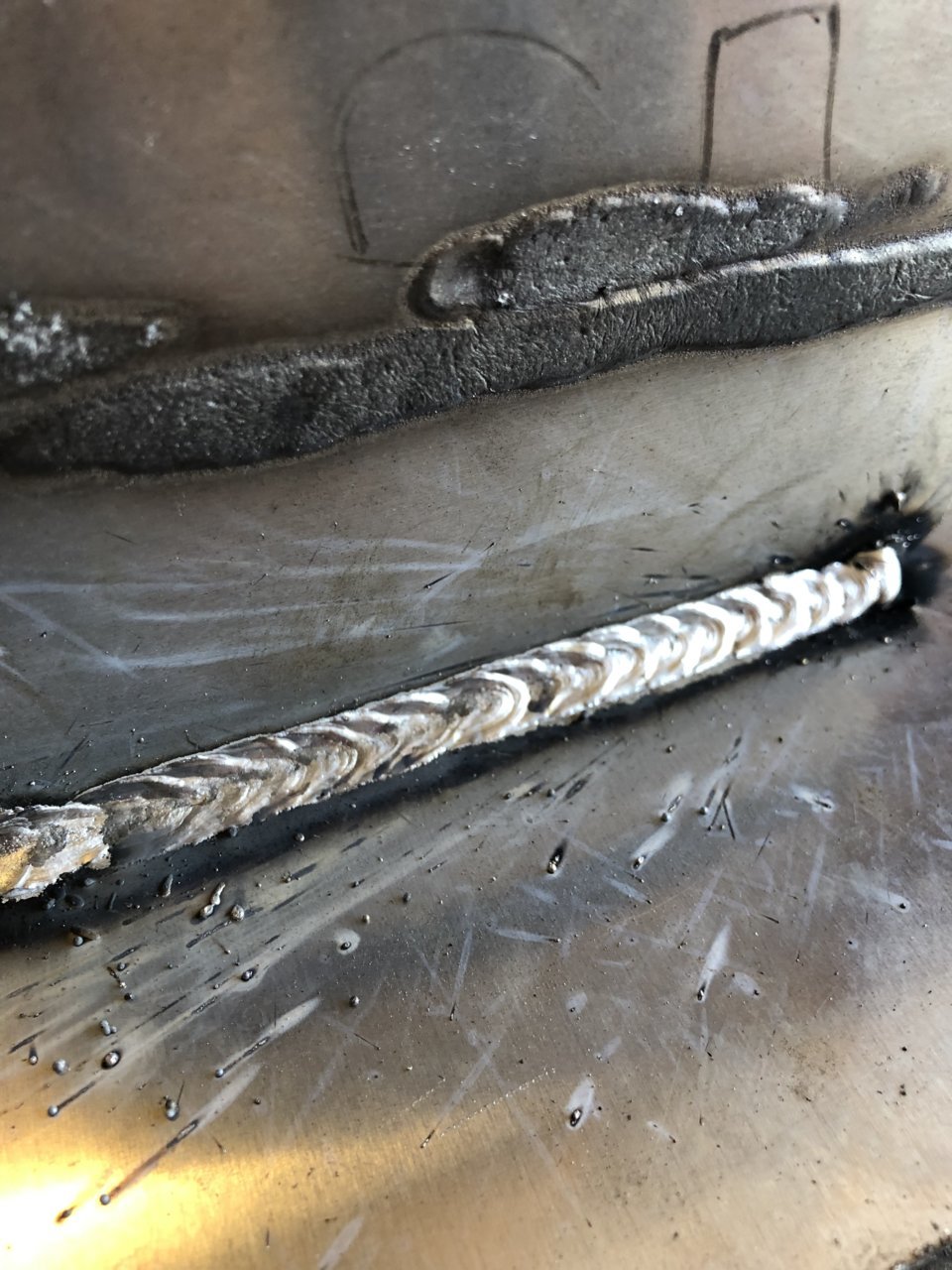

    Any chance you took a pic before you cleaned up the weld?
    Regardless, those look great for welding aluminum with a spoolgun.

    Thanks man! Here is a picture before hitting it with the wire brush

    Thanks. The level of soot looks about the same as my aluminum SG welding.

    Is that good or bad haha?
    I felt like it was an acceptable level. Not too much

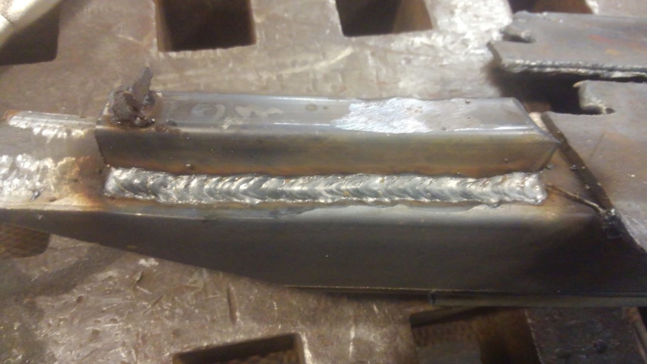

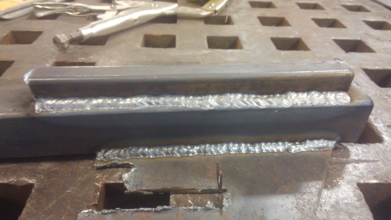

    Did some practice today with some scrap. IIRC it was 10ga plate and 12ga square tube. Lincoln MP350 with @ 17.5 volts and 205 ipm. Trying to make my beads a bit prettier, and more consistent. Any tips?
