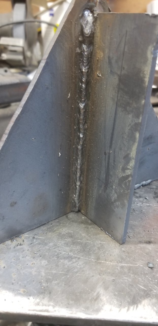

    20190401_210739.jpg 7018 uphill. Hubby asked for critique.
    Thanks guys

    Can we have a little more info? MIG welding with or without gas, stick welding? What welder is being used?

    408
    Vulcan ProTig 200
    1/8" 7018 electrode
    1/4" plate
    100 amps

    1st impression is not enough heat and/or moving too fast. Other than that, others can give a better suggestion. My stick welding days are behind me.

    Try a slight oscilation (not weave) in the rod, middle with take care of itself. Just try and tie in to the sides of the joint a little. 3G 7018 is one of the most difficult to get a nice looking bead. Takes a lot of practice.

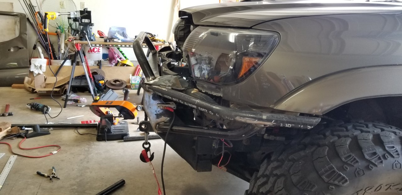

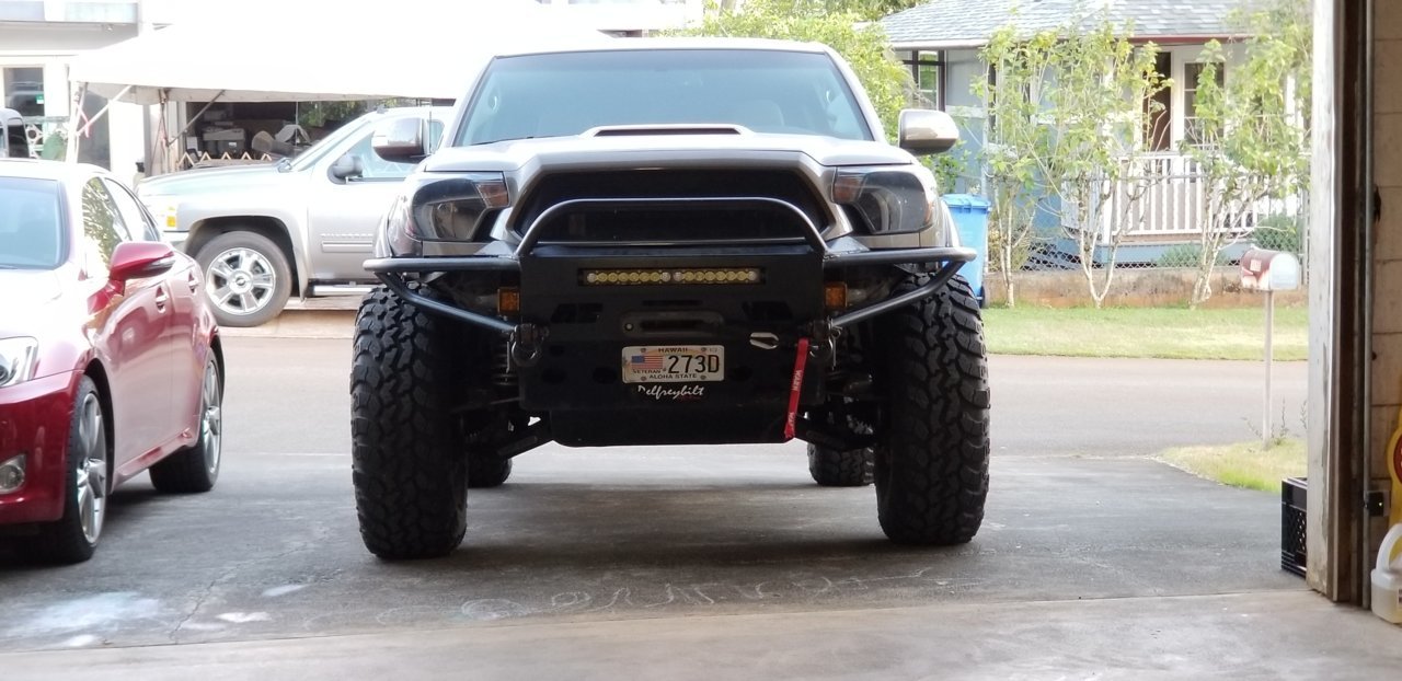

    Semi finished with my bumper. I need to take it off this weekend and weld the backside. I also want to clean up a couple beads that don't look too good.

    Try bumping up to 110 and going a bit slower. The biggest thing about going up hill is the heat carries. It also likes to build over the center of the weld too.
    To start out try this. The puddle should form and if you get the timing right it'll get a little bit of a swirl.
    If it builds up, space the loops up longer or move faster.
    Eventually the better motion is a lot smaller than a swirl. It's a slight motion side to side. A micro version of this move. As said above, not an actual weave.

    Too cold for 1/8”. And hold at the sides longer. Like the other guy stated, travel up in a Z pattern. If you want to learn stick the easy way, start with 3/32 size electrodes. Less metal and heat. Easier to do especially with 3G(vertical).
    Make sure the rod is just bareeeeely angled up(as in pointing up. Not down). Like 10 degrees max. And just goto one side. Pause. Other side. Pause. Up to the other side again. Pause. and repeat.
    Watch the puddle is something I cannot stress enough as I struggle with it myself. But the puddle under the rod really will tell you everything about your weld.
