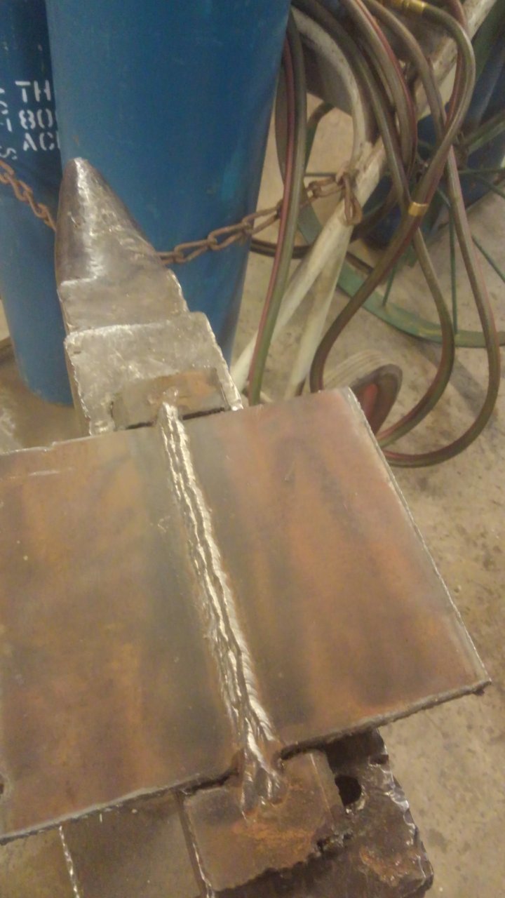

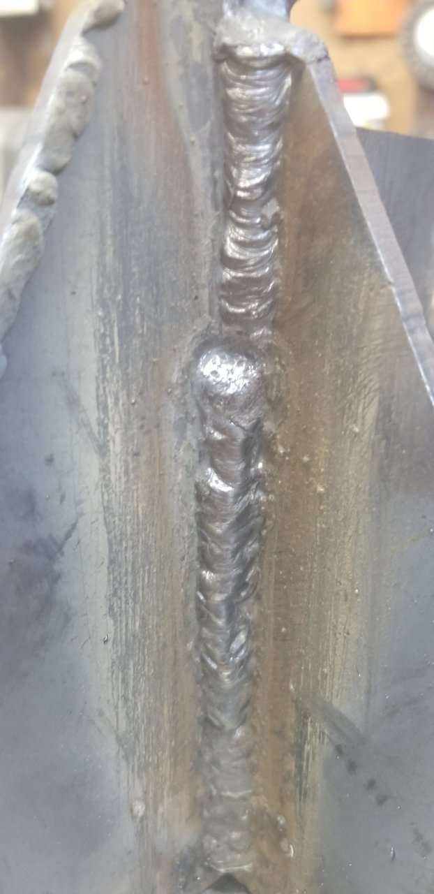

    Yup, agreed. Just make sure you keep a pretty tight arc, 7018 doesn't like long arcing too much...can also introduce porosity.
    X2 if you don't watch your puddle, you'll never make good welds. It tells you everything. Don't let it get too big on 3G though, as gravity likes to pull it down.

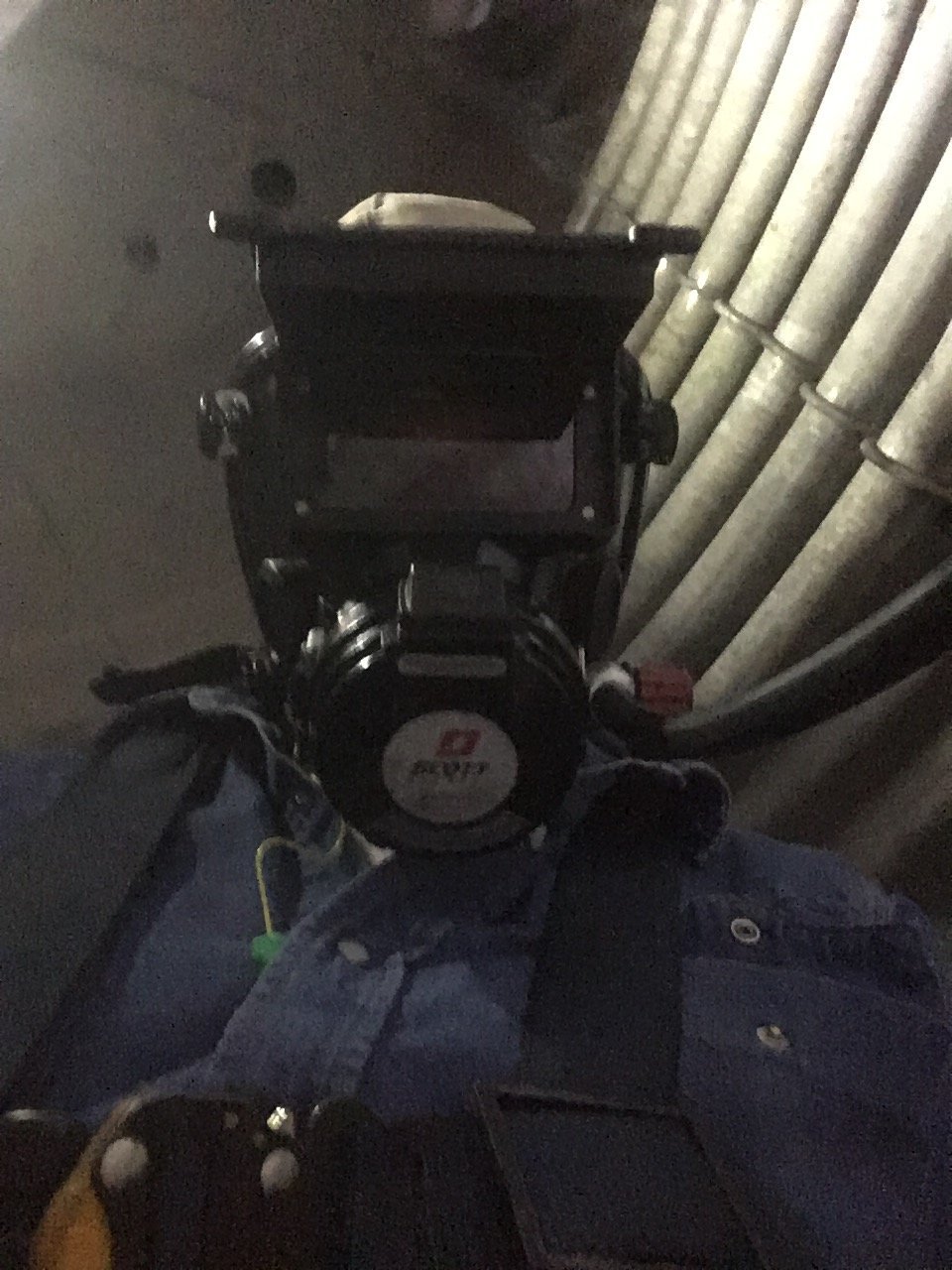

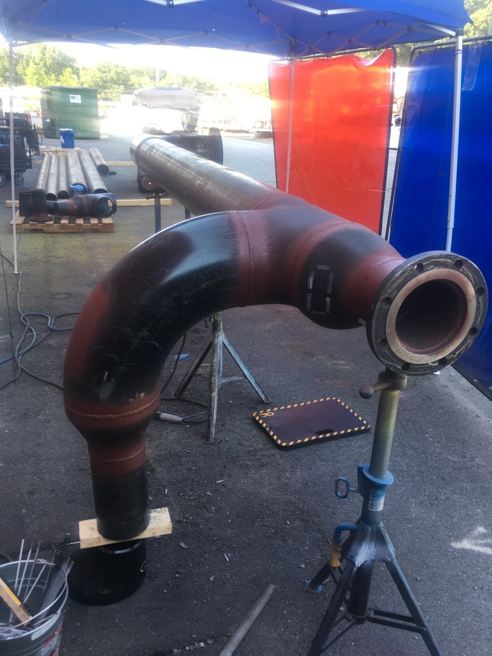

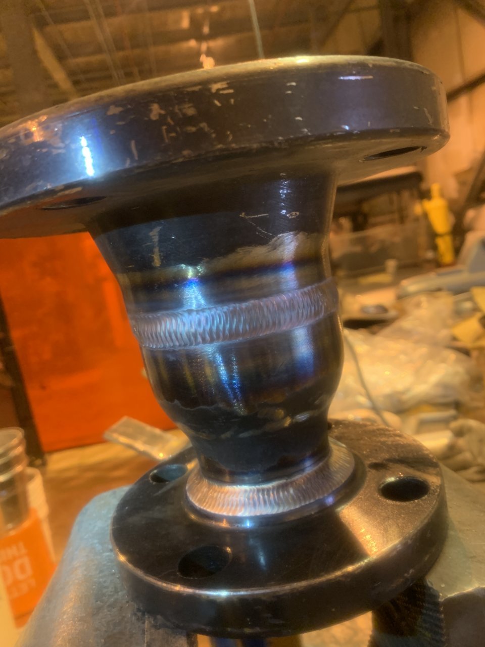

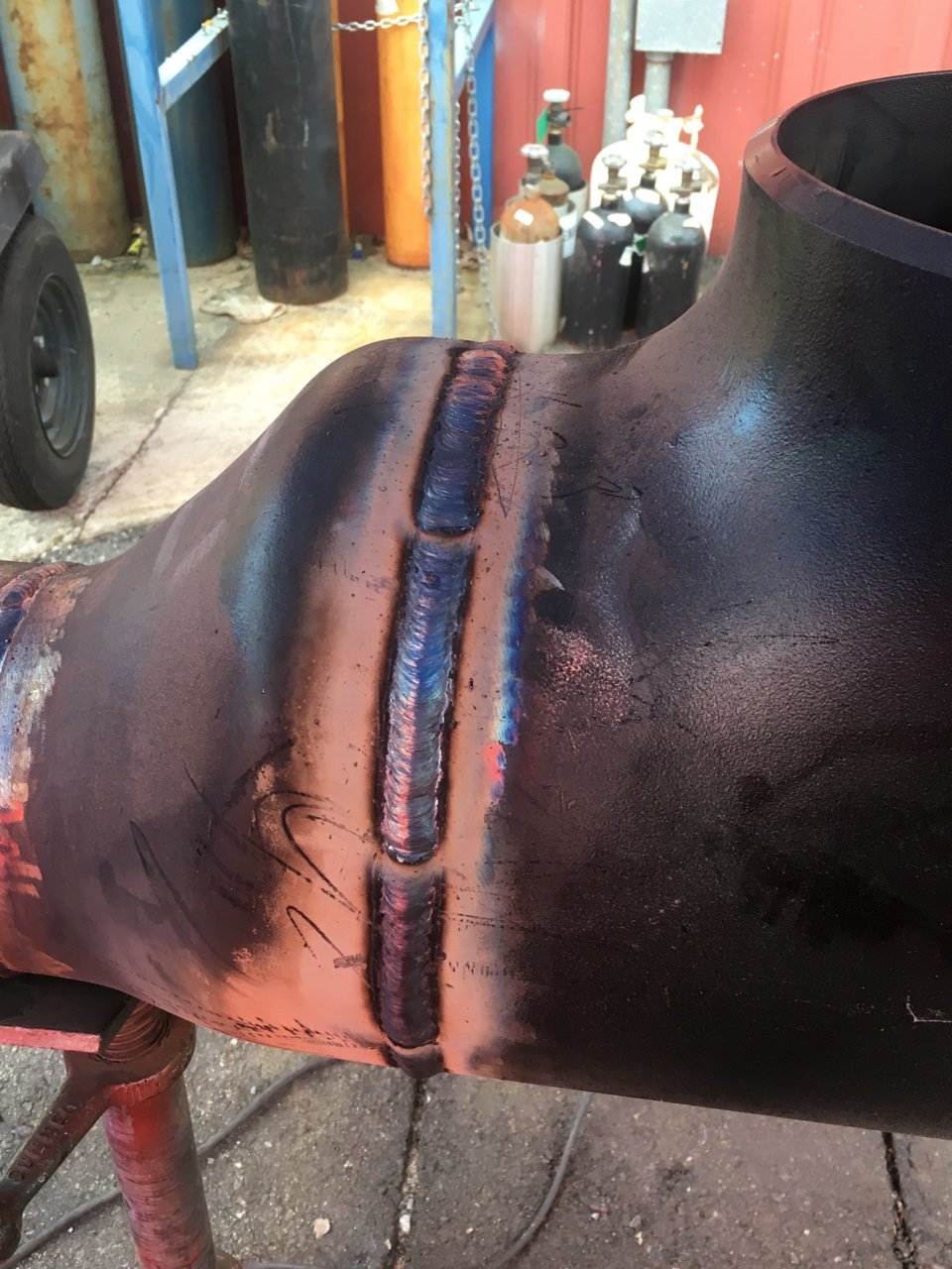

    A few random xrays, spool pieces and sch80 chill water stick.
    Sch10 root
    7018 cap
    Inside reactor repairing cracked coil. Breathing air hood

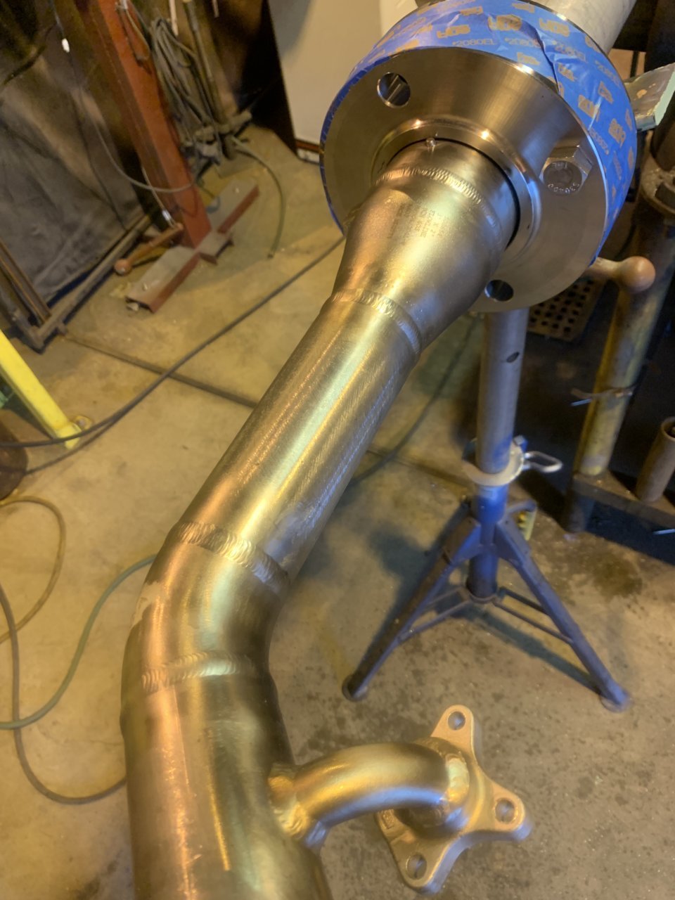

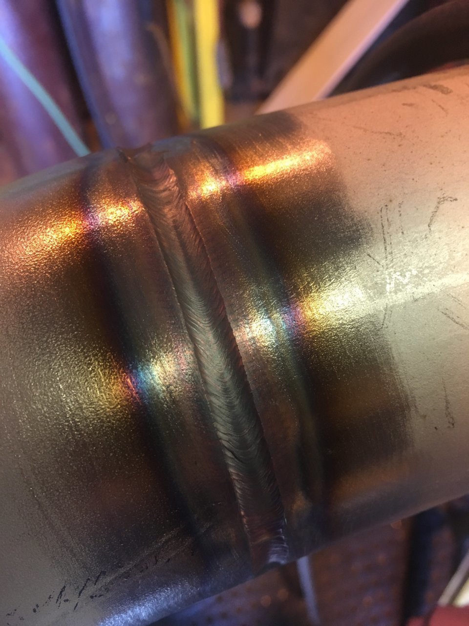

    Hell yea. I’m practicing my stainless stick on pipe currently. Bottom is ugly. Top is perfect.
    Trying to figure out what I’m doing wrong as I’m going around the pipe lol like rod angle or speed or idk. Something is changing.

    Are you comfortable when welding the bottom ??
    Able to see the poodle from your position ?? Causing you to be distracted by the women holding the poodle.
    comfort and being able to see
    Arms getting tired to fast ??

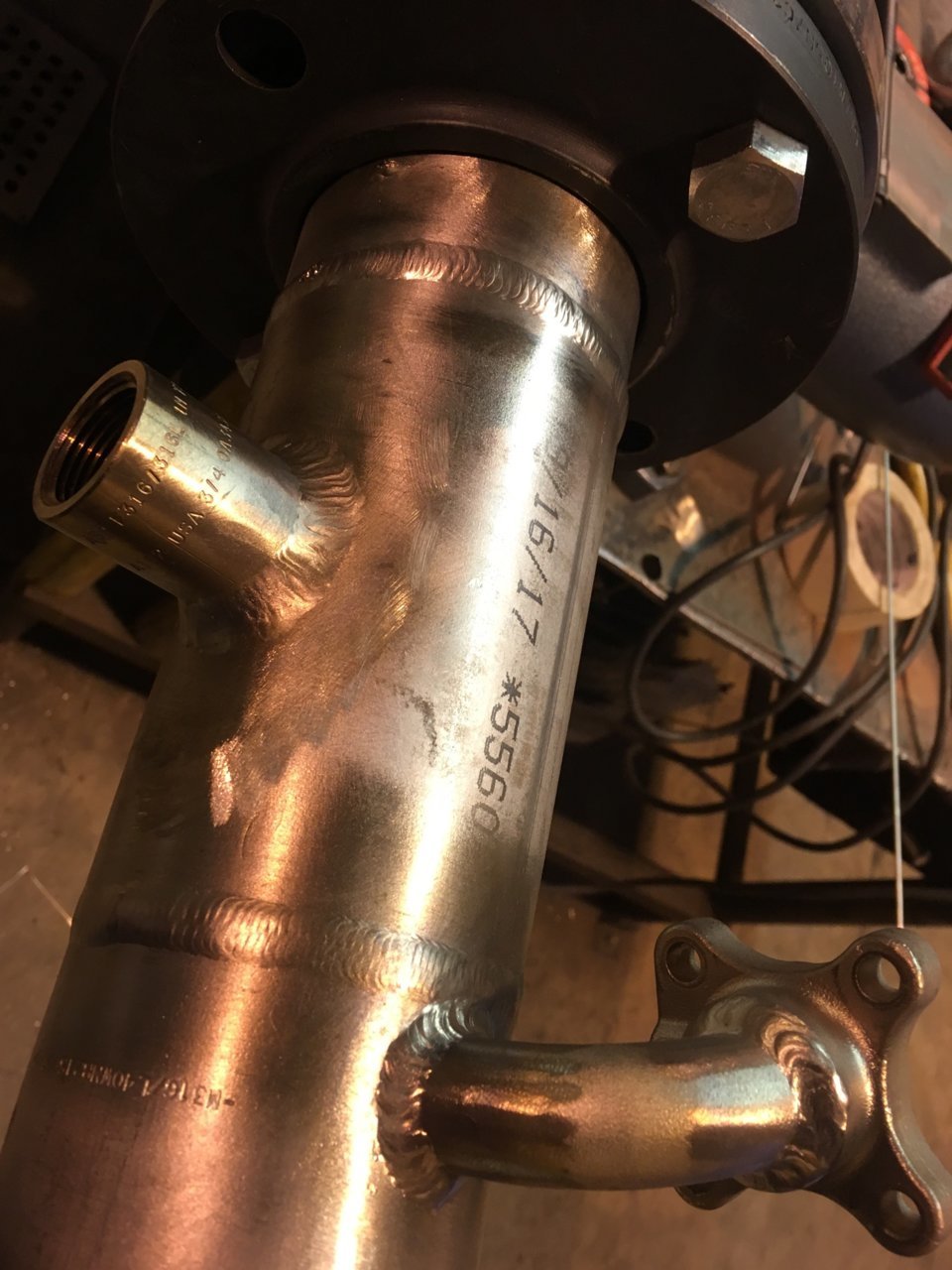

    ALSO FUCK STAINLESS STEEL STICK 6G lol. 1/8” 316. Trying to get used to travel speed and angle and all that. A lot tricker than 70. Hard to watch the puddle cause it freezes so quick.

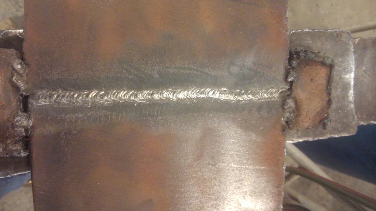

    Tried 3/32 7018 @ 90 amps
    Slight push uphill. Flattened the bead out nice. Thanks for the tips.
