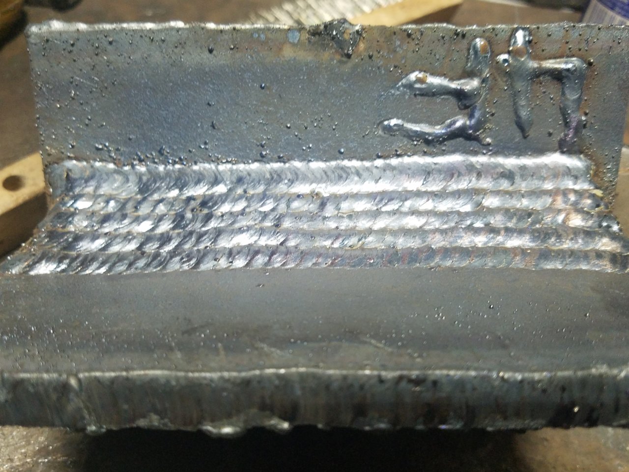

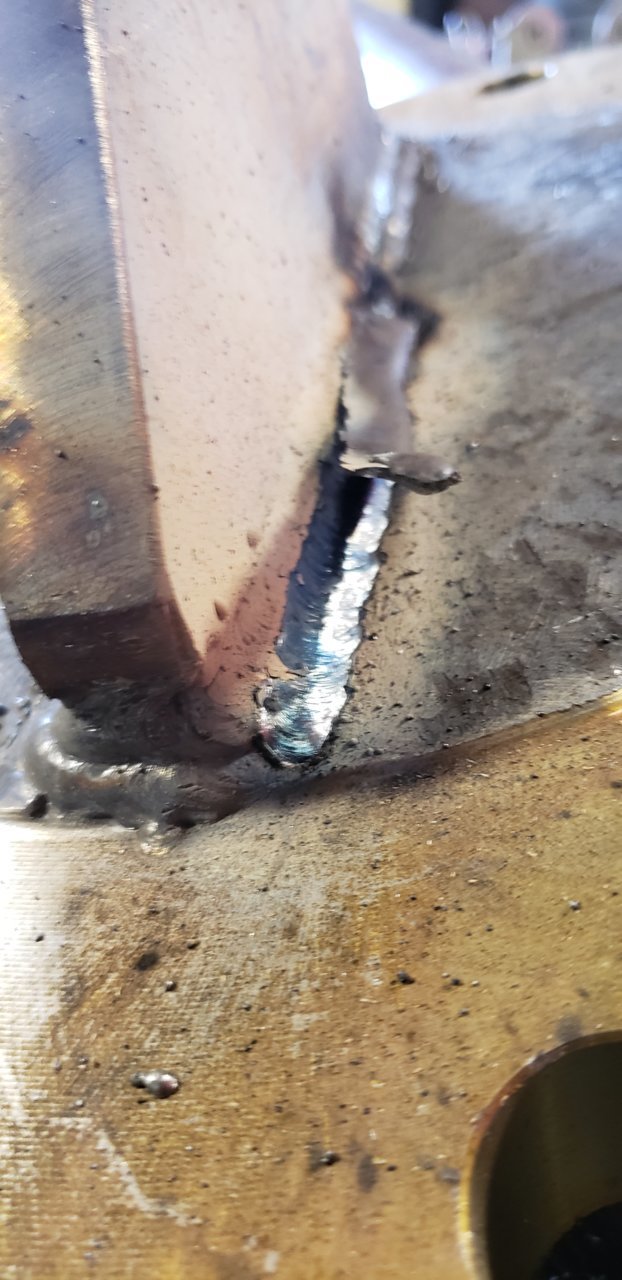

    04 trd x-cab 4 x 4 3.4l

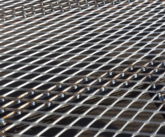

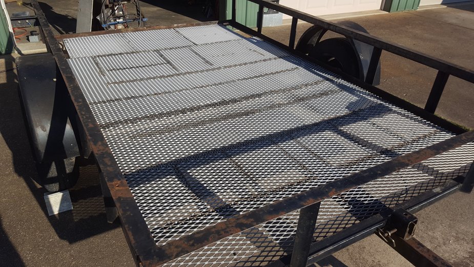

    I thought welding was fun until I sat and welded in most of my new expanded metal floor in my trailer. :frusty: 10' x 6.5' tilt. I welded front and back beads in what I thought were likely high load areas. Had my welder set at 120a with med (5 of 10) wire speed with 0.035 wire. Each spot was 2-3 seconds. I have a Hobart 150.
    Man, it is solid as walking on plate after those spots were added. Zero flex. I hope that prevents the usage induced sags you usually see in this type deck. Also, I bought some really heavy stuff ($70/sheet). I'd estimate thickness at about 3/8".
    Hopefully finish the deck this afternoon. I am going to close in the inboard side of the wheel wells before I paint it. Probably add some hooks of some sort on the rails too. It had an old manual (steering wheel/shaft to crank it) winch mounted on it. Not sure if I'll put it back or go electric.

    This trailer had rough cut 2" x 6" oak and other(??) boards an old carpenter had put in it. I believe this metal actually makes the trailer lighter in my case. I've been rolling it around by hand and I'm a 150# weakling.
    If I had used plywood, I would have used 3/4". Just going by loading it when purchased and moving it around when cutting, I think this metal is close to the same weight as a sheet 3/4" plywood. Hard to tell since it is so "floppy" when handling it. But, I don't know the weight of either, so it's just a guess.
    I wouldn't let the weight scare you off. If it definitely more work that replacing with wood. But, should be a one time thing, whereas wood.... Both have pros and cons.

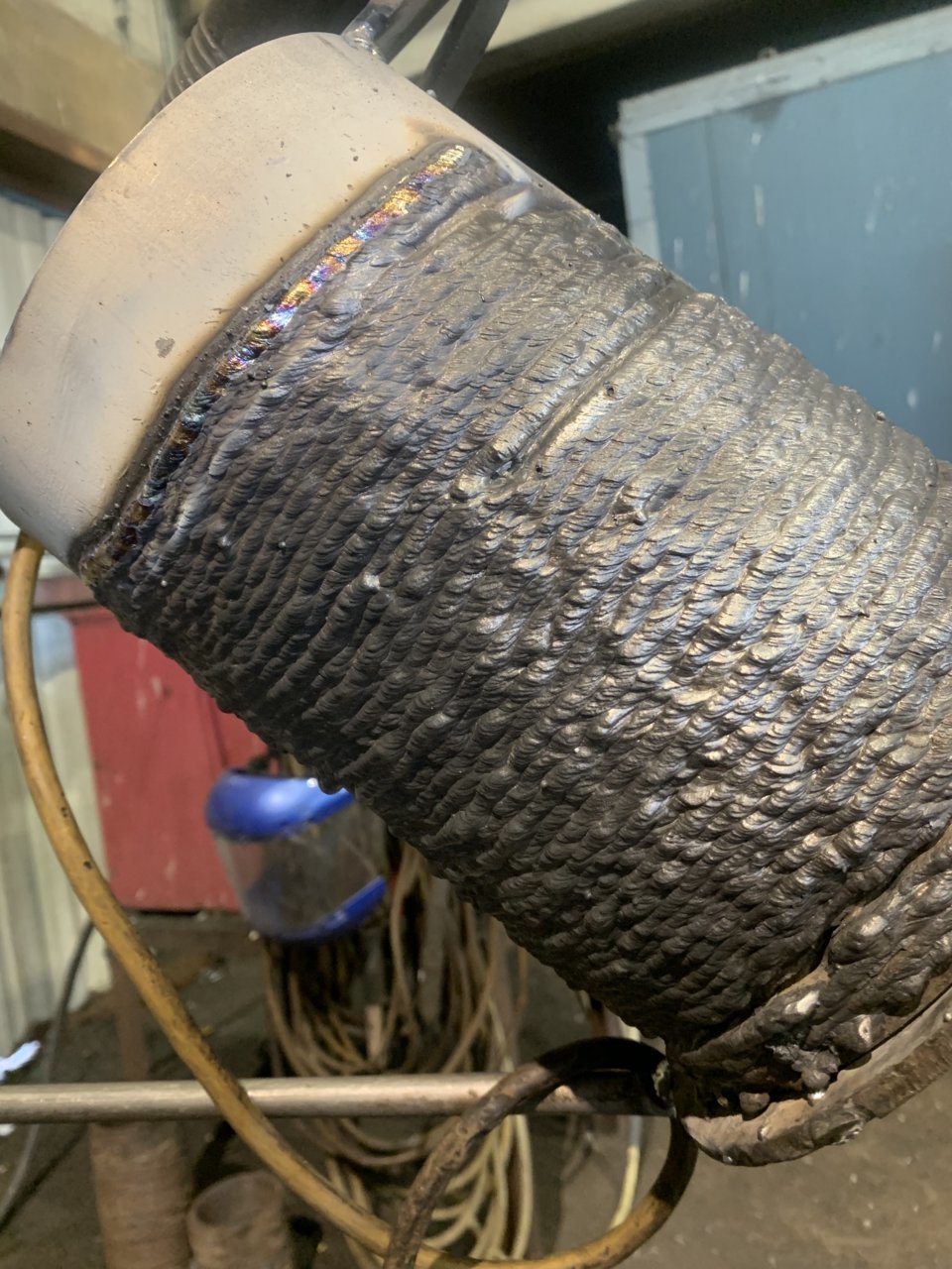

    Hardwire overhead fun :)
    actual work. 309 flux, spot was tighter then a virgin butthole
    also how do you make a picture smaller?

    Mannnnn I see more and more jobs testing for that 309 flux.
    How does it compare to 71 wire? I wanna take a test with it just to try it.

    Yeah just that faster deposit of wire feeders. Seems to like alot of heat. Maybe just seems that way since it was a while since I've done flux. Actually tested on 6g 3in sch 20 ss pipe so this was just random..

    How much heat? Usually I run 25-27v.

    Was running about 26 and bout 450 wire speed in a suitcase. About 200 ft from welding machine:D last time I ran flux I think I was in the 23 ish

    That is a ton of wire :laugh:
    Last time I ran that kind of wire was on like 33volts welding on a stack for a natural gas turbine.

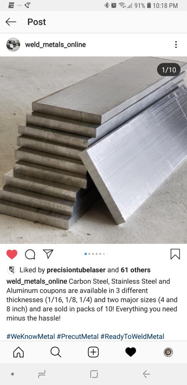

    Just ordered some of these for practice. Sure I can get metal locally for a bit cheaper but this cuts out all the cutting and prepping which I hate. Especially since it's just for practice lol.

    You are aware that welding will involve quite a bit of " cutting and prepping"?
    You actually will doing more "cutting and prepping" than welding. If you hate all that cutting prepping, you might not like welding.

    Very aware of it. But I dont need practice cutting and prepping. This is just a time saver.
