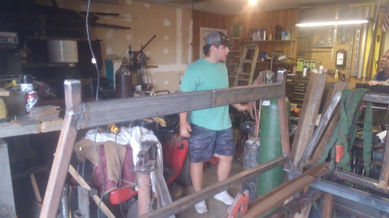

    Made some more progress on the headache rack. Getting there! Been trying out my Hobart Handler 190, it welds awesome...nice and hot.

    I know we all use what material that is left over from paying jobs .
    Unless the pictures make it look heavier then it is
    Just what is that going on??
    A heavy haul oil field truck ??

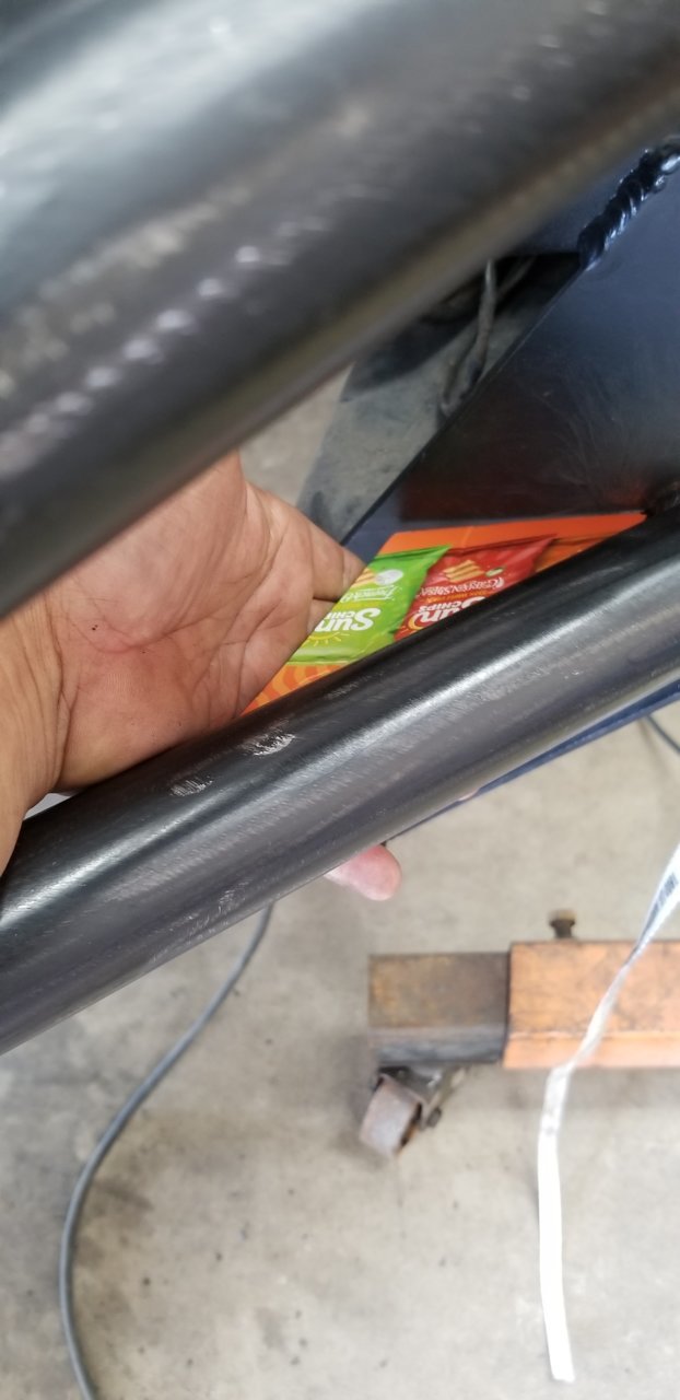

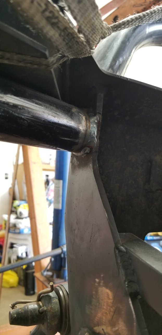

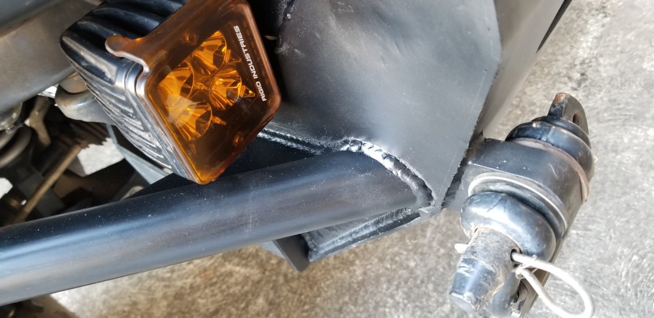

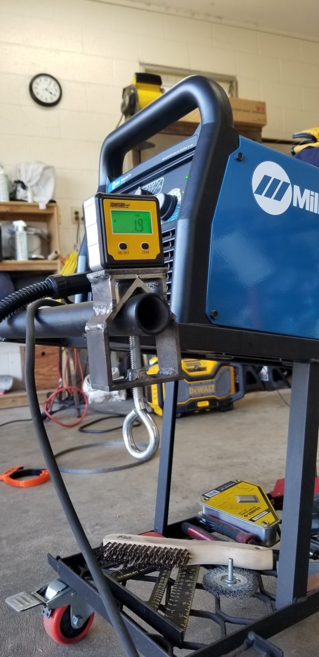

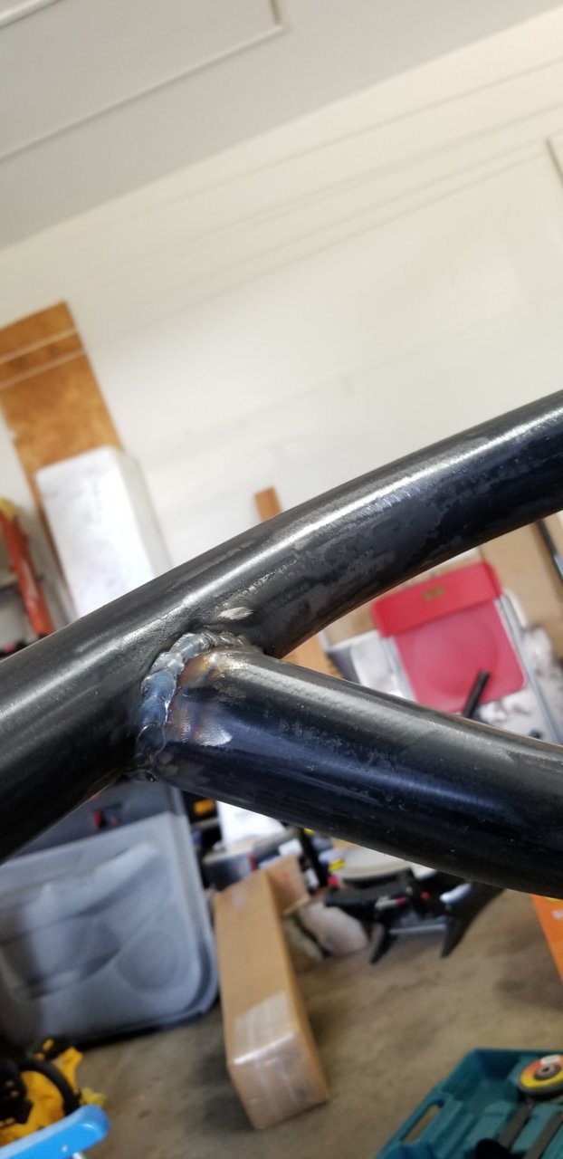

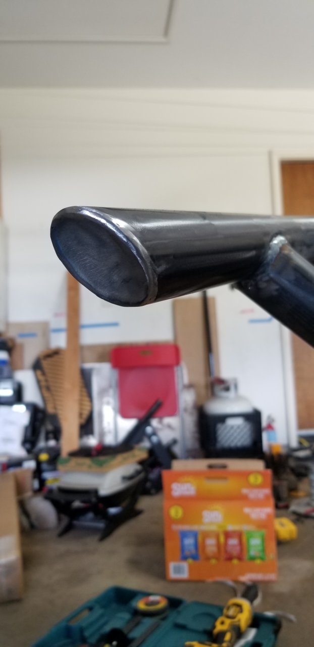

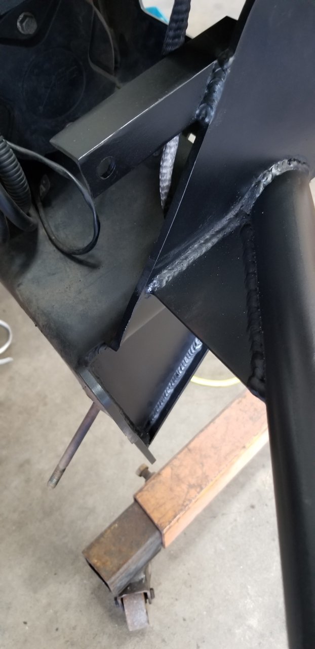

    I made this rotation angle finder clamp. It came in handy when fitting up the bent pieces to my bumper that needed to be rotated and matching on both sides.

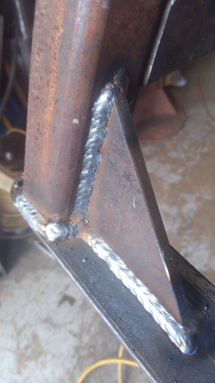

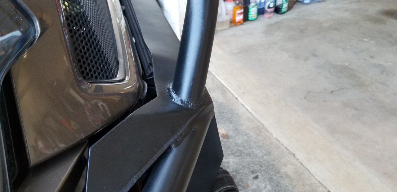

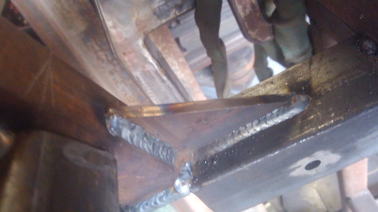

    I also finished up my bumper. Added some gussets, capped the ends, and welded the backsides. Sorry, no weld porn here, but I got a lot of practice and my welds were looking better at the end than when I started the project.

    “No weld porn” but then posts excellent looking welds lol bumper looks great man!

    Lol. Thanks man. I actually had to grind away a couple ugly welds. I was so dead and tired at the end of the day, some welds looked like crap. I used a 1/8" grinding disc and erased those and rewelded.

    It's going on my Tacoma. It won't be too super heavy. Shouldn't weigh much more than 70 lbs with full length angle iron bed rails included. 1.5" square tube, and 1.5x3" rect tube for top bar. The uprights on the side and ears are 3/16 or 1/4" wall....forget which, rest is 1/8". Gonna have lights and screen or louvers to protect back window.

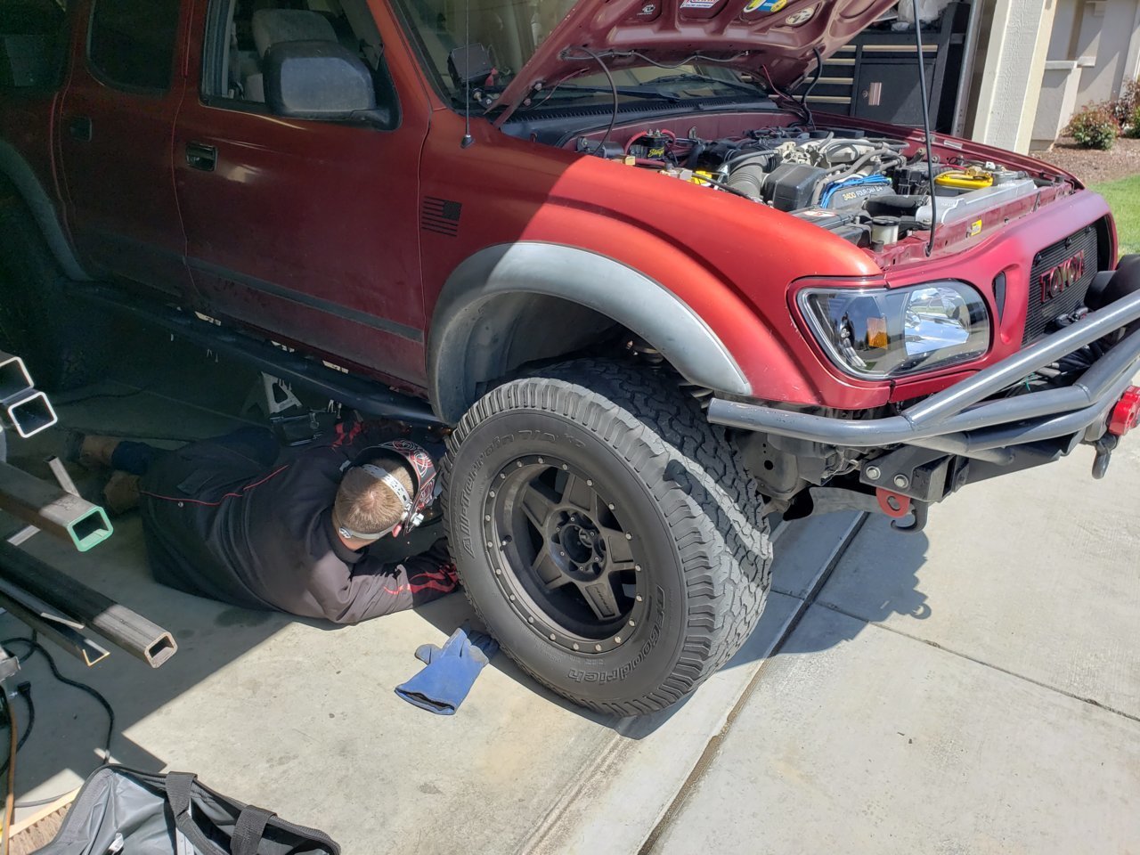

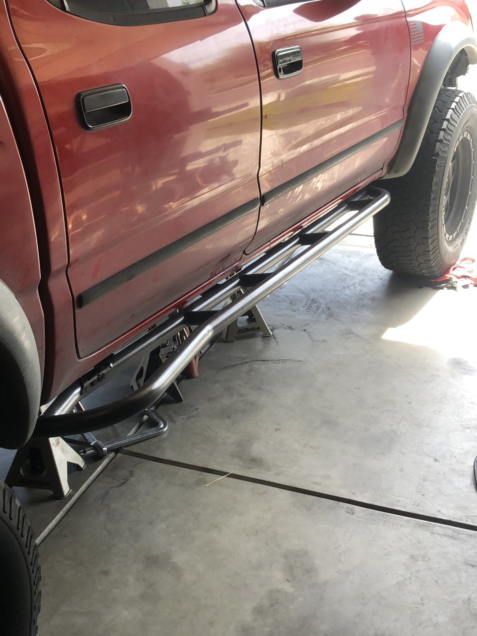

    I welded some sliders onto @Uphillshunter Taco.
    C4A34039-D64F-4C29-A77B-6F6827D97A01.jpg 359AC917-DCEF-48FD-BF95-A6668B664507.jpg

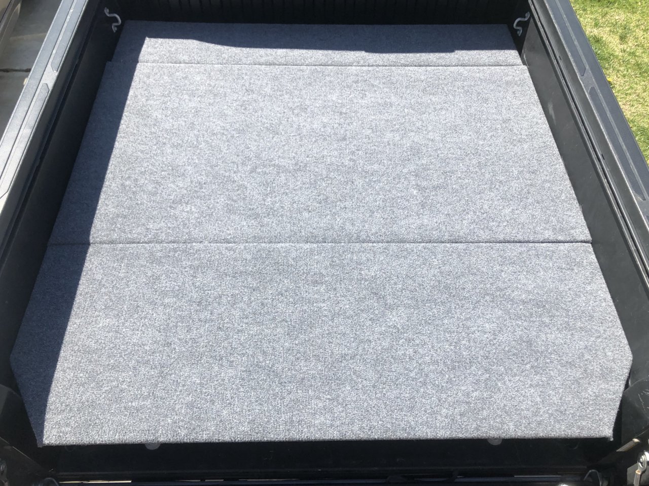

    I also finished laying the carpet for my sleeping platform FCBE0518-7FE5-4672-9CCE-A26360F98321.jpg

    And can't possibly begin to thank you enough brother. Awesome job!

    It must have been the angle of the pictures looked more like 3/8" angle

    Nope, bed rails are 2x2" 3/16" angle. It's gonna be heavy duty, but hopefully not too out of proportion to the the truck.
    I'm planning on putting some kind of padding between the rails and bed. Any ideas on that? Thinking some 1/8" closed cell foam strips?
