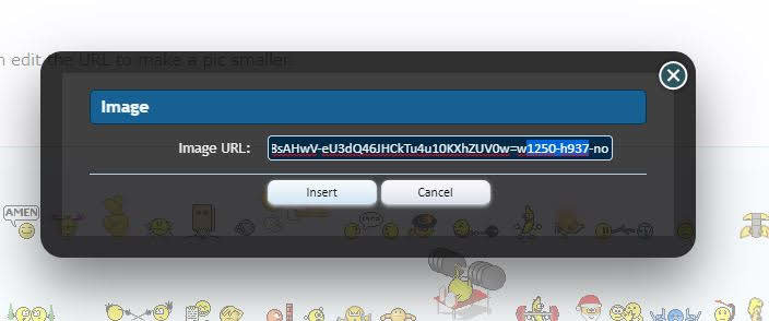

    Ah ok thanks, little more work then just hitting the upload file button

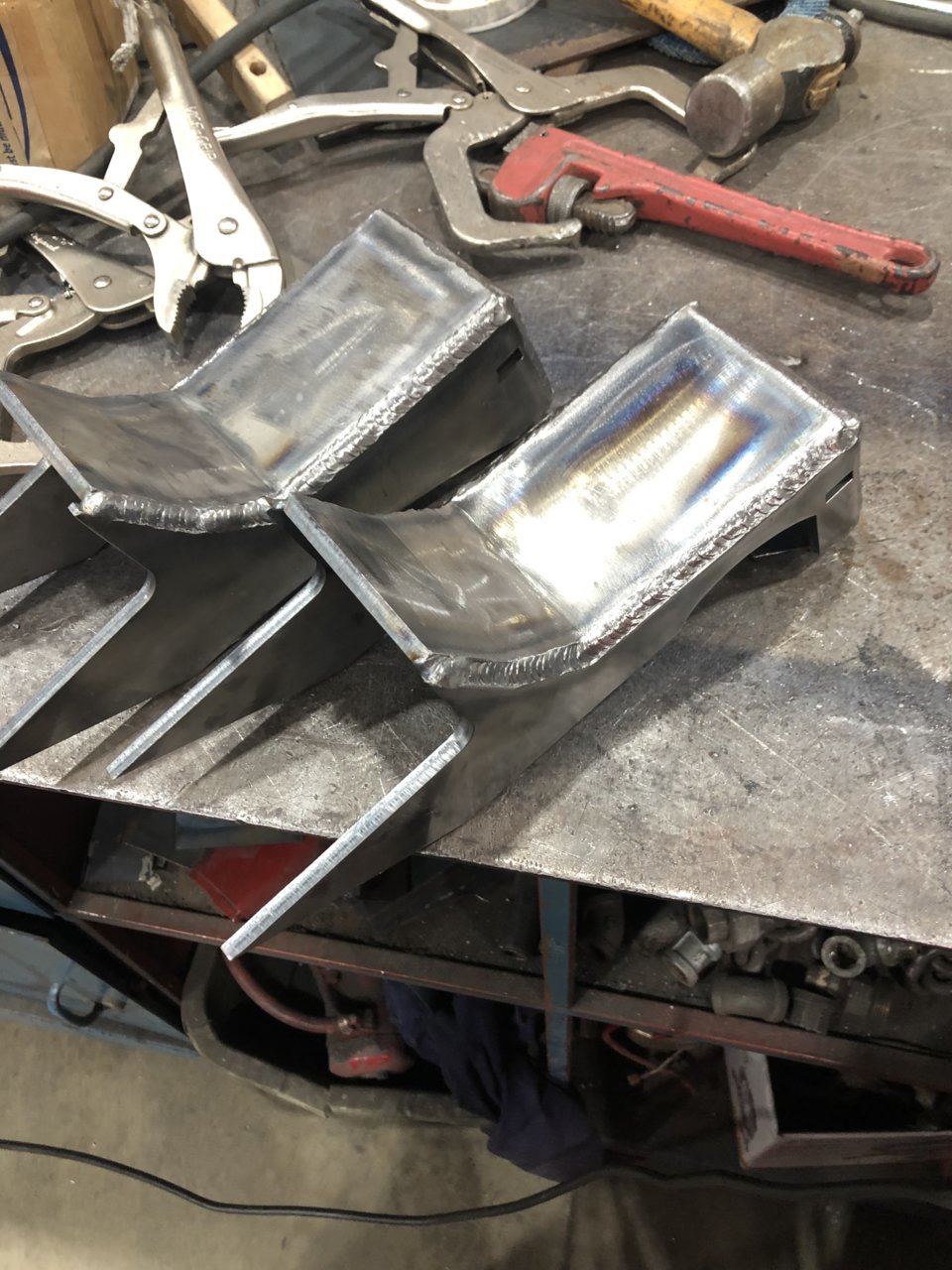

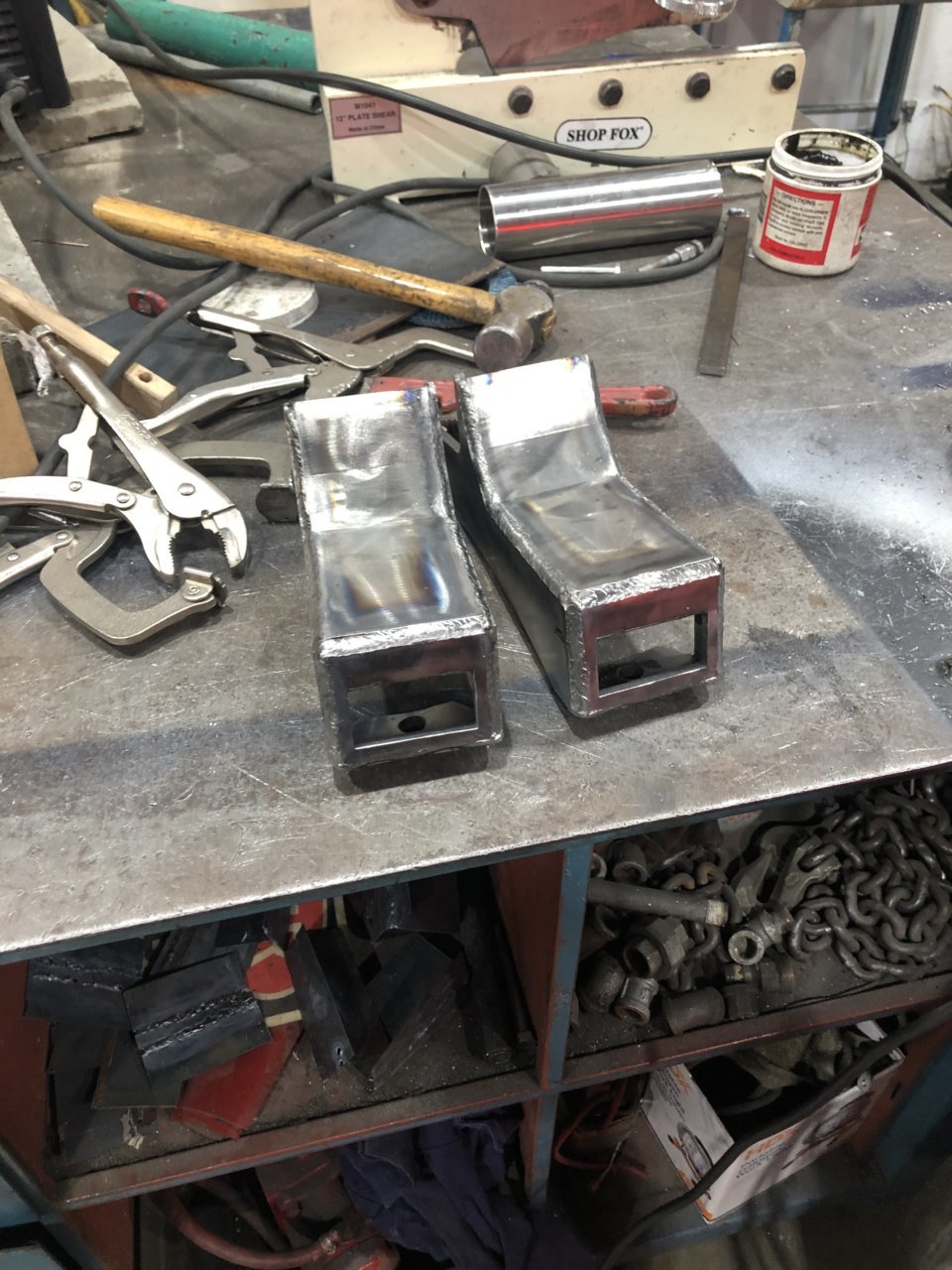

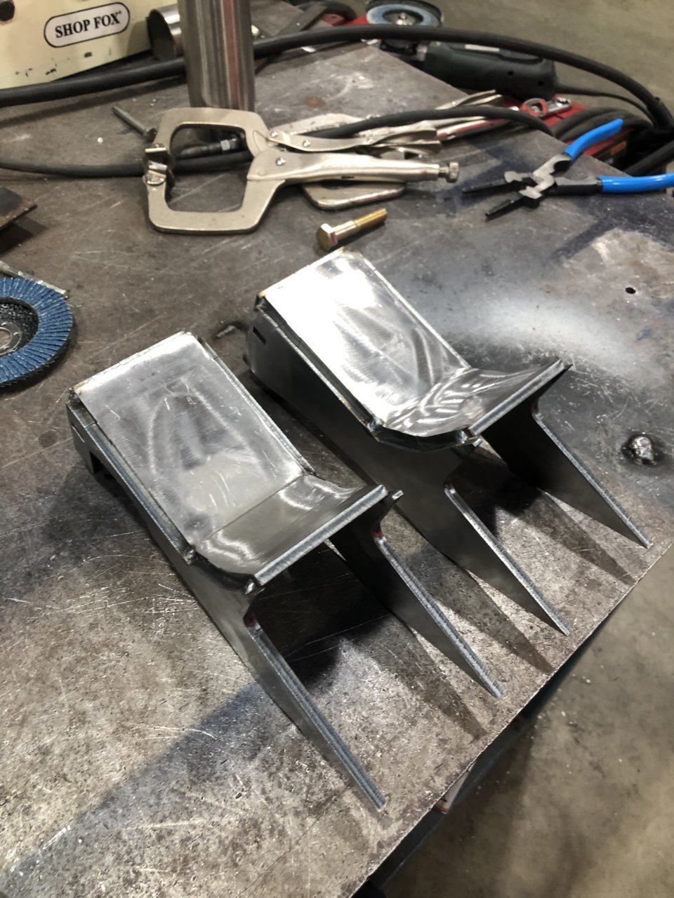

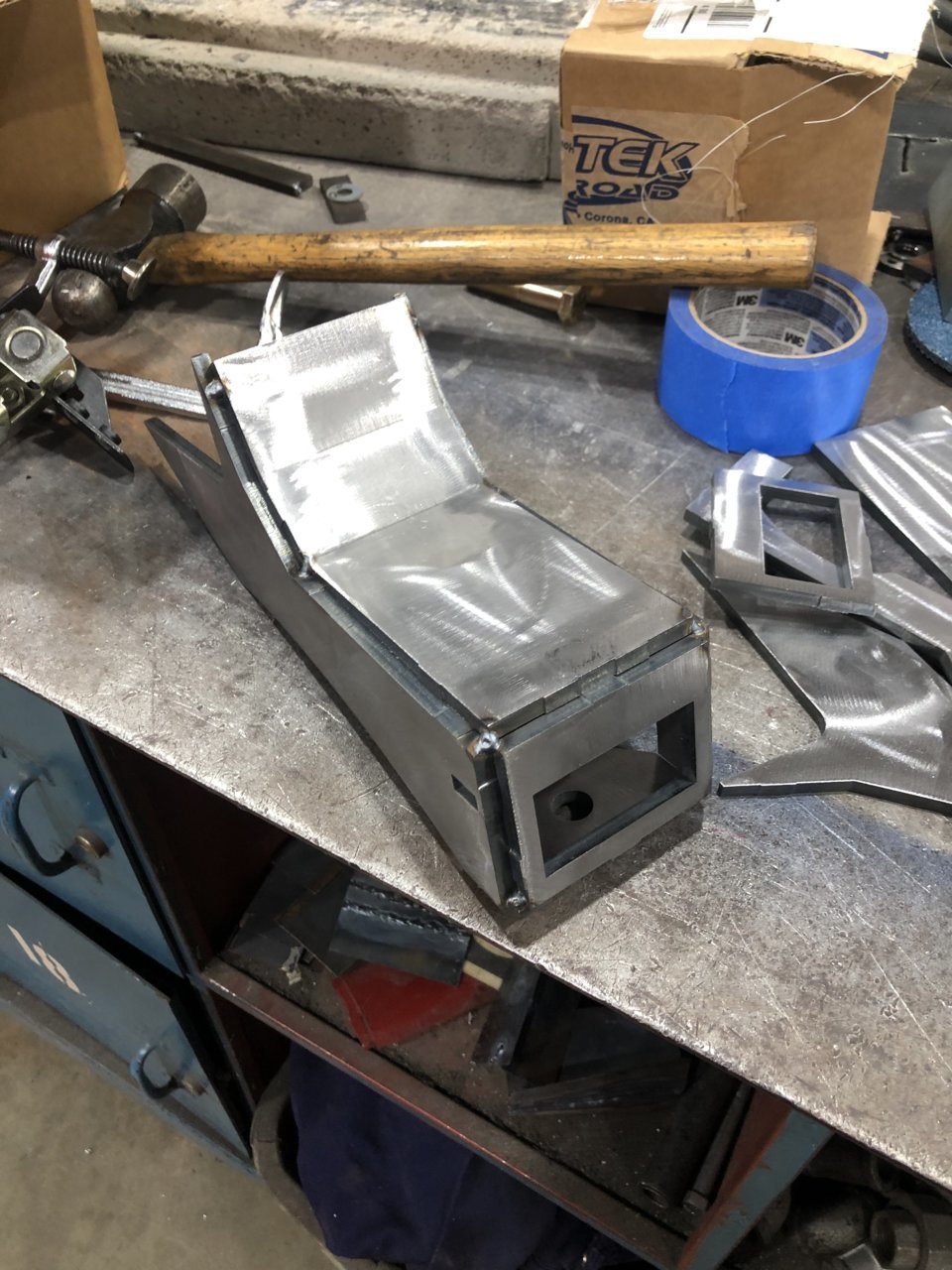

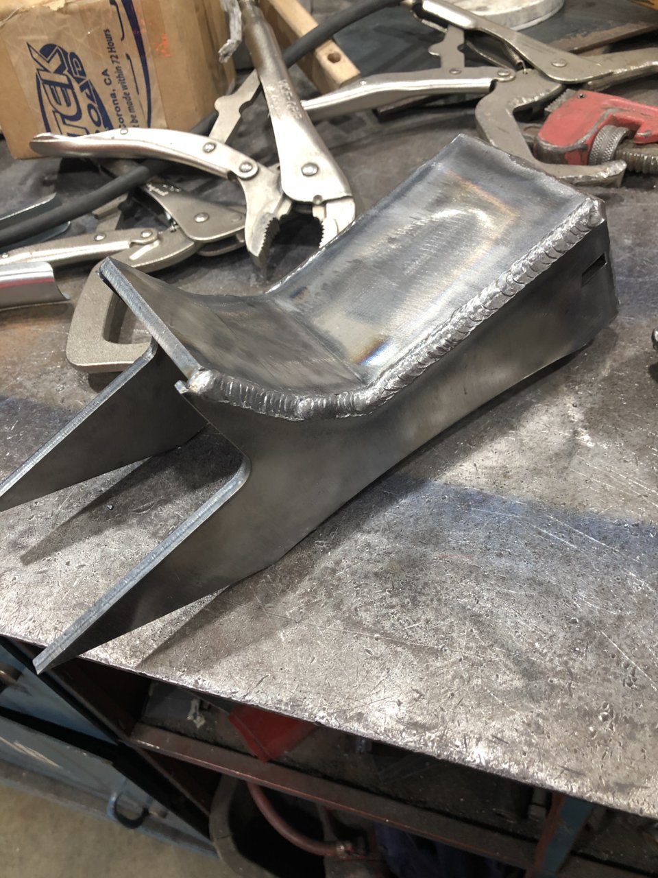

    I welded up some 2nd gen shock relocation brackets are today. 56155875-77BF-4A81-97AE-ED2AD91CC480.jpgF8D1ABB0-3F48-4A1A-8DA2-BDE1341A0451.jpg90E1CFB4-5361-474F-A5AC-57AA58B04DF3.jpgB91A9380-86D9-46B3-8284-25FDB0B1289A.jpg0D8AC79D-3A7B-41F6-9725-EE0AA355E85E.jpg9D3F194F-DD92-4347-B1D5-6BDD0CE8CDBB.jpg506C7C16-B23A-4652-A809-8090B93E4124.jpg

    Are they for your truck? I have the same ones and they work great.
    Pella[QUOTED] likes this.
  9. Apr 10, 2019 at 1:32 PM
    Pella
    Pella Well-Known Member
    Apr 28, 2017
    #217604
    952
    Pella
    209
    SSMDCSBORFTMFW
    Not mine, they belong to @CalTacoma09. @foxrcing07 and I have a wager going, so it looks like I’ll be doing his next.

    You gonna assist in the install? It's a huge PITA but worth it.

    Possibly. I just welded some sliders on the other day for someone else and found out there isn’t a whole lot of room to be welding things to the frame. I’m new to welding so it might be better for him to find someone more experienced to do that part. We are gonna have a look on Saturday though, so it is a possibility that I do it.

    The welding is the easy part, and judging by your welds on the brackets themselves you'd be fine. The shitty part is cutting off all the stock mounts and grinding it all smooth. With one person on each side, it's a days worth of work to do that, weld on the new ones and get everything painted. Also for his resis I recommend the weld on brackets from ruffstuff.
