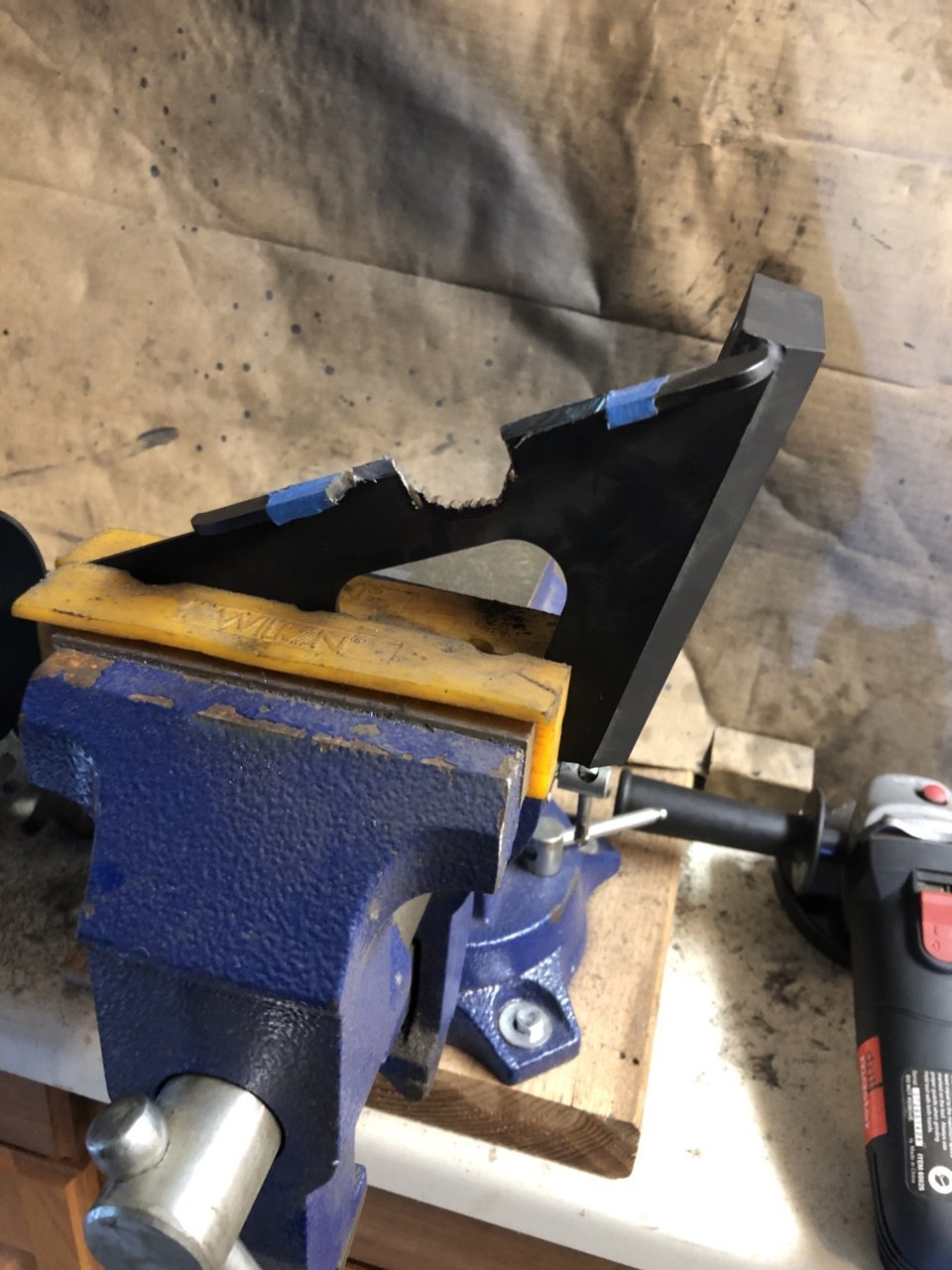

  3. Apr 22, 2019 at 2:57 PM
    EatSleepTacos
    Mar 24, 2015
    #151688
    59,838
    Randy
    West Valley, AZ
    2017 4Runner
    This wasn’t over welded, just a lot of surface area that needed to be welded. I fully welded in all frame plates so it was sealed and water couldn’t get in, causing rust issues.
    Drainbung and m603holden like this.

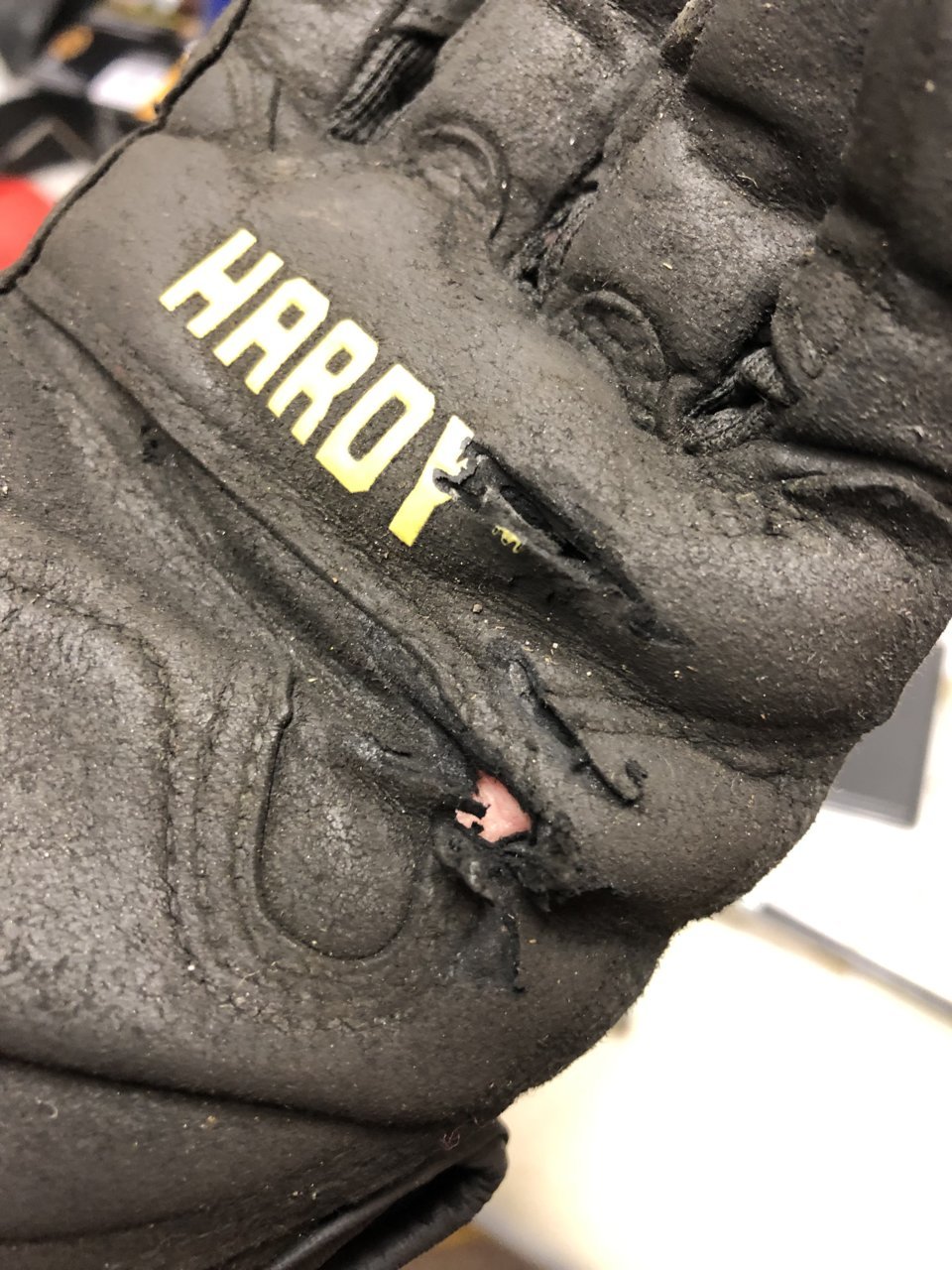

  12. Apr 23, 2019 at 9:20 AM
    SaphiraTaco
    SaphiraTaco Well-Known Member
    Feb 8, 2018
    #243869
    483
    Sean
    Seattle WA
    2013 DCLB TRD Sport
    About halfway done...
    Well had a close call. I need to slow down and buy new gloves:anonymous:
    D2. and whatstcp like this.

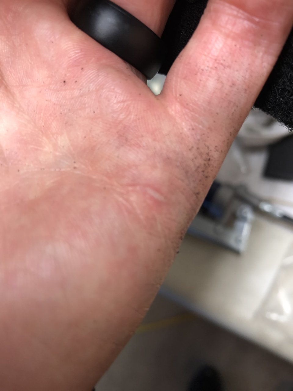

  13. Apr 23, 2019 at 9:36 AM
    EatSleepTacos
    Mar 24, 2015
    #151688
    59,838
    Randy
    West Valley, AZ
    2017 4Runner
    Got myself good a few weeks ago, and I was wearing gloves. Went right on through. It's just about healed up now, finally.

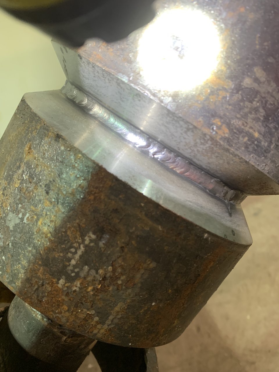

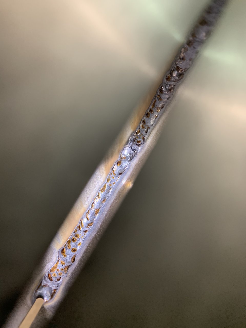

  17. Apr 23, 2019 at 4:42 PM
    weldertaco
    weldertaco Mr.13%bodyfat
    Dec 16, 2014
    #144371
    13,299
    texas
    TrailRunner
    4wd to 2wd conversion
    Tomorrow... we try again.
    With bigger gap to let some reinforcement get in there
    la0d0g and Bigdaddy4760 like this.
  18. Apr 23, 2019 at 4:56 PM
    JPT4x4ac
    JPT4x4ac Well-Known Member
    Oct 6, 2015
    #165945
    144
    Jon
    Broadalbin , NY
    2012 Grn Tacoma AC 2.7 MT
    It’s called a root. It should be about 3/32 inch gap. Remember to grind your starts and stops to get continuous penetration.
  19. Apr 23, 2019 at 5:16 PM
    weldertaco
    Dec 16, 2014
    #144371
    13,299
    texas
    TrailRunner
    3/32 gap? Nah fam. 3/16 tomorrow. This coupon was done with 1/8 gap. Didnt like how tight it was after i was halfway into it.
  20. Apr 24, 2019 at 1:48 AM
    JPT4x4ac
    Oct 6, 2015
    #165945
    144
    Jon
    Broadalbin , NY
    What size rod are you burning? Typically with 1/8th inch 6010 5p+ a 3/32 gap is good. Try turning the heat up a little and push in as you climb.
