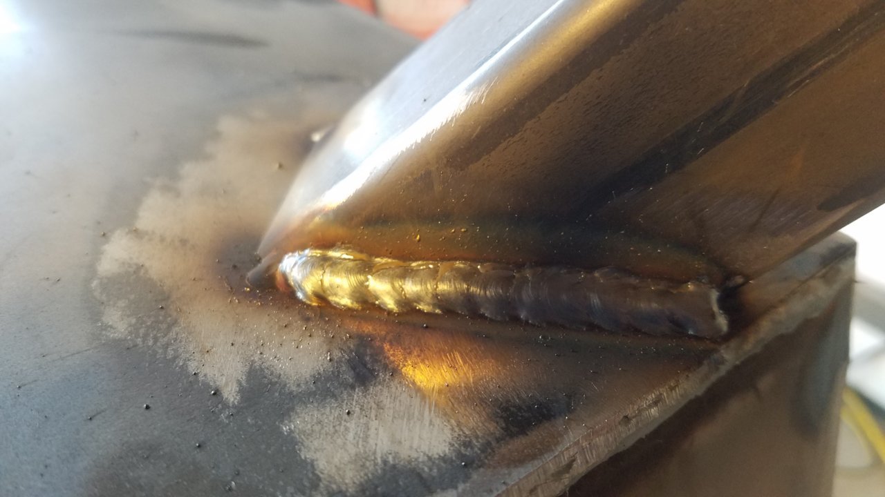

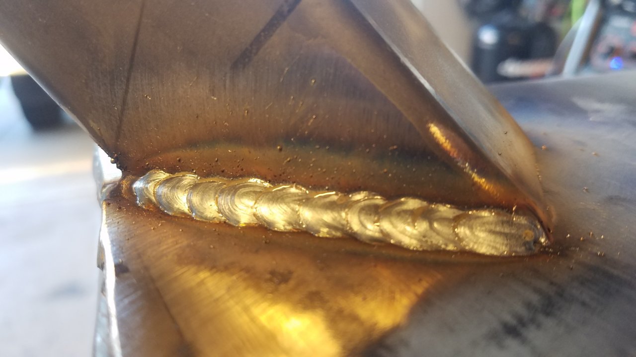

    So the other day I decided I didn’t want a swingout anymore and cut it off. Decided to repurpose it to build an in bed tire holder that’ll bolt through the bed with 1/2” hardware.
    While at joes today I bribed him into cutting out my base plate for me on my chunk of 1/4” I brought. What would have taken me forever with an angle grinder and drill. Took less than ten minutes to design and cut on the table.
    https://youtu.be/j4JOE9HTUjg
    Then repurposed my swingout and built the tire holder. This thing is SO BEEFY. That tire isn’t going anywhere.

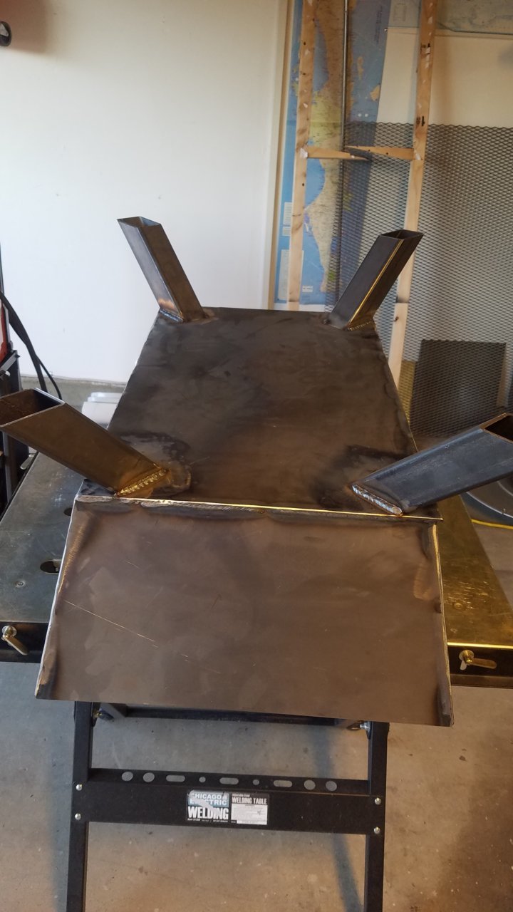

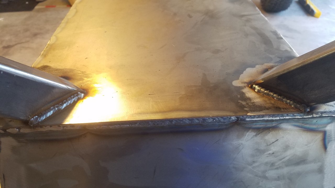

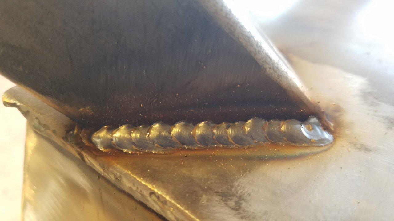

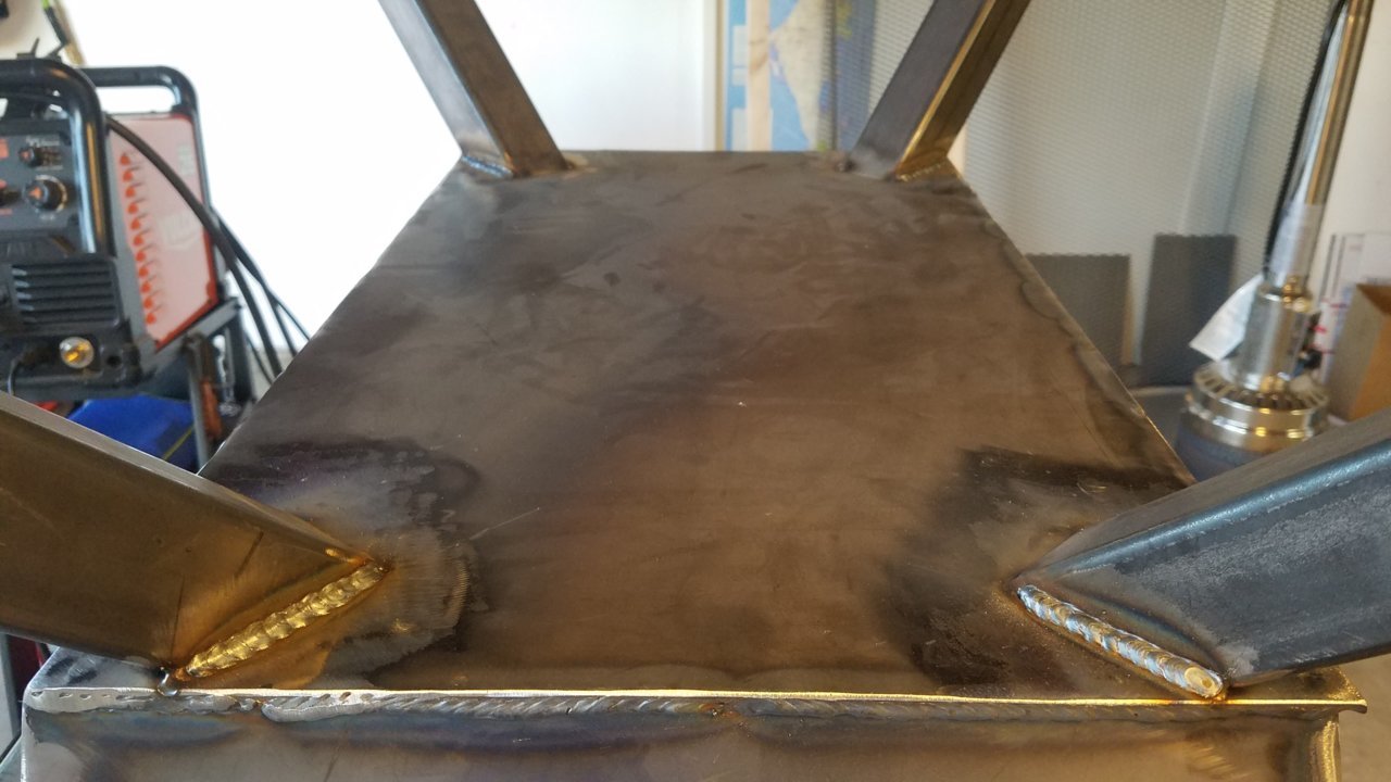

    Made some progress today

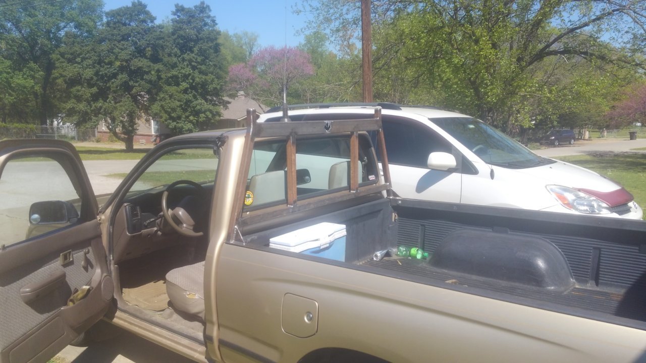

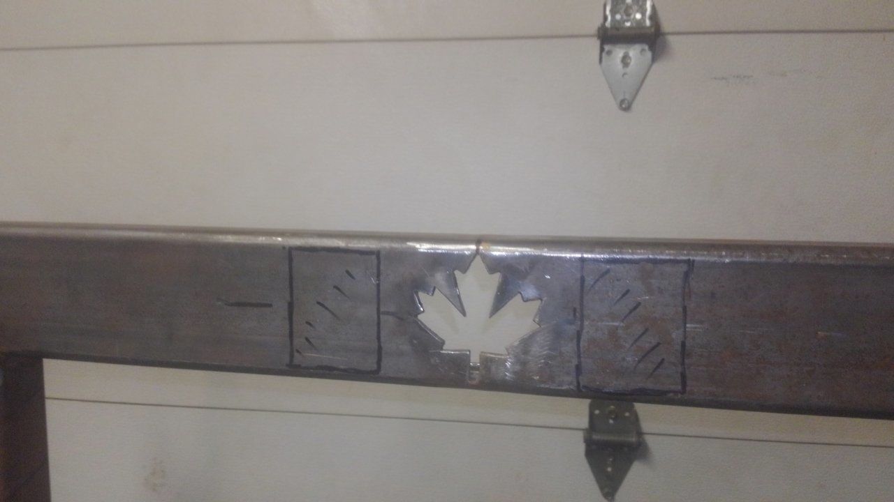

    Headache rack is almost done. Probably gonna install some louvers....likely all the way across. Anyone have tips on what spacing generally looks good and provides good visibility and protection?
    Got some Harbor Freight tie downs...cut the bolt tabs off and welded on.

    Got back in the game quick! :D:welder:

    nice flag!
    please tell me you did not free hand that with a plasma....

    Funny, I thought the same.

    Haha, no I traced it out and used a Dremel with small cut off wheels. But theres an old fella I know who can cut anything with the plasma...if you can draw it he can cut it.

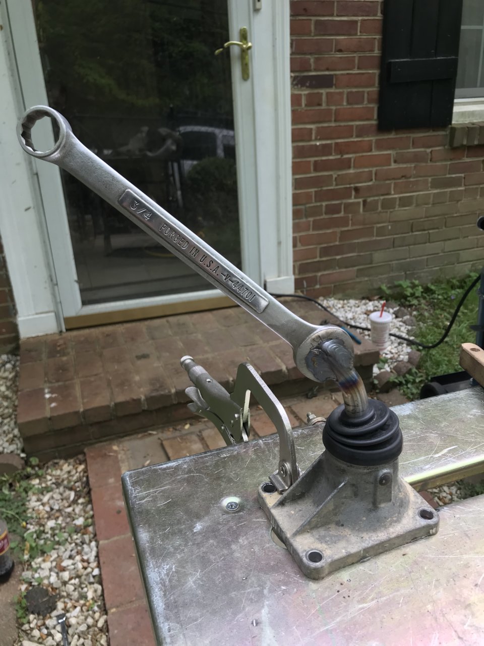

    2nd gen shifters have an internal bushing to minimize in cab noise and vibrations. Over time it gets all shitty and sloppy. This is my solution. Gonna try shifting as is and if I hate it, I’ll add my shift knob on.
