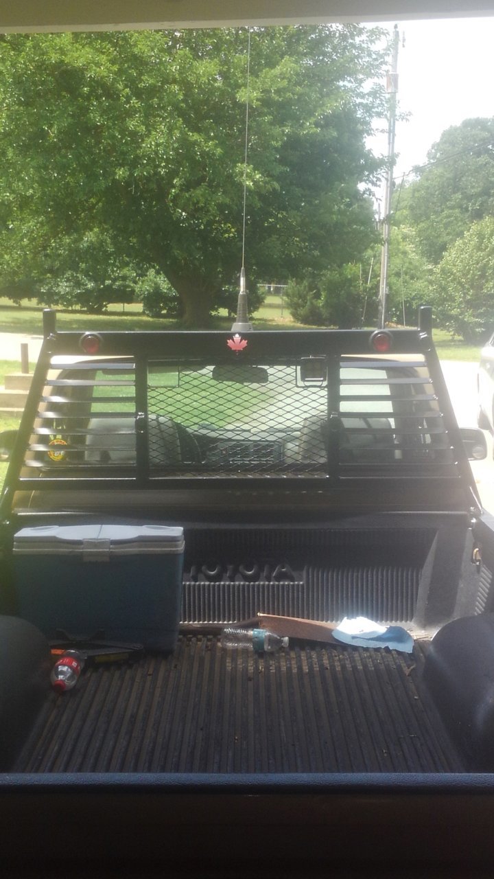

    Got my headache rack all finished and painted! Brake lights installed and wired, backup light wiring in too. Just need to tie into the truck. ​

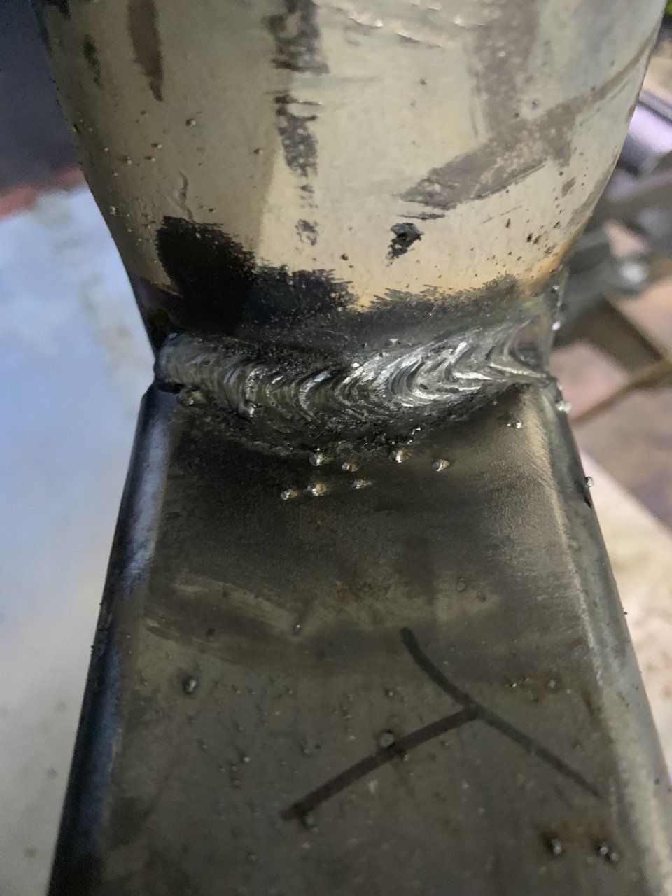

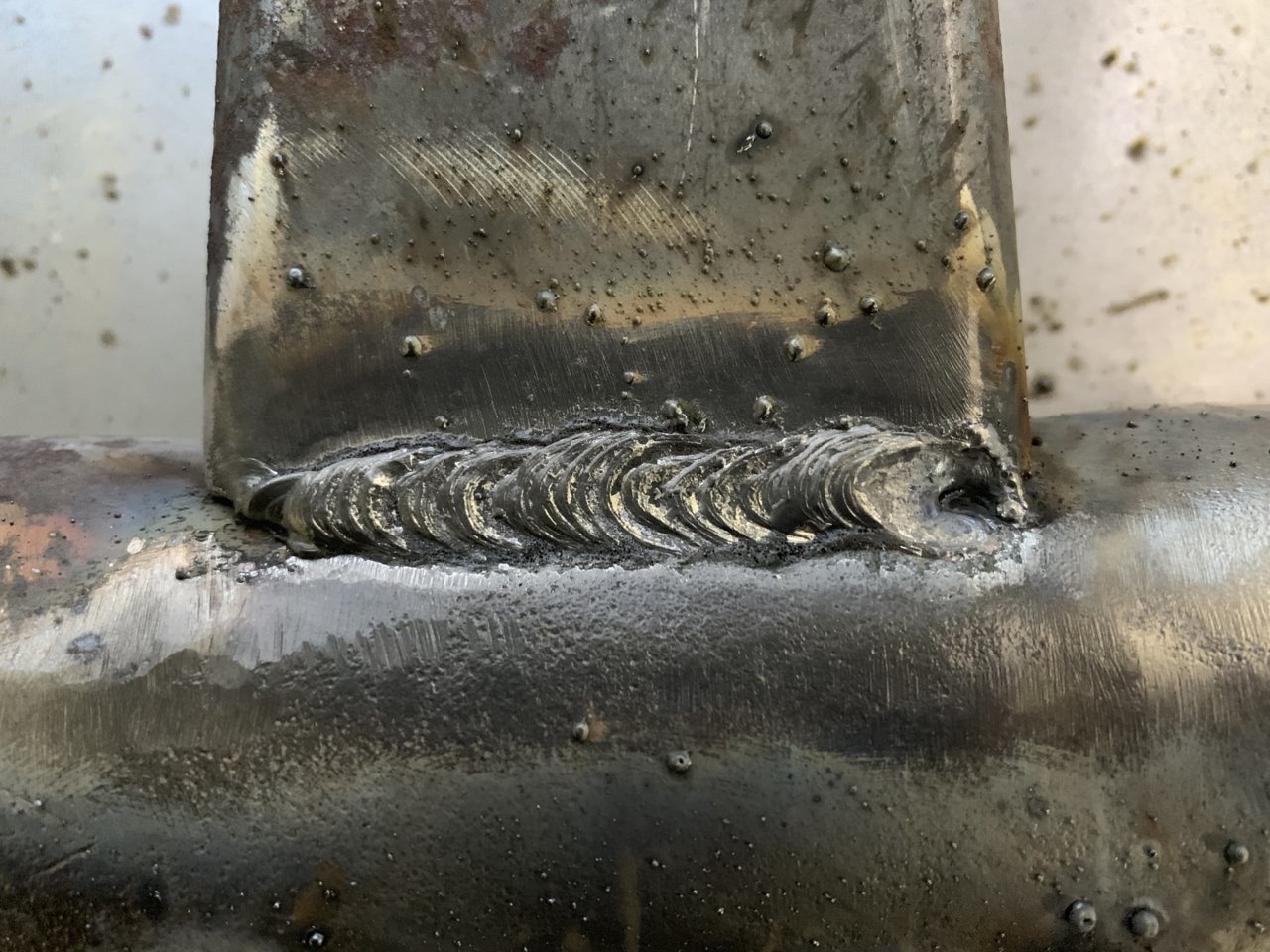

    Got a ton of practice in tonight finishing my press tool.
    Bottom is 6011 whip and pause, top is 6011 circles.
    Everything after is circles:
    Then went over the long edges with 6013 just to practice.
    Final product is a tool to press out axle bearings.

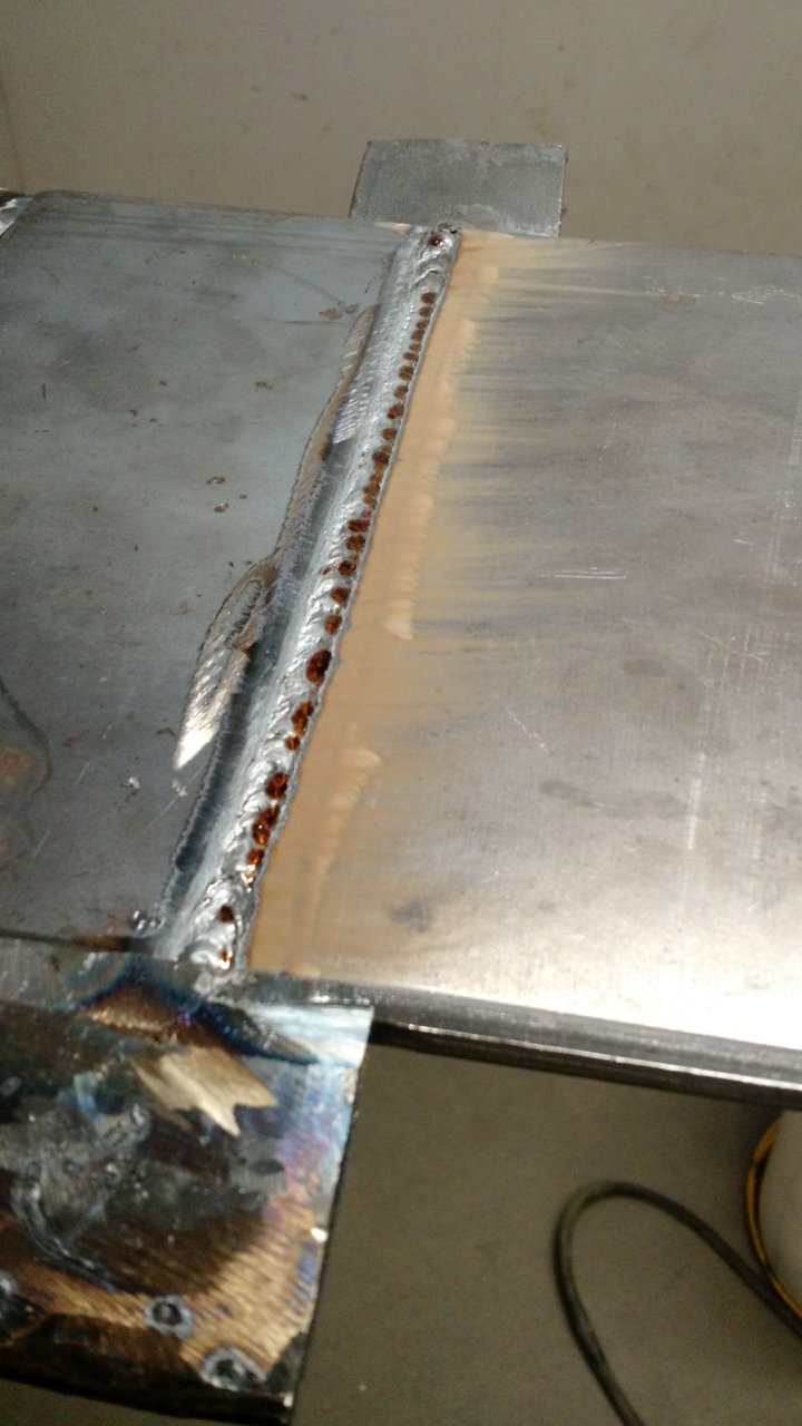

    Been there, done that, never again. Gtaw root passes are responsible for me having depression/anxiety for an entire semester lol. Mess up, and you still got the entire coupon to weld out fully knowing that its worthless. Got so frustrated with it that I changed majors and havent looked back. Passed the class though (plate, didnt do any pipe). Glad I did it, but its not for me. The few good ones I ran sure did make me feel proud though! IMG_20170404_205347619.jpg

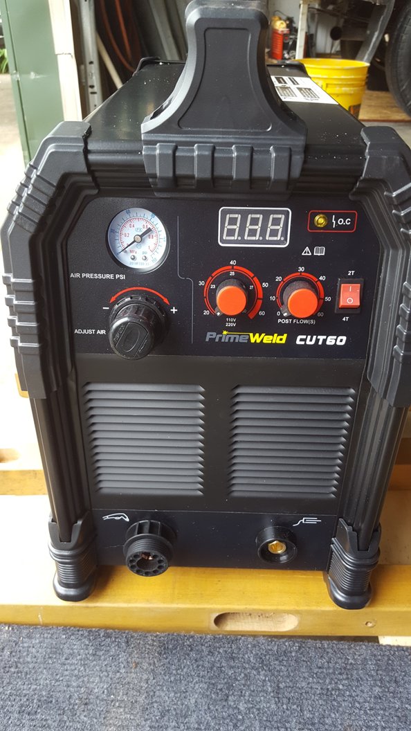

    A little over a week ago, I was on here saying I might buy the Primeweld 60amp plasma cutter for $649. I did.
    So far, my impression is very good. Arrived very well packaged and undamaged (Fedex), all features as advertised, and working well on the day one cuts I've made.
    I only had the small Hobart 250 before, so I may be easy to impress, but man this thing cuts strong and fast. I made a 24"x 13" cut of 1/4" stainless sheet at 35amps and it I'd estimate I was moving and 1"/sec. Edge was a bit rough, but I think I had the air pressure a bit too high. Cut some tubing, removed some old weld joints from angle iron, etc just playing, and I am liking it.
    A few observations:
    I called Primeweld before purchasing to discuss warranty: 3yr, shipping included; 100% coverage
    Repl parts can be purchased direct from the US based outlet in NJ. 24/7 calls answered
    For you CNC guys, it has an adapter, (see blue plug in 2nd photo), pinout in manual, and has a continuous cut on/off switch on front of machine
    electrode/grnd cords generously long
    LED is a bit hard to read in bright sunlight (minor inconvenience)
    On/Off switch is on the rear of the machine...why?
    No Contact arc works very well
    auto shutoff if pressure drops below about 30psi
    continues cool down cycle until complete even after switched off
    I like the trigger guard. East to use even with welding gloves on. I am always accidentally bumping the one on my MIG gun
    Anyway, if any negatives arise after I get some more usage time in, I will update. Otherwise, to me, this seems like a good purchase if you want a machine in this size/price range that has the Euro style connector, non contact pilot, and a solid warranty.
    I guess I'd call this an "upper end Chinese machine".
    Long cables, CNC plug, decent quality ground has about 3/8' thick copper pads in the jaws

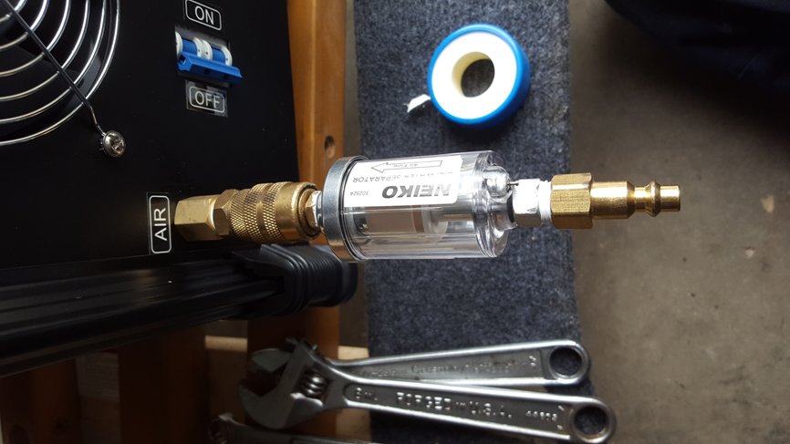

    I have a trap at my compressor, but a little extra insurance...

    @weldertaco and any other stick guys out there, are these a good start? Honestly am looking for any advice. First time working with thicker stuff and I want to make sure penetration looks good.
    Running Board Man likes this.
  20. May 20, 2019 at 12:01 PM
    la0d0g
    Jan 25, 2011
    #49903
    19,887
    running for the hills
    For crawling not hauling
    Cut your welds in half and you'll find out :D
